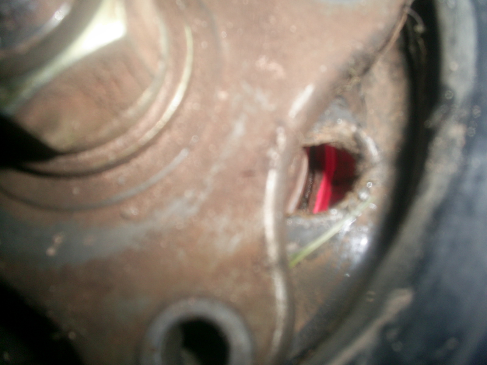

I was mowing with the BX and noticed an odd noise coming from the deck. It was coming from the right side, near the side discharge chute. Sounded like metal clanking about.
I took the plastic guard off the top of the deck and noticed alot of dirt. I thought maybe the dirt was restricting the deck sheave/pulley from turning freely. After hosing the area clean, I noticed a 1" 5/16" bolt laying on top of the deck and upon closer inspection, I noticed this.

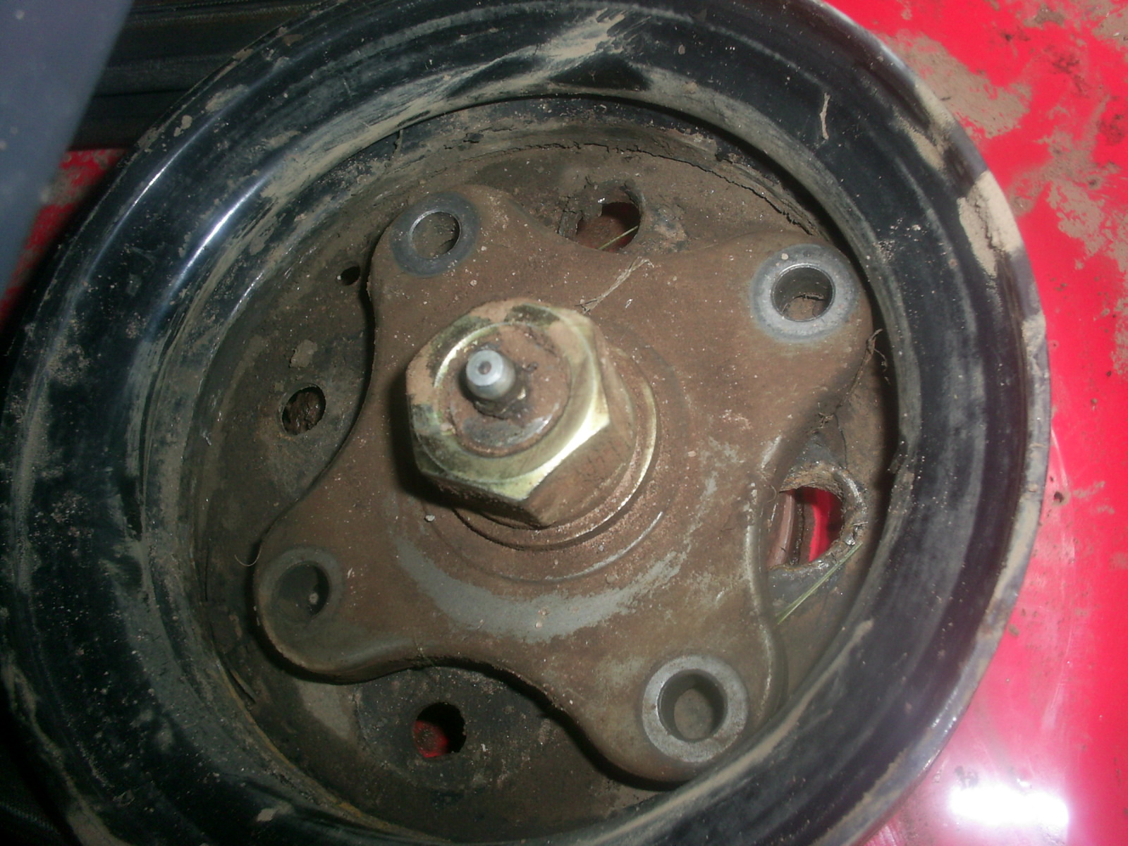

Upon further inspection, I looked at the other side. 2 of 4 bolts were loose and the right side was missing all 4 bolts. The bolts are actually 8mmx1.25threadx25mm in length. I picked up some replacement bolts and gave the deck a good cleaning and greasing. Fired it up and it mowed flawlessly.
Two Question
1.Are these bolts shear type bolts that should be changed to original specs?
2. Looking at the second picture, it looks like the bolts were in there loose for a while and deformed the metal. DO you think it(pulley) needs to be replaced?

In regards to question 1. above: no, those are not designed as sheer bolts. The sheer bolt for the MMM is built into the mid pto driveshaft. The belt could also slip if the blades hit something solid. Therefore heavy grade 8 bolts and lockwasher + locktight is appropriate. I prefer locktight over locknuts because they are easier to assemble, and locktight is not affected by frictional heat. Just my personal preference.

If you have that much vibration, I would wonder if you have either a bent blade or one (or more?) badly out of balance. There is an expected amount and an excessive amount of vibration on a mower deck. The results of some of the posts suggests vibration on the unacceptable side, most often caused by one of the above, with a more rare possibility of a bent spindle shaft.

I had problem with the bolts right pulley on my bx, last summer. Dealer replaced the pulley because the holes were elongated. After that always check the bolts before installing the deck

I was the OP, so let me give you an update.
I was able to get a schematic and tallied up my order.
$250:eek:
I had the pulleys on both sides and on one side I needed a complete rebuild from the main housing on down including all the bearings and spacers.
Easy rebuild, tough purchase.
I noticed the problem, soon after ordering my BX in 2007. It wasn't my
main mower then. When it became my main mower, it got progressively worse, then poof.
I rebuilt it earlier this year and it has performed flawlessly since.
My original post of 7/09 included pix with elongated holes. The bearings didn't go until this spring. I kept replacing and tightening bolts until it went. Probably have 30 hours since the rebuild, no problems
