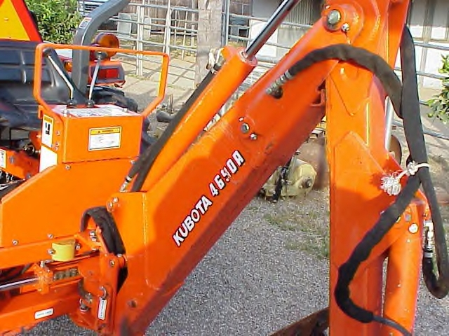

All 4 of the bends have been straight in-line and down as shown in initial post.
If you want to restrict the extend of your dipper cylinder, you can weld
on or add to the stop pad on your boom/dipper, instead of putting stop
collars inside your cylinder. Not all hoes have these pads, but the 4690A
has one (photo), and they are common on FEL booms. You can experiment
with bolted on steel plates until you get the stroke the way you want it.
I collect data on hoe attachments, and it is interesting how the different
designers approach the dipper digging force issue. The length of the
dipper moment arm varies widely for the 7.5' class of hoe, from a tiny
8.5" for the JD 448, to a huge 13.5" for the BushHog BH750. A longer
arm gives you higher dipper dig forces at the cost of having a longer
cylinder stroke.
I do not know the dipper moment arm length for the 4690....do you want
to measure it and post? It is the spacing of the upper cyl pivot to the dipper
pivot.
pivot.
I forgot you posted a photo.
It looks like your arm is about 13", if your pins are 1". I would add to your
stop pads to limit the cyl stroke.
