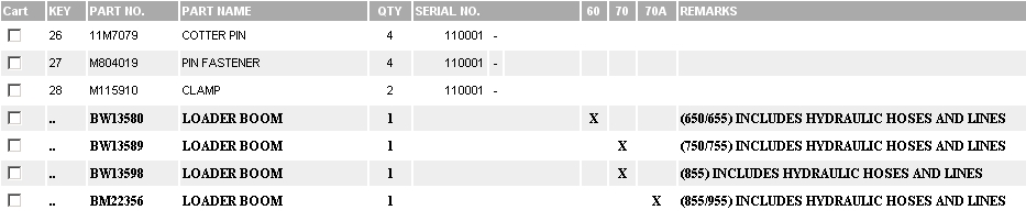

You have me curious about your loader. The manuals and JD Parts all show the 70A is not for the 755. It is possible the wrong decals could be on yours. JD in their own advertising doesn't always pull everything together correctly. The attachment shows what is clearly a 70A (on an 855) with 70 decals. Are your masts vertical, or kinked? The s/n plate on my 70 loader (with black bucket) includes 70A in the sequence, but does not mean it is a 70A. The s/n plate on my tractor shows 755D, but of course that only indicates 4WD and SCV, not a model change designation. Again just curious about this mostly trivia, although it could become important if ordering parts.

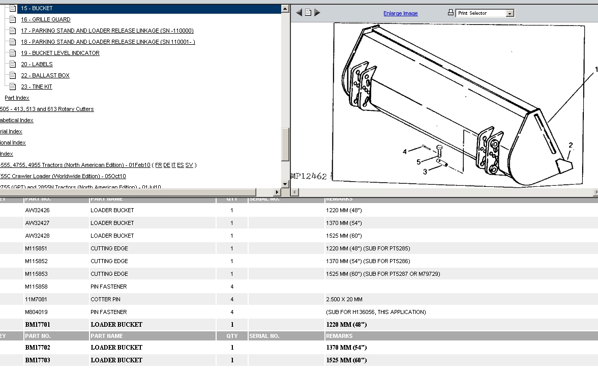

Note on square, round, green, black, or anything else buckets. JD Parts still shows exactly the same information as my 1992 parts catalog. Meaning only three part numbers for buckets: 48, 54, and 60 inch. The drawing shows the rounded style, and no designation is given as to color. One number of course matches my black square bucket. I expect alll the combinations met JD specs and you just got what JD got from its vendors. In the industry that's called meeting form, fit, and function.

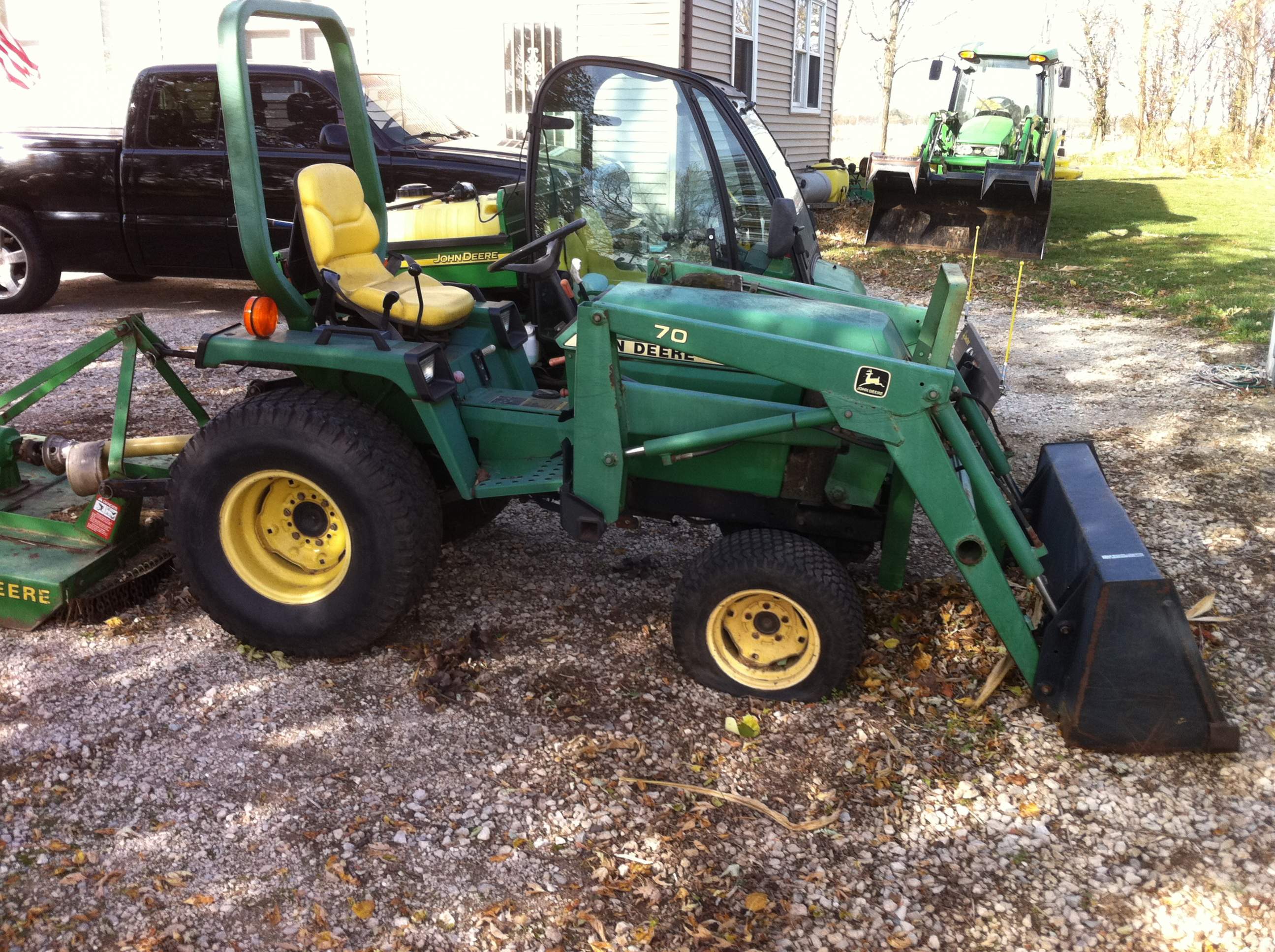

The change to the black squarish bucket did about line up with the introduction of the 70A loader,but I wouldn't say that was the reason. Originally two versions of the 70 loader were sold. One to fit the 755 and one to fit the 855. Same loader, the 855 version just had a longer horizontal frame to fit the tractor. Later the 855 version was changed to instead "kink" the masts forward. They called that the 70A, while the 755 (and 770) retained the 70. Since buckets were sold separately from the loader, some 70A got black and some got green.
Thanks for pointing that out, I had assumed incorrectly that the round/squarish bucket came about because of the 70/70A change....but that shows you what assuming will do!
Is my loader an oddball then.....70 loader with kinked masts?
   / Black bucket or JD green? #29
Thanks for the picture. It's entirely possible as they made the transition to the new style masts that they produced some with the 70 decals. The early ad in my previous post was the same way. Always more for me to learn, and still more trivia for the historians to figure out. Is your loader serial number above or below 110001?
   / Black bucket or JD green? #30
Serial no. is 111xxx
