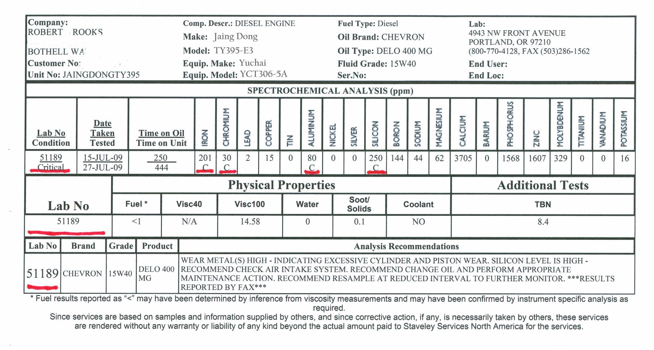

View attachment 720949My oil comes out so clean my wife wants to add vinegar to it and use as salad dressing!😂☮️✌🏻
I think that's an excellent idea. Kudos to your wife. Just think of all the new minerals that will be added to your diet. So if it has a little diesel fuel or anti freeze bite to it, you'll know right away. Or maybe it will have a slight aluminum flavor.
