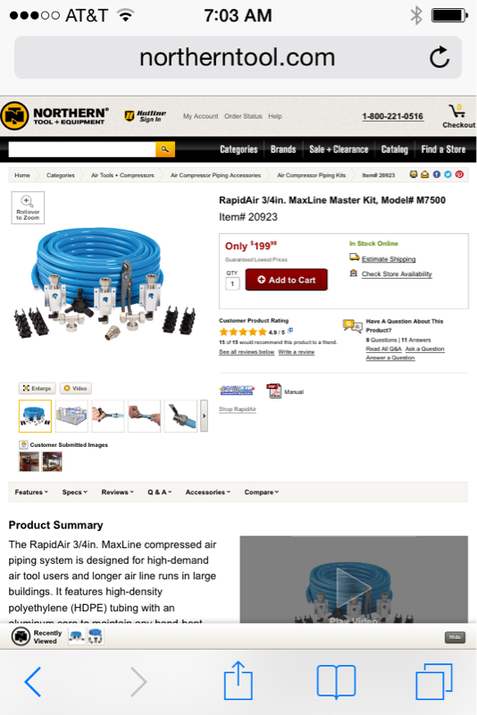

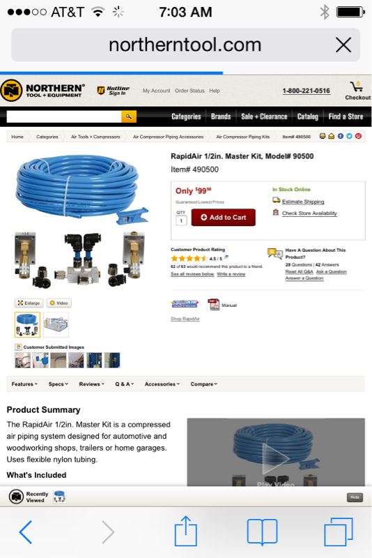

Has anybody looked at these set ups?
   / Black pipe or galvanized for shop air lines? #148
Sorry first photo didn't load.
