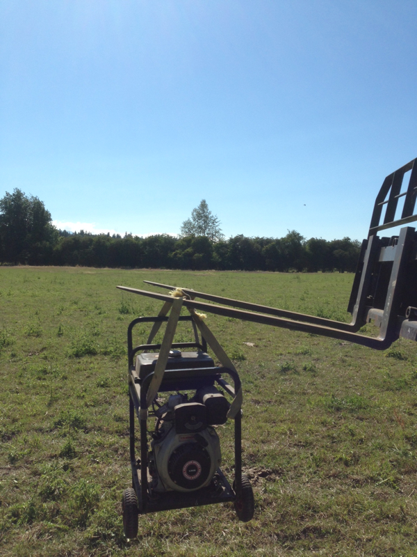

Right, I do the same, here is my 6 HP diesel generator I haul from place to place to use power tools where I have no power. I hope this method of hauling is OSHA approved since I tied square knots in the strap. Sometimes I haul an air compressor too if I need air tools and power the compressor from the gen.

I do the same for hauling .I used a pair of vice grips to keep a chain from sliding on the forks. Im surprised there isnt a clamp already thought of that would quick clamp to the forks .Im thinking maybe ill take some chain and wrap it around and then weld up some type of clamp for it. I have seen where some forks have the hole cut in them for a ball hitch..hmmmQUOTE=TomSeller;3854941]Right, I do the same, here is my 6 HP diesel generator I haul from place to place to use power tools where I have no power. I hope this method of hauling is OSHA approved since I tied square knots in the strap. Sometimes I haul an air compressor too if I need air tools and power the compressor from the gen.[/QUOTE]
