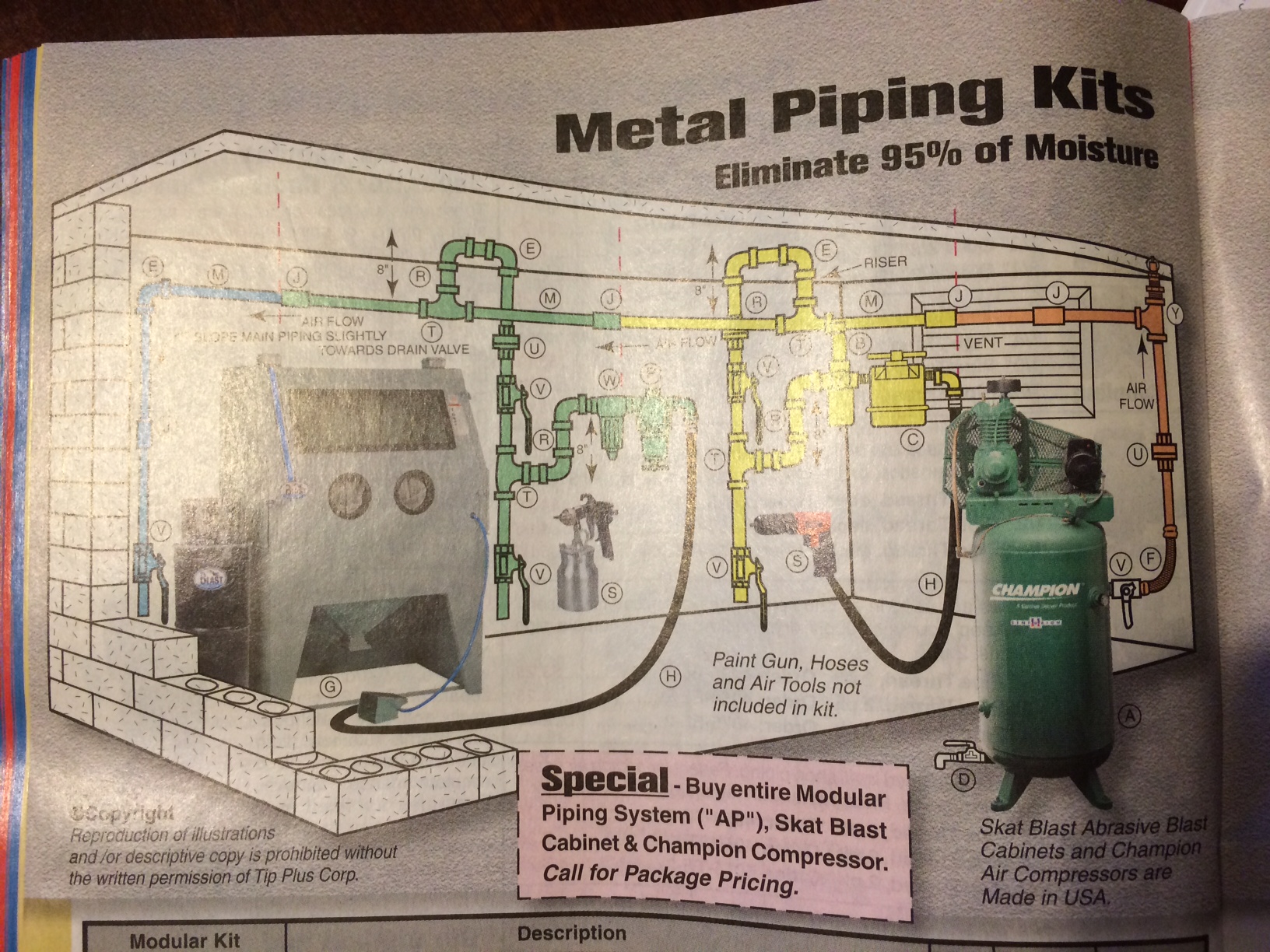

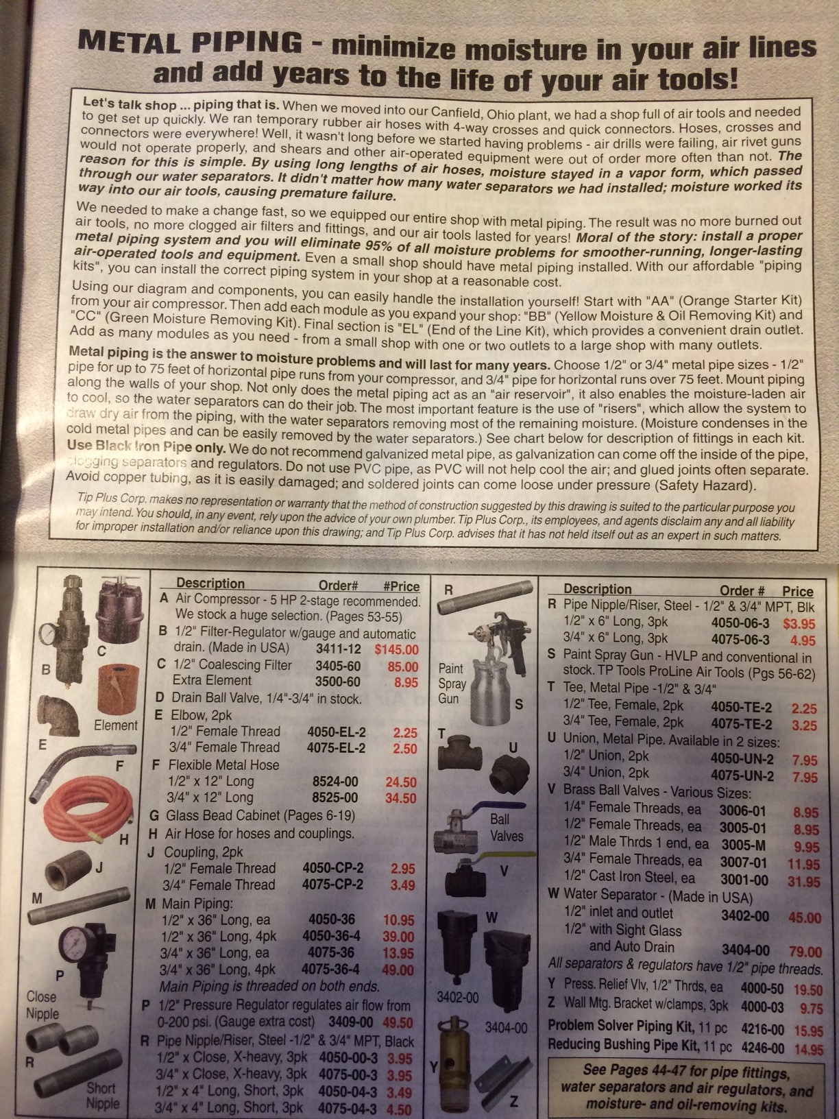

I am looking at this very system. It's relatively pricey, but cheaper than copper (you can get a 100' run of the piping in 3/4" with fittings for three drops for $185 (Maxline M7500 Master Kit, 3/4-Inch x 100-Feet - Air Compressor Accessories - Amazon.com), which seems to be about what you'd pay for just 90' of 3/4" type L copper without fittings. The integrated aluminum should satisfy the bursting concerns, it's direct-bury approved (not that I'd do that, but it's good to know that it can handle it), and seemingly pretty simple to work with. There's a 1/2" diameter kit available as well that runs $166 (Maxline M3800 Master Kit, 1/2-Inch x 100-Feet - Air Compressor Accessories - Amazon.com) , but for the $19, I'd gladly go for the 3/4" kit.
We'll see when the kit shows up, but I am thinking I wouldn't even need the short section of hydraulic hose to my ceiling drops (though that is a way sweet idea) - I could just directly connect to the female 1/2" NPT fitting with a 3/4" line to 1/2" NPT adapter on the reel and go.
The big thing, it would seem, would be to plumb in water catch drains, slope horizontal runs just like what you would do in a black pipe install, and install water separators at every drop, as in the attached from the current tptools.com catalog. Also attached is their description of why you want to use black pipe (they sell the RapidAir kit as well, ironically on the preceding page of the catalog), but the more I read here, the more I am convinced that giving the compressed air (which is going to contain at least *some* moisture regardless of how hard you try) a place to interact with iron to form rust is to be avoided.
Around here, type L 3/4" copper pipe is essentially $2/lf. Type M runs $1.35/lf.
In both copper cases, by the time you add fittings, you'll be at a higher cost with more work.
With black pipe you've got rust concerns, even though it's cheaper.
With PVC, you've got bursting concerns.
With PEX, you *potentially* have bursting concerns, though I think you'd be just fine with the way more forgiving type A PEX such as what Wirsbo and others have.
That's my $0.02, derived largely from reading through eight pages of this thread! :D
