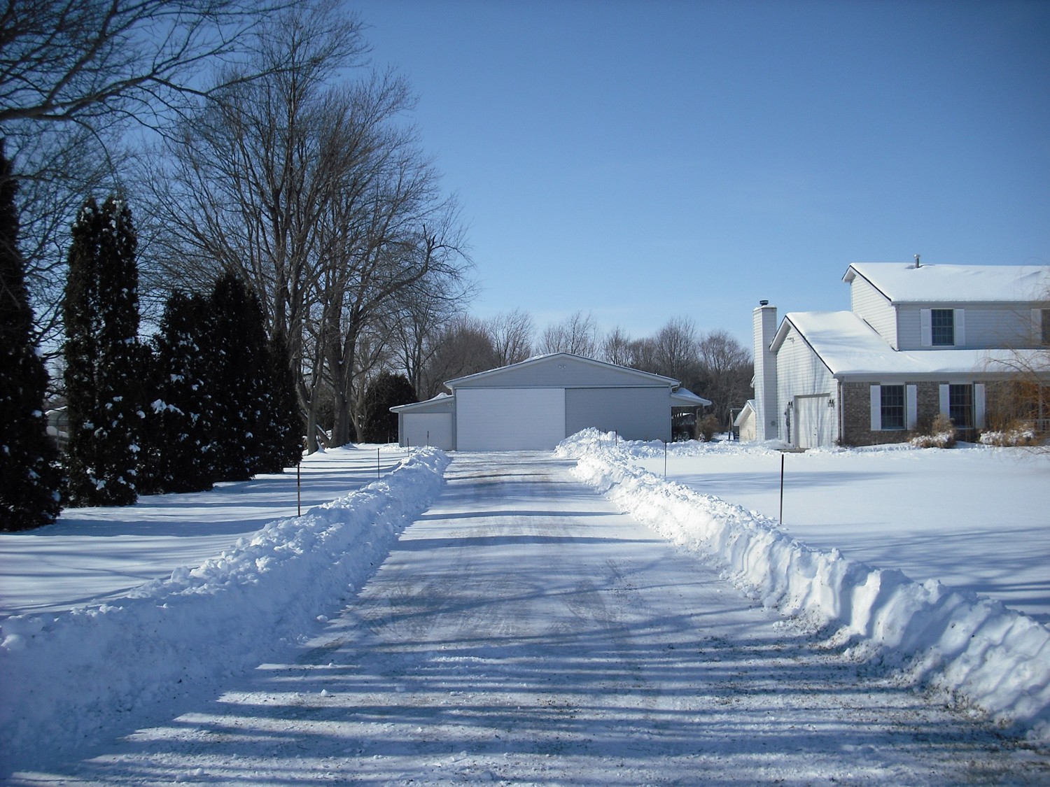

That is way out of line. My drive is 40' wide then tapers to 25' and about 200' long for a total area of 4,600 SQ FT. I had it paved in 2010 with 2" of heavy binder and 1" of #12 top coat for $7500 cash. It was gravel to start with and they did 3 days of work. 1.5 days of prep and 1.5 days to pave.
Second pic is when it was gravel but gives you a idea of the size.
Chris
