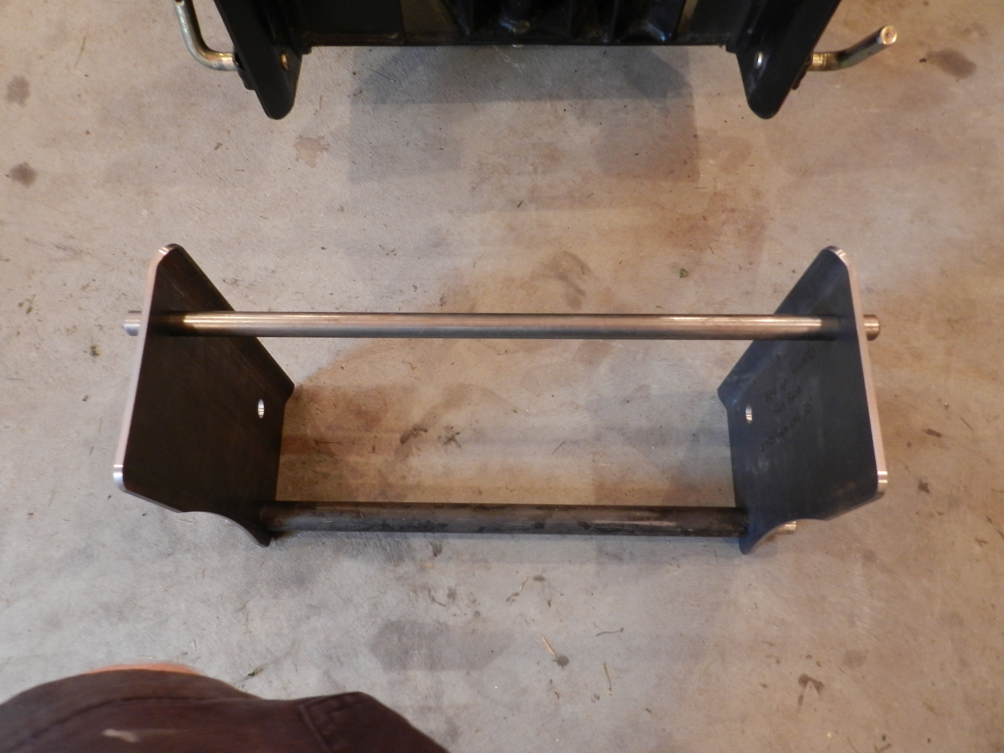

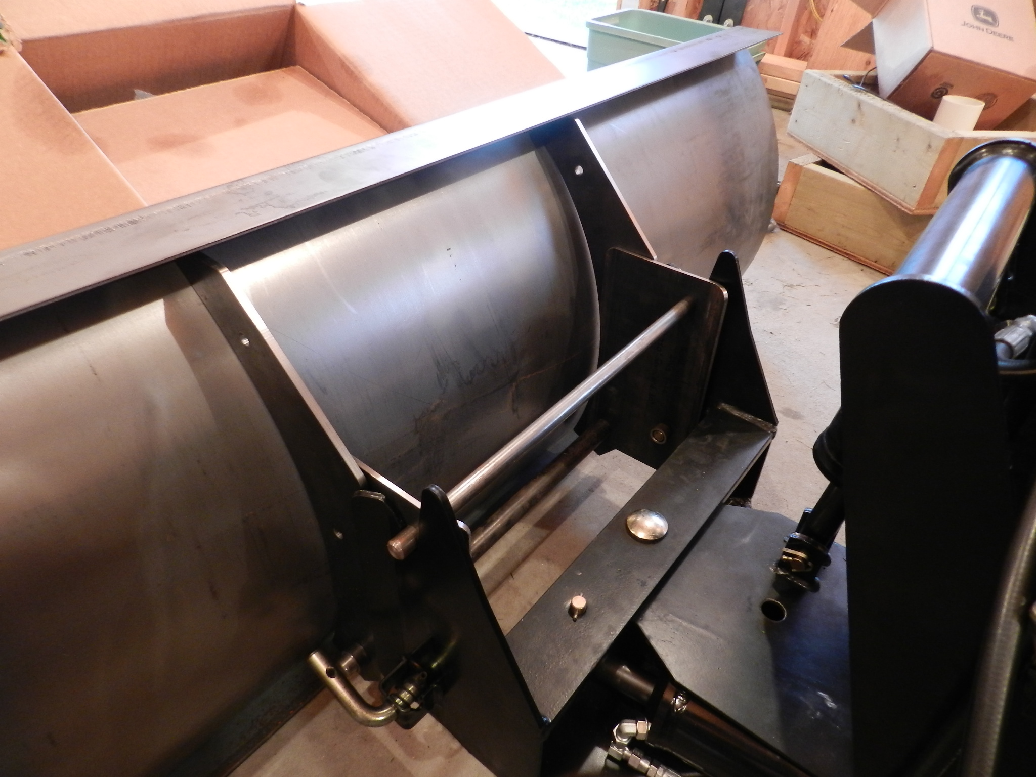

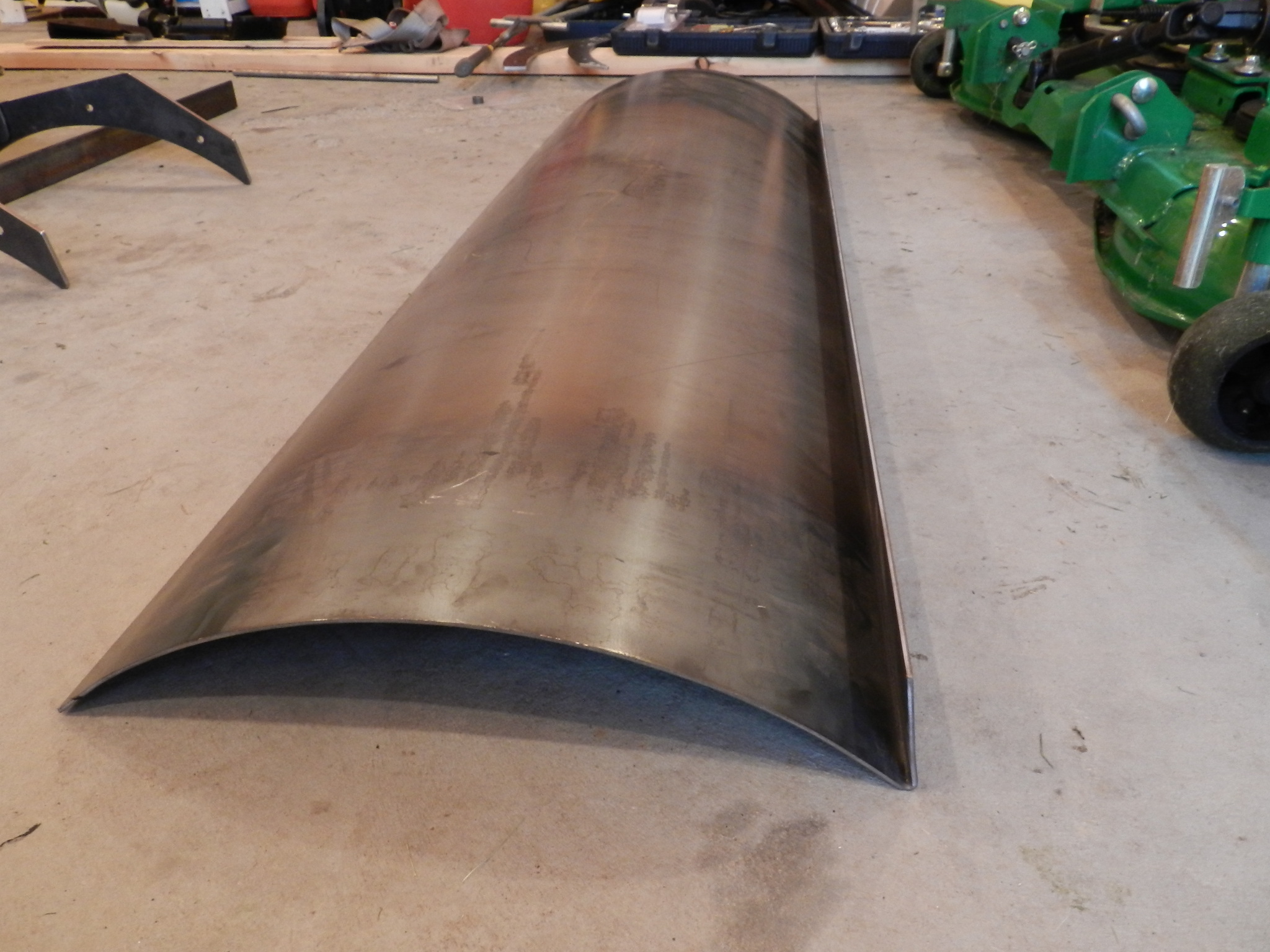

Hey, Sorry its taken so long for me to get back to you guys. My daughter is taken up a lot of my time but I manage to squeeze in a little work every now and then. Good news ITS DONE.
Here are some pics. DSCN2520.JPGDSCN2519.JPGDSCN2521.JPGDSCN2522.JPGDSCN2523.JPGDSCN2524.JPG

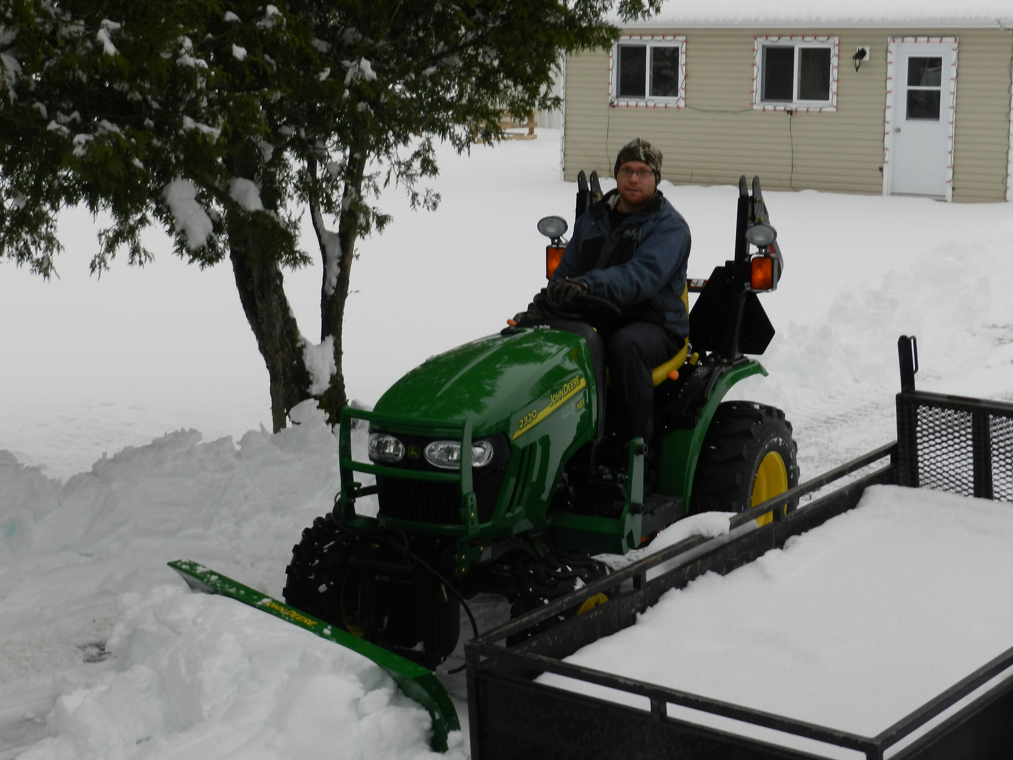

#77

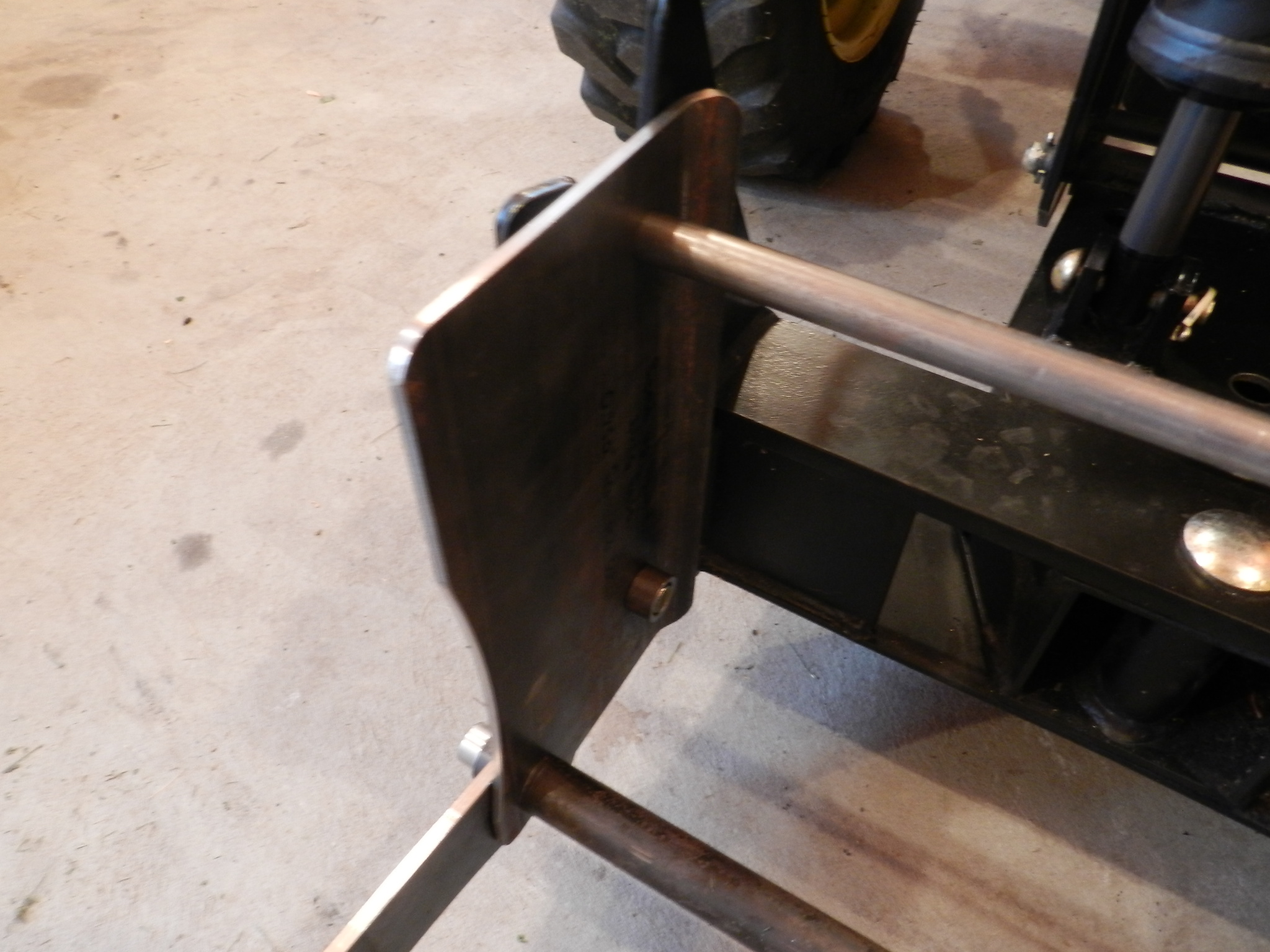

Here are a few pics of the blade mounted.
You can see in the second picture how much it clears the wheel width. When blade is angled it is just wider then the wheels so I never drive over the snow.

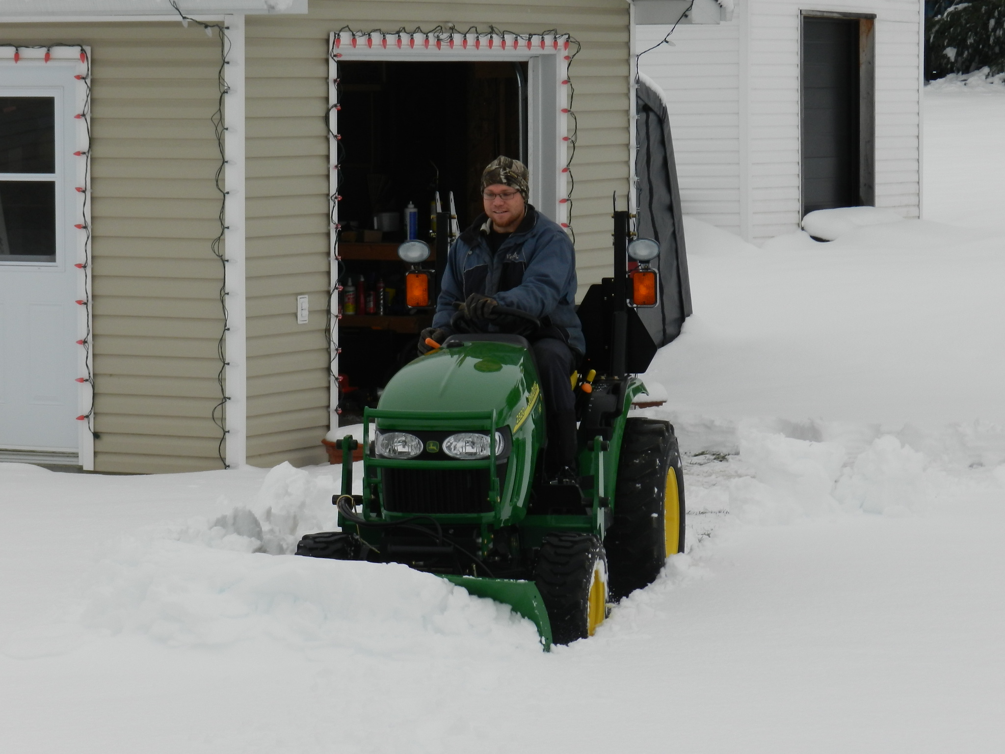

#78
We got around 9 inches of snow last night, and it is really heavy, sticky and wet so it will be a good first test for the blade. Here are a few pictures of it in action.
/ Blade for Front Quick Hitch #79
We got around 9 inches of snow last night, and it is really heavy, sticky and wet so it will be a good first test for the blade. Here are a few pictures of it in action. <img src="http://www.tractorbynet.com/forums/attachment.php?attachmentid=347802"/><img src="http://www.tractorbynet.com/forums/attachment.php?attachmentid=347803"/><img src="http://www.tractorbynet.com/forums/attachment.php?attachmentid=347804"/><img src="http://www.tractorbynet.com/forums/attachment.php?attachmentid=347805"/>
Looks good!
Could you have gone wider? Looks like it is just clearing the width of the tires when angled.
/ Blade for Front Quick Hitch #80
The blade looks great! Did you have it powder coated or painted? Same with your first one? I have not had much luck with powder coating holding up very well but looks good when it is fresh. With that wet deep snow would the tractor track straight when the plow was angled?
