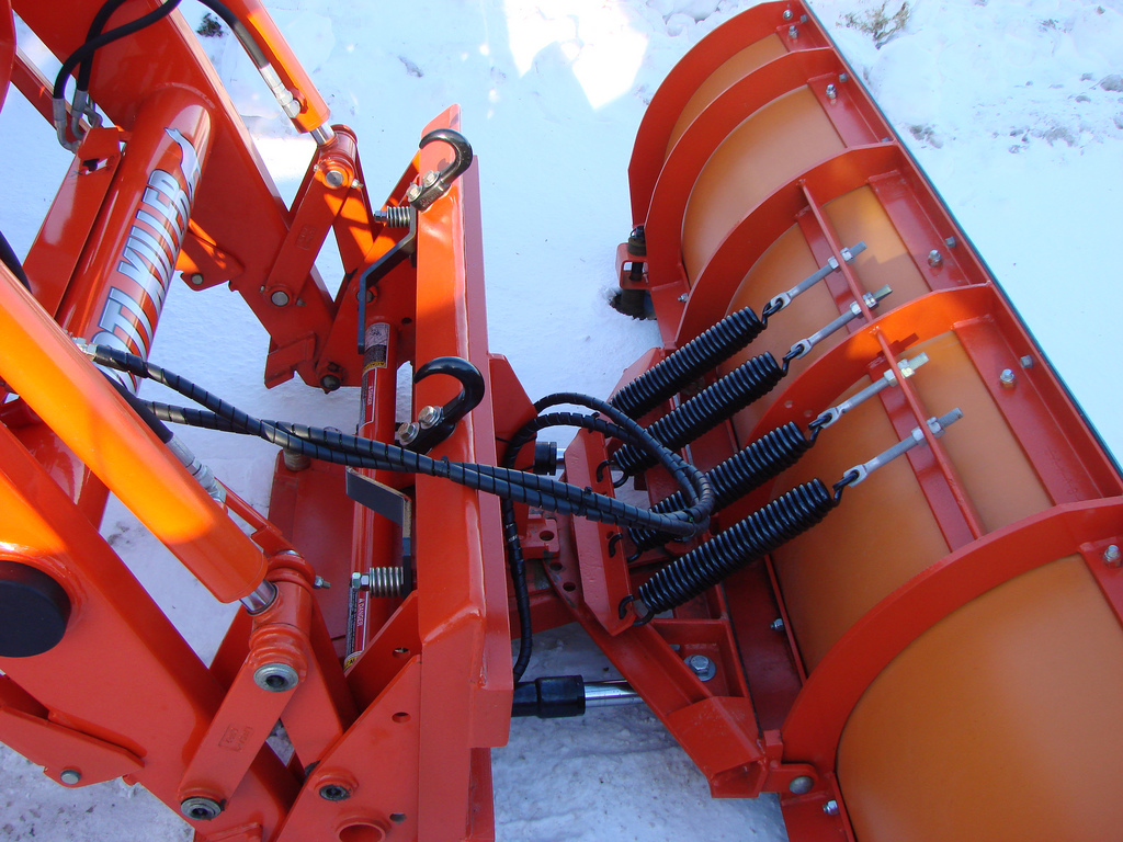

You can put hooks where ever you want, but you will need to lock down the top of the blade to keep it from tilting.
/ === BLADE HOOKS === #23
How would the blade tilt if the hooks are on the bottom?
Well, of course not, but it is an unusual place for installing hooks, and I would also recommend backing up the weld area with some larger plate.
/ === BLADE HOOKS === #24
Yes, you're right, it is an unusual spot, but I'm trying to help him, even if it's an "out of the box" type upgrade.
I like your idea of a backing plate. Moldboard skin is pretty thin.

I would install a couple of hooks so you can pass a cable under the blade and hook to. This way the blade is lifted by the cable when you are pulling out the stuck tractor, or when you are backing up to pull something else out. Just remember that the plow is only designed to raise so much before something bends...
/ === BLADE HOOKS === #26
I put a couple of hooks on my blade SS mount last year when I addapted it to the tractor. I went with the bolt on method. I didn't put them right on the blade due to the trip springs. They came in very handy during the winter to pluck vehicles that were stuck in the snow.
That's where I have mine, on the SS plate. I think the OP might have a frame mount plow.

Isn't your blade spring loaded? I believe your blade would tilt if you put any pressure on the top of the blade to lift or pull.
Quote:
Originally Posted by some zilch
as soon as you started to pull back with the blade, wouldnt it want to "spring over" just s if you hit something hard going forward while plowing?
I will have to put a chain on the blade and hook the other end to something and see what happens.

Ok - looks like I misunderstood your intentions. I can understand trying to lift something with plow if needed, or having a loop or hook to for lack of better way to explain it- to tow when stuck. I am just kinda bit horrified that towing would be done against the fast attach holding points. However- if the BX is stuck and front blade is on, and unable to tow from behind then I would say a hook perfectly centered low as possible would be ideal. Other then the brush gaurd, there is really no good place to place a emergency tow strap.
