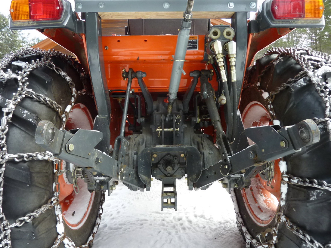

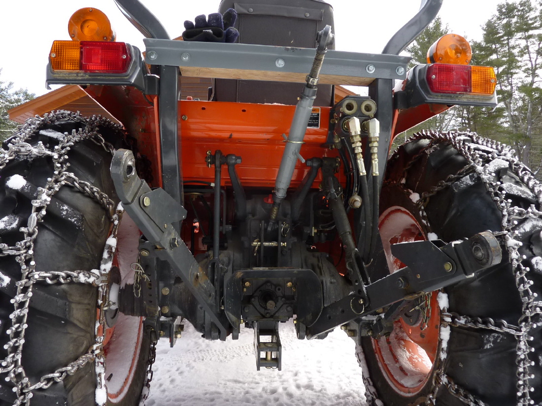

Gordon, any chance of a picture or two. How I'm understanding your configuration is that the bottom of your side links actually would be pointing towards your tractor instead of away from it. So when you have your side links set to the outer most hole they are vertical and the bottom does not slope away from the tractor? Is there a chance that your lower lift arms are on backwards? The holes that you connect to your implements should be attached at the tractor and the ones at the tractor should be the ones that are connected to the implement. I think that if your arms were to be turned around your tractor would be like the rest of ours are. To quote my wife, "Dude! They put your tractor together wrong!" Notice in the pics that the side links slope away from the tractor at the bottom.
OK here are my pictures. Both have the lift control in the full up position.
I took the first with both side links in the far holes. My normal position. Then I move the left side link to the closest hole. You can see the height gained. And if you follow the two arm angles out another 4' to where the blade would be, I think even you would agree that the blade would be signiicantly higher (feet) with the side links close. This would include the normal roll back from the top link.
Kubota Knows how to design things. This is a very flexable 3ph.

Hard to argue with your pictures, as they clearly show the arms lifting higher when the lift arms are moved closer to the tractor. But, in my testing, I got the opposite result. Possible it is because I was measuring implement height?
I took the first with both side links in the far holes. My normal position. Then I move the left side link to the closest hole. You can see the height gained. And if you follow the two arm angles out another 4' to where the blade would be, I think even you would agree that the blade would be signiicantly higher (feet) with the side links close. Not including the increased roll back from the top link.
Like I said I would not lie to you guys.
gg
Ok i see what your saying I didnt think you would lie to us. Question if you was to take the right lift arm and move the to hole #3 wouldnt that give the same hight and more stability on the lift arm itself. Just asking .:thumbsup:

The test you left out is the links in the hole closest to the tractor and the top link in the bottom hole.
Having your links in the hole closest to the tractor will raise (and lower) your lift arms more. However there is some complex geometry going on with the 3ph -- the length of the top link AND its mounting point on the tractor have a profound affect on the lift height (or lack therof) of the rear and angle of the implement. (Lift height in the front is always related to the lift arm.)
Depending on the mouting point of your TL and the legnth of your TL, you can actually "over center" (for lack of knowlege of the real term in this case) when lifting you implement and cause the rear to dip back down. This was a problem with my cutter. Until I started using the bottom hole I could not get the tail wheel more than a couple of inches off of the ground. (Of course if I shortened the TL screw jack I could fix it... but that was a lot of work.) I now have a HTL so the problem is moot.

Gordon, thanks so very much for posting theses pictures,:thumbsup: like they say,"a picture is worth a thousand words" Pictures sure help to clarify things.
I have looked at 100's of tractors and have to say that I have never noticed any that had a set of lift holes so close to the pivot point. I am curious as to how much the lifting capacity is diminished with the side links attached at that closest hole.
