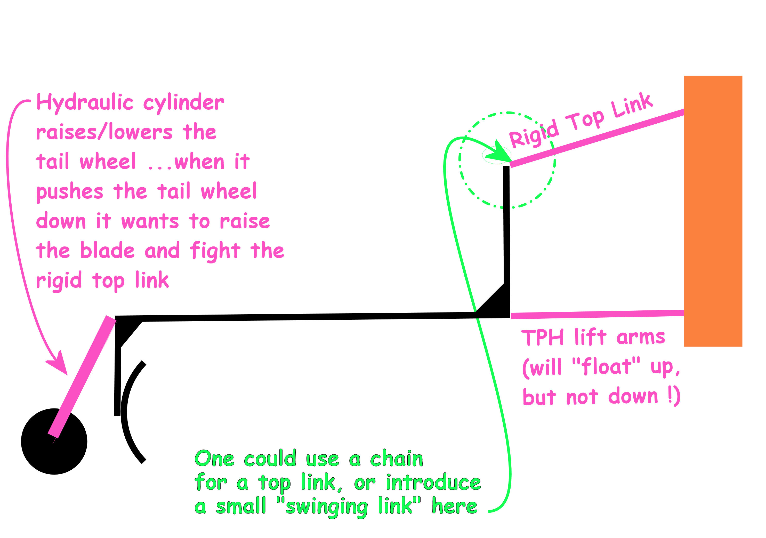

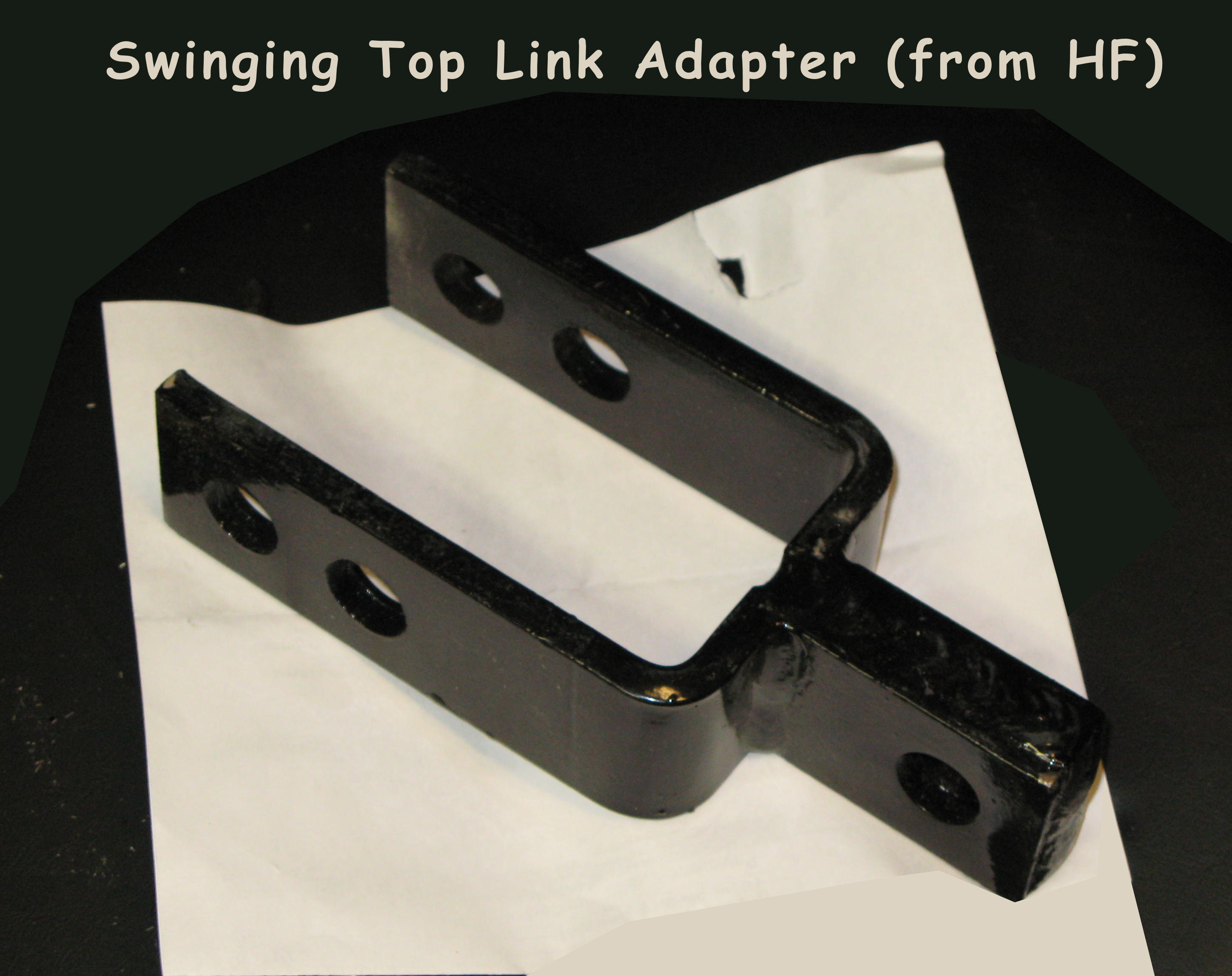

The geometry is tricky, but you should be able to correct "angle of attack" of the blade with your hydraulic top link ...if you can't get enough range of motion, consider using a "swinging top link" ...I do, because I also have a hydraulic tail wheel that I can adjust and found that it otherwise fights my top link ...here is a picture of the link I insert between the top link and the implement ...it is the often discussed Harbor Freight link.
These two pics should help explain and show the geometry

Yes, basically I have to use the hydraulic top link to get decent travel height for the scraper blade.
My rotary cutter has a moving frame for the toplink, so that works well. I ought to look at the mount dimension on the cutter (and box blade) vs. the scraper and see if the scraper has incorrect mount geometry.
I wonder if it has to do with the tractor being cat 1/2 and probably more vertical spacing between the lower arms and the toplink attach point. My scraper blade is supposed to be cat 1/2, but maybe it's not really deigned properly for cat 2?
