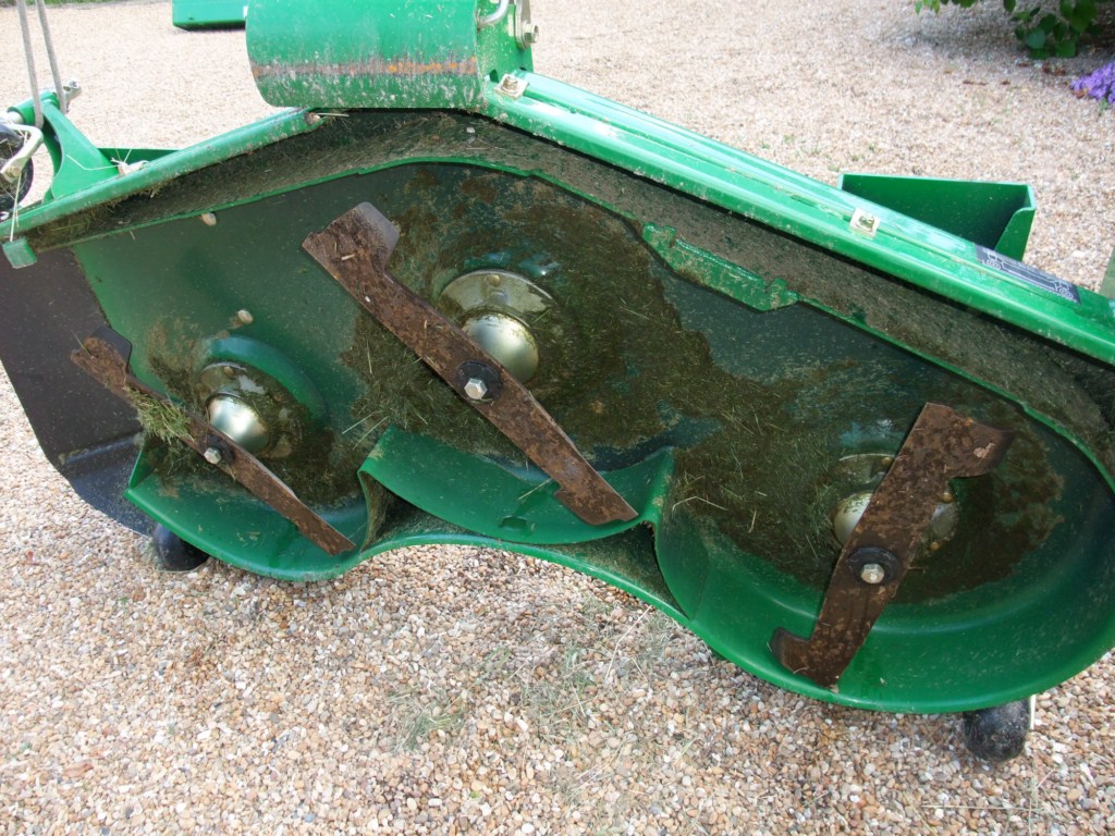

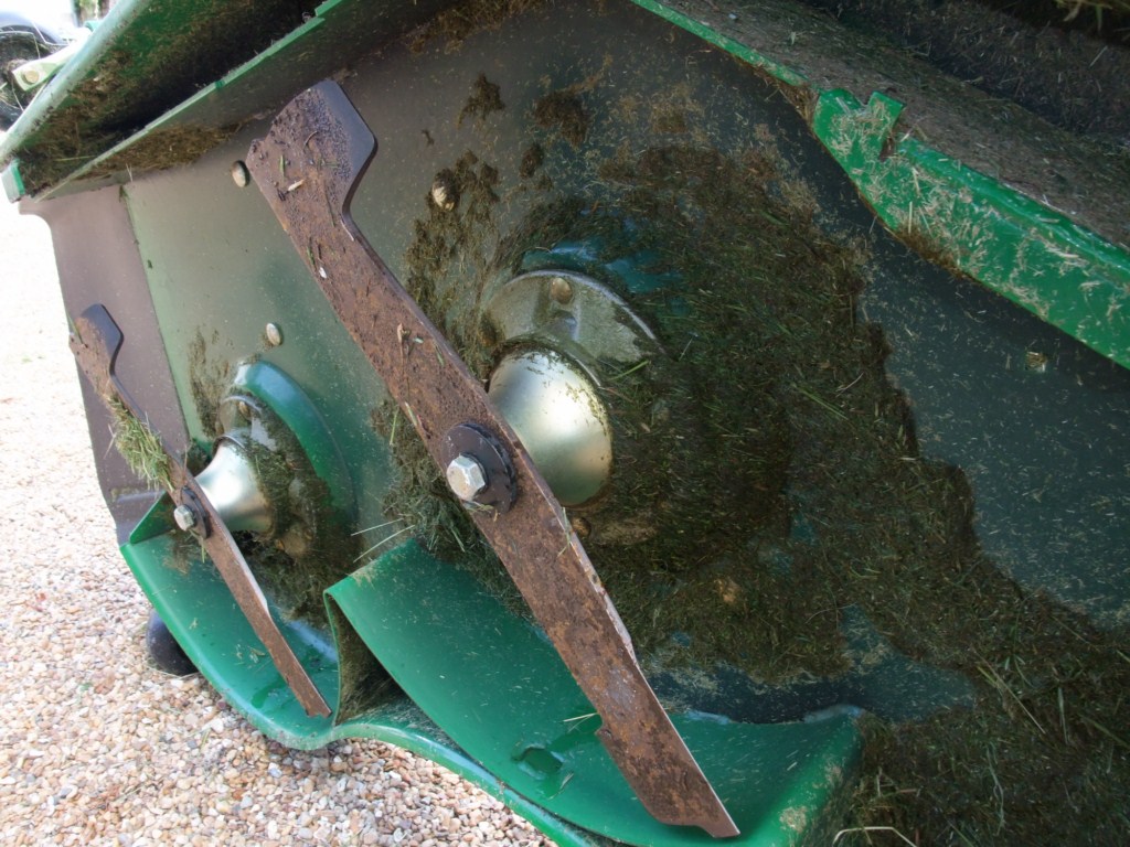

I meant the actual position the blades are mounted at. In post #5, PHILIP8N posted a pdf, and in it it shows the left blade mounted at 4-10 o'clock, the center blade at 8-2 and the right blade at 7-1 for prolonged service life. My question was aimed more along the line of, best placement for grass discharge. As a lot of you are saying...it dont matter, especially since they wont keep that position anyway. Just wanted to see what your opinions are.
   / Blade position on a 3-blade deck #19
I think the blades where random in that picture. It was showing to rotate your blades to different spindles..
   / Blade position on a 3-blade deck #20
I too think they only meant rotating blades from one spindle to the next. Setting them at any angle is meaningless.
