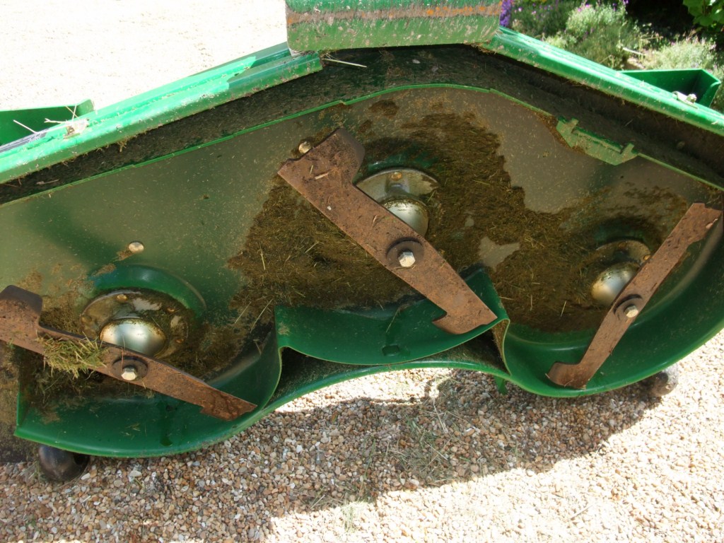

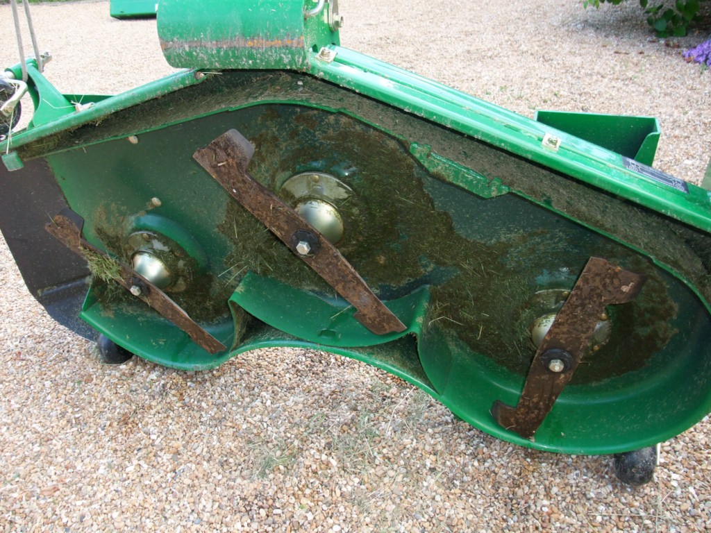

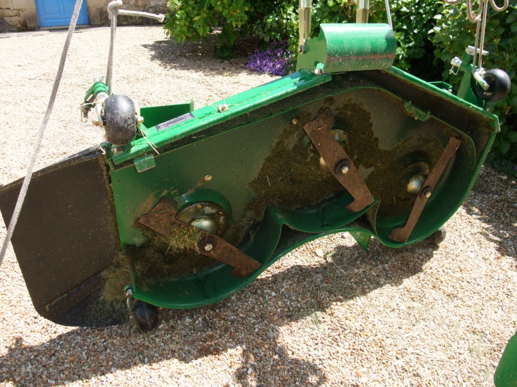

I think you had better adjust them so that they never come close to each other. This is how they are organized in my mower.

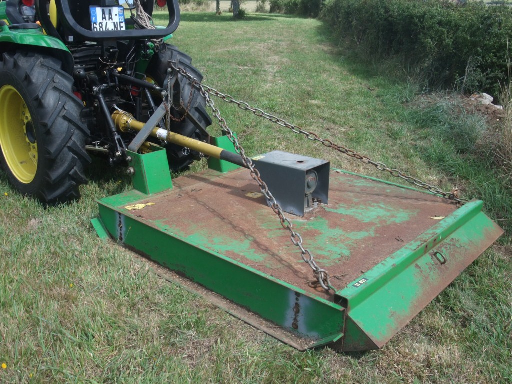

That deck in your picture looks like it has very high lift blades. It also looks like you don't have many hrs on the deck when the picture was taken. Have you had a chance to run it in higher than normal cutting situation. I'm interested because when mowing 5 or 6" high a lot of blades do not have the lift to pull the grass back up after runing over it with the front wheels in a higher than normal cutting situation.

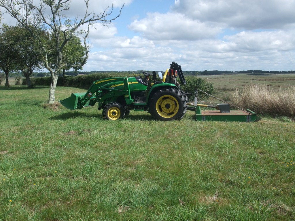

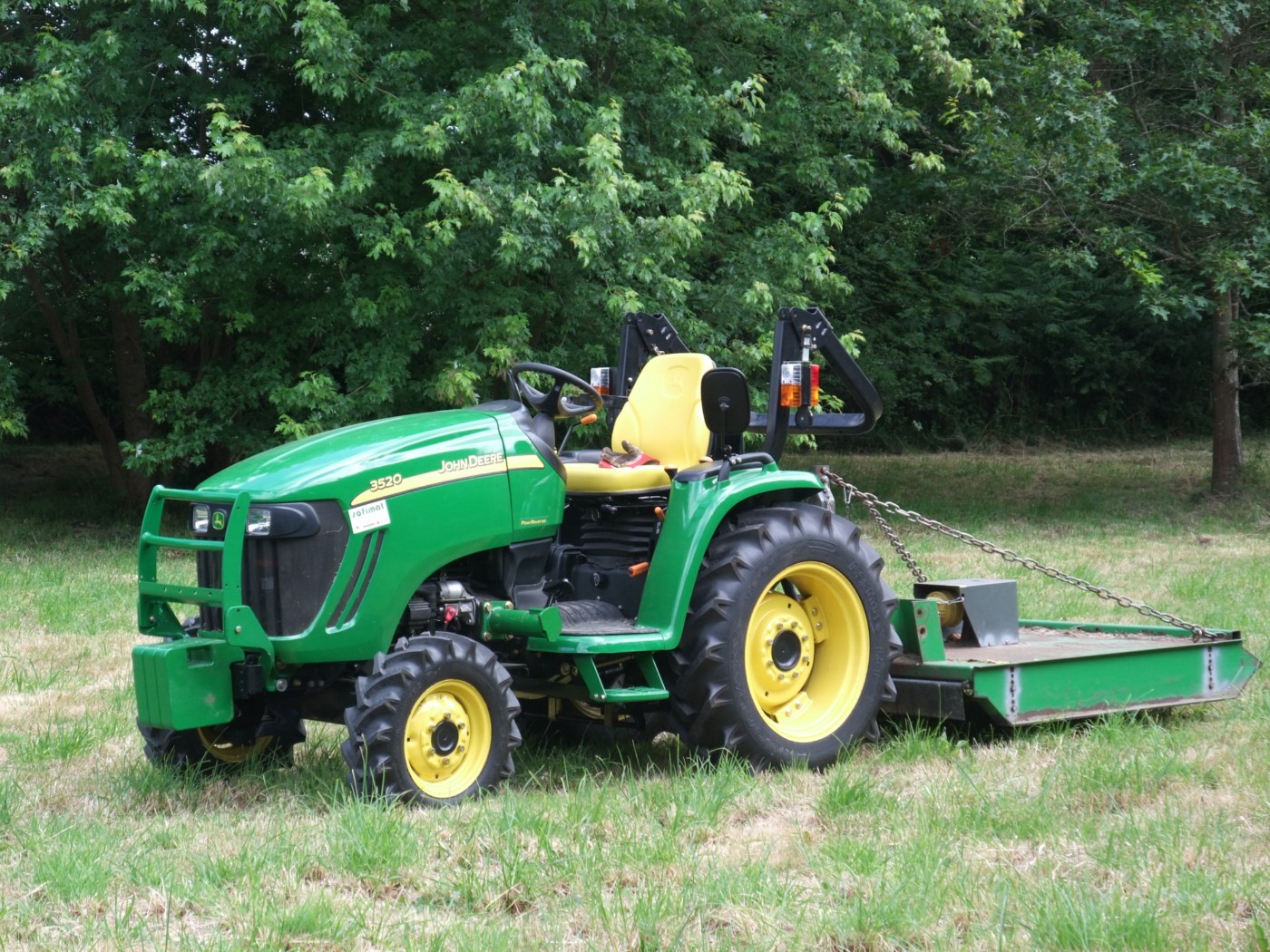

No I had only used that deck for one summer when the picture was taken, so I'm sure the blades are still in their original position. The blades are the standard blades that came with the deck and, yes, they have high lift. I often have to mow in high grass (sometimes 2 or 3 feet high) and the result, IMHO, is very much the same as with other decks. There are no incidents, I don't have to stop and clear cut grass from the deck, but I have to go over the grass several times and the result is far from perfect. Now I generally use the bush hog for a first cut when the grass is very high.
