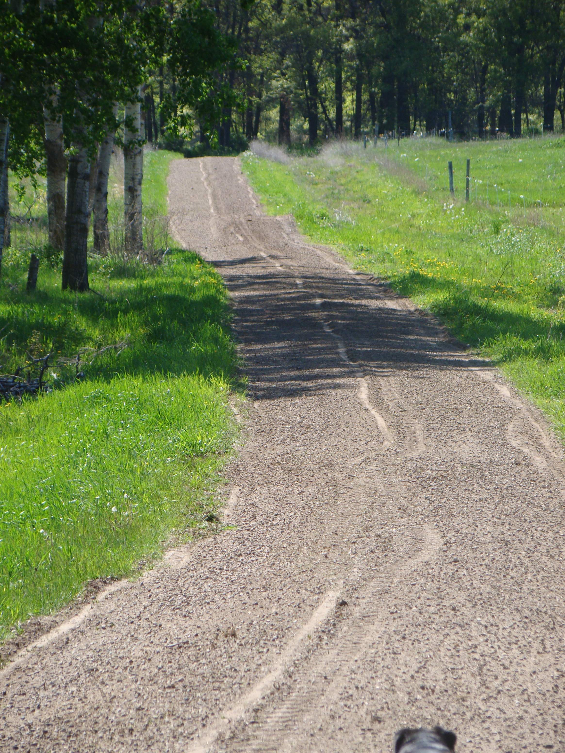

If you want to maintain a gravel driveway with a rear blade you need to take the same approach as the counties do with the big road graders. It is best to wait until after a rain. The gravel and fines will mix together better. They angle the blade so it moved the material to the center of the road where it leaves a windrow. Then they make another run with the blade angled so it will smooth that material out as it pushes it back out were it came from. They will repeat this process for both sides. They will also re-establish the crown down the center of the road.
Here is a picture of my driveway now. I planted some pature mix grasses in the ditches and on the slopes. I had just gone over the driveway with my Land Pride grading scraper. This impelement makes maintaining a gravel driveway a piece of cake. It even works best if the driveway is dry so I don't have to wait until after a rain. I just drop the implement down on the driveway and drag it along, no need to keep adjusting the 3 point. It helps maintain the center crown and it brings all the gravel back to the surface. I just drive down and back on the driveway. I just stay on the right side of the driveway and it build the crown back up. It's a huge time saver and is pretty much fool proof.

I believe on most CUTs draft is not available or may just be an option. If the blade is set perendicular to the the road and the direction the tractor is traveling in will begin to accent the humps and dips the tractor travels over as you are blading. You'll end up with rolling bumps. Running with the blade angled (like the big road graders do) will better shave the high spots and fill the holes. If you create a windrow in the center of the drive you can go back as spread it out. The loose material from the windrow will spread out much more smooth and even. The Land Pride grading scraper I use does this all without leaving windrows to clean up. It shaves the high spots, fills the low spots, re-establishes the center crown, and brings the gravel to the surface without having to worry about the 3 pt adjustment as you are blading.
