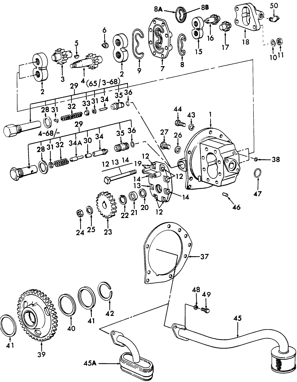

/ Bleeding Hydraulics, 1966 Ford 5000, Loader #31
betcha a suction filter is all emulsified up...
Oh Ok, thats what they mentioned. Do I really have to break it in half to access the sucktion hose filter? Or can I access it from the top, under the seat from that big opening, where the hydrolic line goes in. ??
/ Bleeding Hydraulics, 1966 Ford 5000, Loader #34
tried to reply to the pm, but you have your account setup to not rcv pm's.
I think you can get that filter under the hyd cover.. on a 2000/3000 you can.. but my parts manual is not at work with me.. take a look at the exploded diagram.
this also assumes your laoder is run of fthe internal hyds..e tc.

To access a filter on the hyd system seems to be would be insane if you have to break the tractor in half to do so. Even a idiot would not make it that hard for the common farmer to service such a part. thats why i thought the dealer was wrong about this. It just don't make sense. haha.
/ Bleeding Hydraulics, 1966 Ford 5000, Loader #37
did you take a look at the explode dparts diagram?
/ Bleeding Hydraulics, 1966 Ford 5000, Loader #38
check #45 if no DP
5000-SERIES 4 CYL TR / 10B02 HYDRAULIC PUMP ASSEMBLY, GEAR TYPE - 5000, 7000

/ Bleeding Hydraulics, 1966 Ford 5000, Loader #39
how you can remove it is to pull the lift top then you will need to pull the hyd pump and the filter should come out the pump whole you might have to remove the pto clutch pack but you shouldn't have to
you remove the lift top so you can twist on the filter to remove it

Yes, thanks, i looked at the diagram in my I @ T service manual and can see this.. Going to try it when i get the garage cleaned out this week so i can get the tractor inside on a concrete floor. Well I plan on it anyway. It really hot here in Foley, Mo
