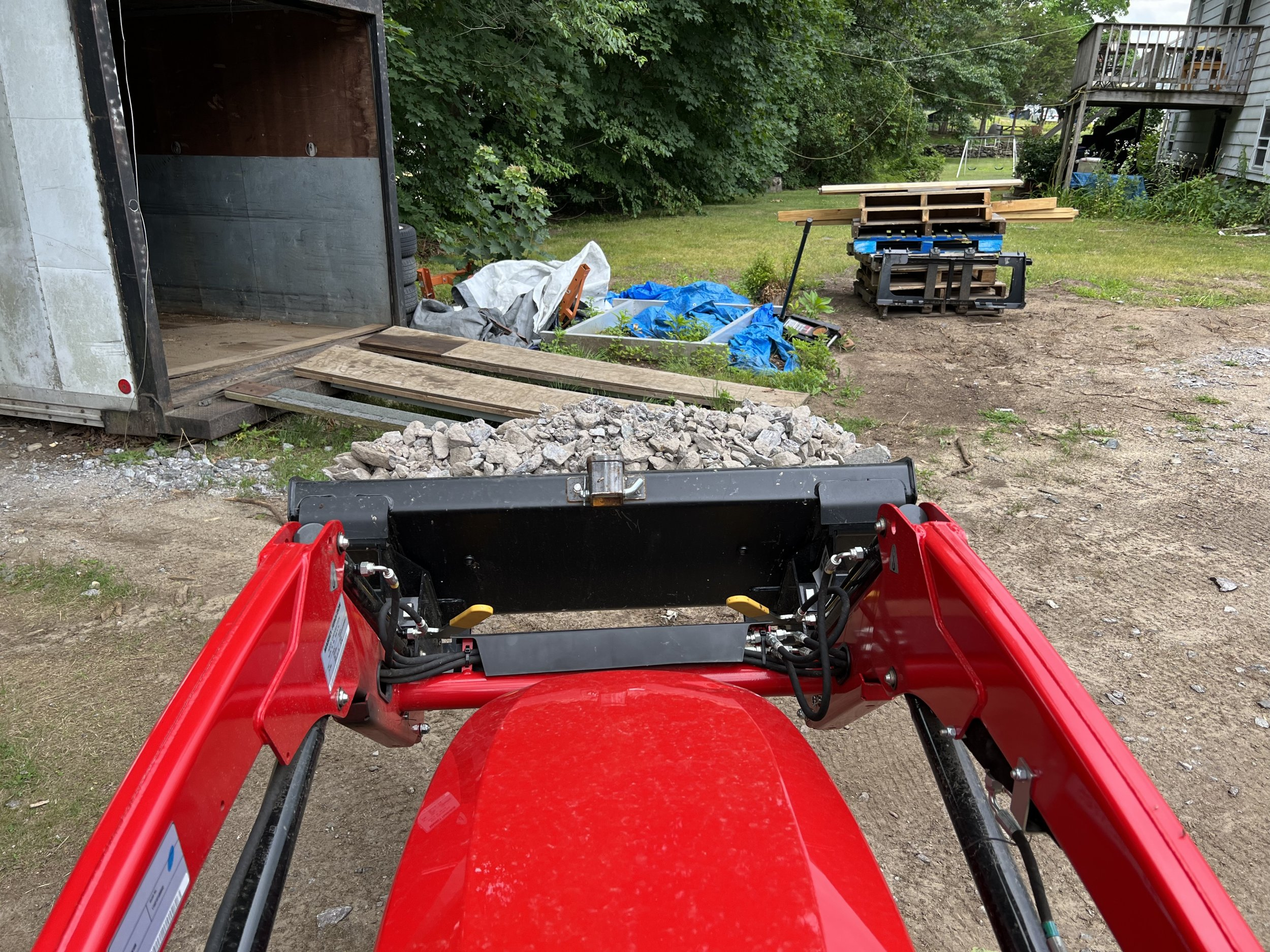

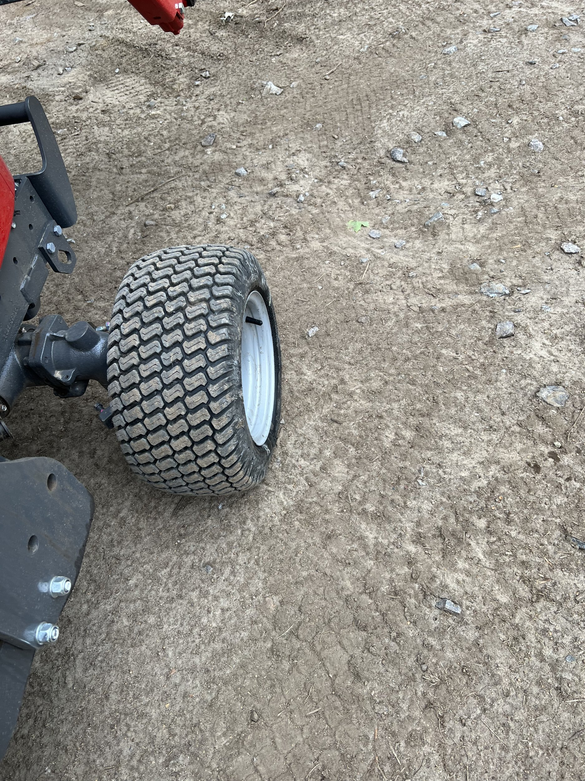

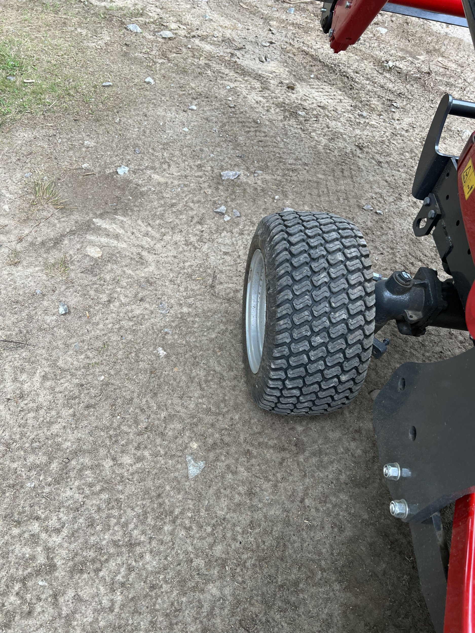

Tube held up fine today. It’s in the right front tire. Is there a good site to buy wheels off of?

Did they put a boot (or a patch) on the tire to limit future splitting?
   / Blew out the turf tire on the last scoop of the day.
#46
Looks like a patch under the split then they tubed it. Maybe it’ll last I have no idea. I used it a little bit today and it was fine. Im probably gonna get those 6 ply tires. I’m figuring I’m gonna need 2 more triaxle loads of fill to do what I want.
