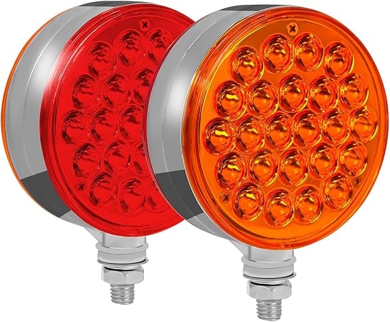

I switched to the LED lollipop lights on both tractors. Brighter, Cheap & easy to change.
