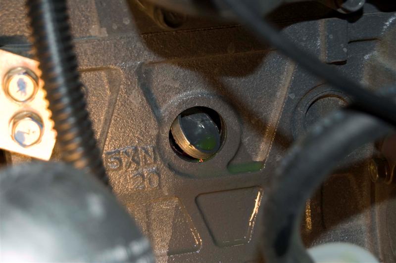

Step 2: Lightly tapped on the edge of the freeae plug (Just inside of the lip to keep from scratching the sealing surface) If you are going to remove it this way, punch it in from the right side, since there is more room on this side...the left side (engine forward) has the cylinder wall not far back.

Step 3: I pulled out the loose plug with a pair of pliers, cleaned the surface.
Step 4: Applied locktite sealer to the surface of the heater (the part that goes in the block.
Step 5: Seated the heater in the block using a 25mm Socket and a small hammer. It slid in without much resistance.
*Note: make sure you orient the connections up and down, not side-to-side.

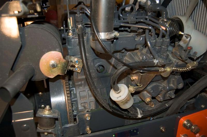

Step 4: mask off the connections, paint the heater
Step 5: Seat the electrical connector, push on the clip and secure the core with some nylon ties.
Step 6: refill the system with anti-freeze, run to make sure no leaks.

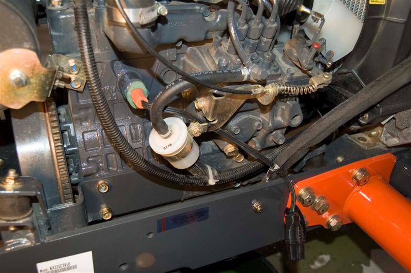

In lookin at your finished pic, Kubota has done some changes to the fuel injection pump from the previous BX series. The throttle control and cable assembly have been moved to the rear of the pump and it looks like a spring assist has been incorporated into the throttle control.
I'm going to guess that the modified fuel injector pump is where Kubota made that additional hp gain.

Yea, quite a bit different. I noticed that the shut-off solenoid works differently too. When you shut off the tractor, the solenoid extends for something like 2 minutes to shut off the tractor, then is released again, to normal running condition. At least a defective solenoid won't keep her from running...you could manually kill the fuel.
