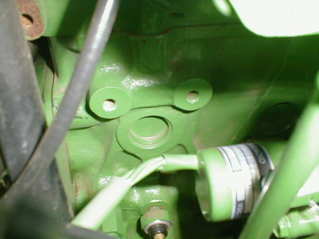

BillG - Here's a picture of the place on the 790 engine where I think it goes. I'll see if I can get some more info from my JD dealer.

OK - I think I've found the answer. I had my local JD dealer show me on a 790 where the block heater goes. Look on the LEFT SIDE of the engine block in about the middle. You should find a large (1") pipe plug with a square opening for a breaker bar. It is a threaded opening where the heater module is screwed in. He did say you do need a good quality breaker bar/extension as the plug is VERY tight. You do NOT need to remove any freeze plugs.
On the 790 the spacer, 2 bolts and gasket are not used, just the threaded heater module.
Now get out there and get it done and send us a photo!
