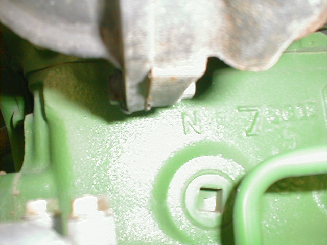

OK - I think I've found the answer. I had my local JD dealer show me on a 790 where the block heater goes. Look on the LEFT SIDE of the engine block in about the middle. You should find a large (1") pipe plug with a square opening for a breaker bar. It is a threaded opening where the heater module is screwed in. He did say you do need a good quality breaker bar/extension as the plug is VERY tight. You do NOT need to remove any freeze plugs.
On the 790 the spacer, 2 bolts and gasket are not used, just the threaded heater module.
Now get out there and get it done and send us a photo!

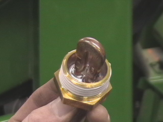

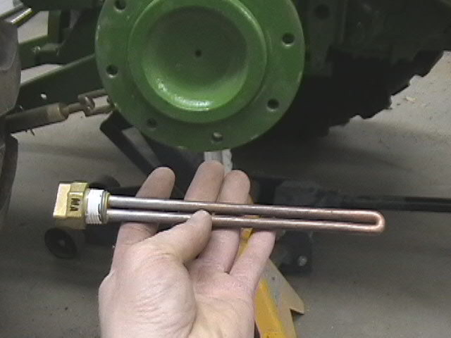

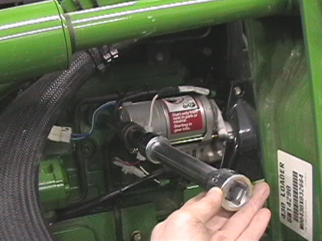

HI
Finally got around to installing my block heater. The previous info posted is correct. The plug is VERY tight, and a 1-3/8" socket will install the new heater plug very nicely.
I used my 3/4" drive ratchet with a 3 foot helper bar to remove the block plug. Incredibly tight !! Why on earth would they torque that plug so hard at the factory. I would be afraid of stripping or cracking the block.
I first put a bucket under the radiator drain and emtpied it. I still had to pull the block plug slowly as the remainder drained into the bucket below.
I have posted some pictures of the operation.
I also installed a transmission heater plug. It is a larger unit than the block heater. I just unscrewed the plug and immediately ( if not sooner) installed the heater. I only lost a small amount of trans fluid which I topped off at the filler. It is easier to access by removing the left rear wheel.

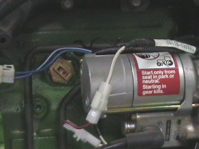

   / Block Heater on a JD990? #18
Photo of Starter and removal of !@@*!!@ Plug.
