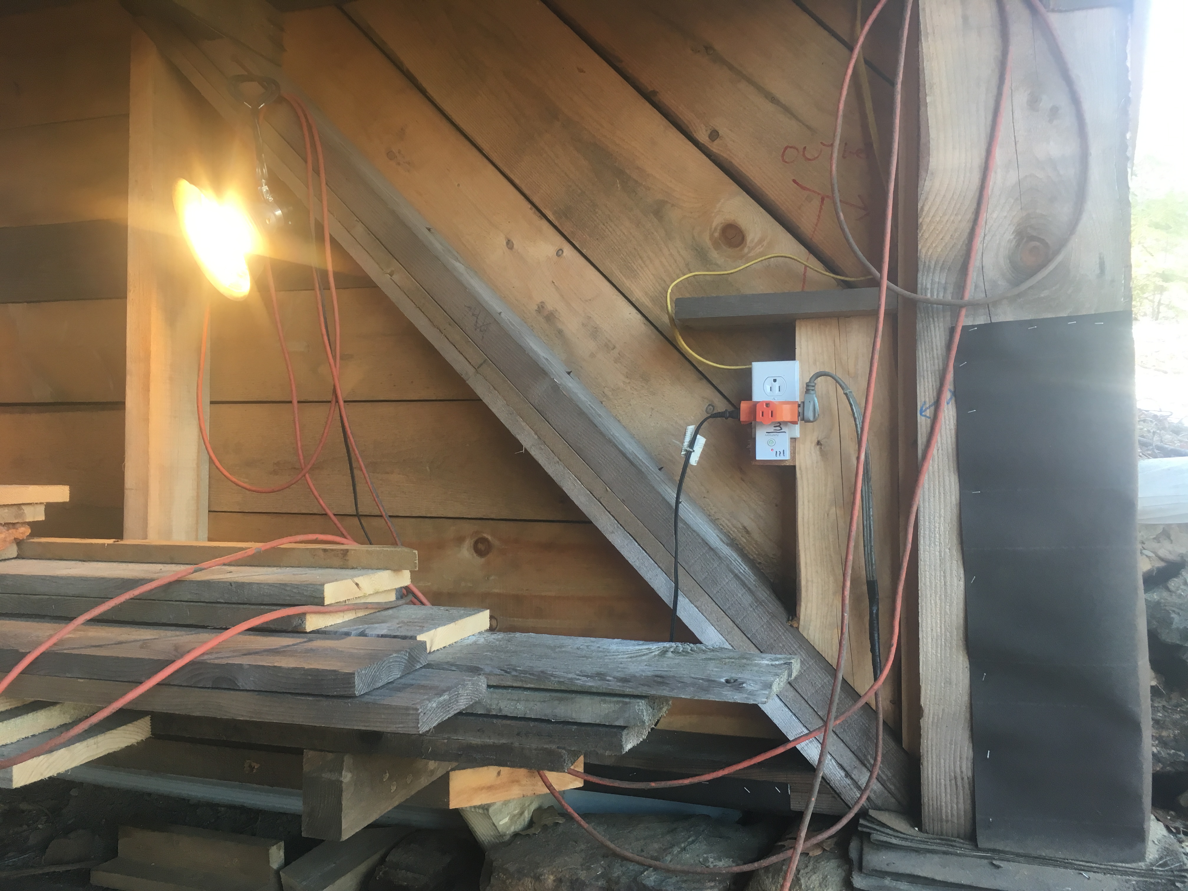

I have my block heater on a 50 ft regular power cord coiled up for other use when needed, the cord is plugged into a remote outlet which is plugged into a regular outlet under a lean to added on my shop, it is 75' away in a direct line of sight from inside of house, never tripped the breaker.

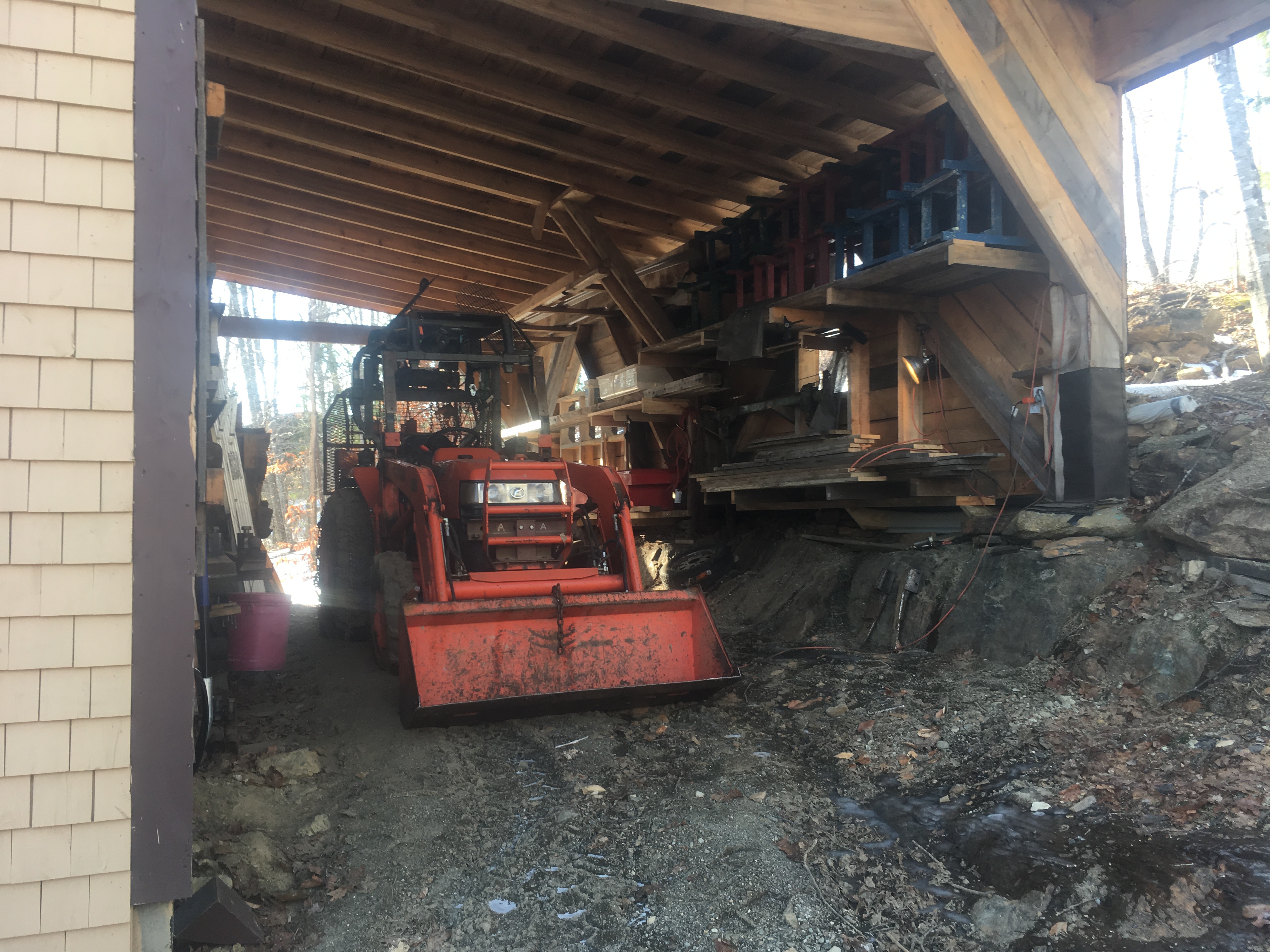

So I bought a new heater - the same kind that was on the tractor - hopefully this one lasts. Any good tips on how to make sure I have no air in the lines before plugging it in?

It's an inline radiator hose heater (I should be more careful with my descriptions!). On the tractor the two ports are about 7-8 inches apart (one above the other). The coolant level has been fine so I doubt the heater had air in it.
