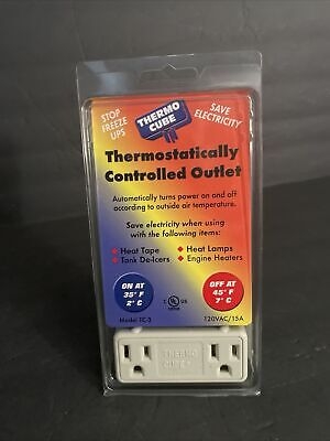

the brand around our parts is called ThermoCube. Available in bucket loads at local farm stores.
plug in the water heaters for the barn cats, duck watering stand, heat mats for the dogs, heaters for the dog houses, etc.... they come in different temp. ranges and simply plug into existing receptacle and say your block heater cord. Good for standard 15 circuit. Around here the go for about $35

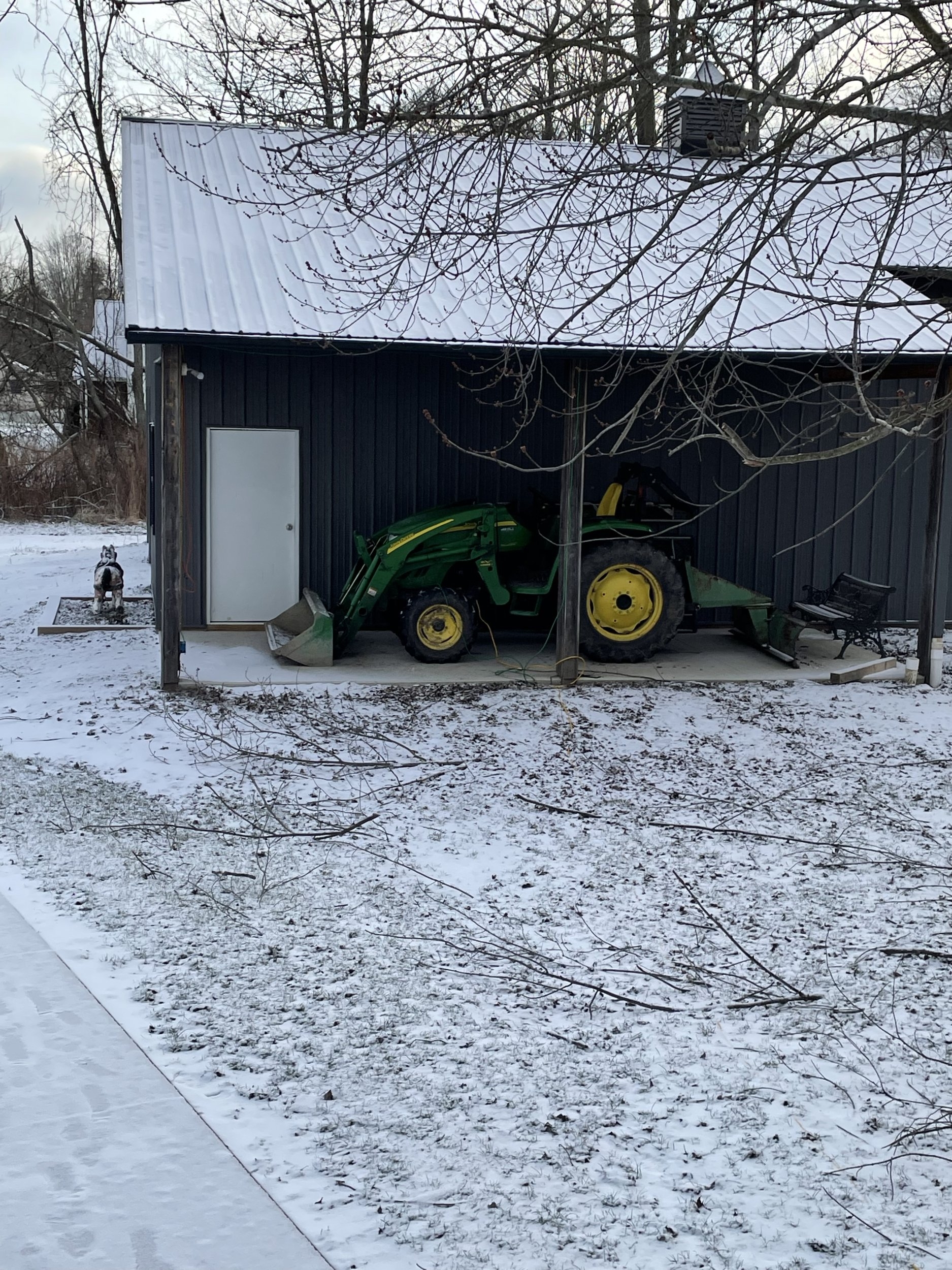

I am way up north, near the Canadian border. In the cold months (November thru March) I leave my block heater plugged in at all times , to an outlet that I control from a switch on the house. If I need to start the tractor in the winter, I’ll throw that switch at least a half hour before, otherwise it stays off.
Sometimes, I’ll call my wife or kids to throw that switch, like when it snows when I’m at work and need to clear the driveway in order to get my truck into the garage, or if if I kill a deer out back, and need the tractor to haul the carcass out.
I wired an outlet in the basement to a switch in our family room. There is a 12 volt adaptor plugged into that outlet, that powers a “bow-light” on the “boat-bar” in that room. An extension cord from my tractor’s block heater also gets plugged into that outlet. I know the block heater is on when I see that light lit.
A block heater reduces engine wear in cold weather, because it allows the oil to get where it is needed faster. There is no advantage in running it longer than an hour though. My tractor starts as smoothly on a 25 degree F day, when the block heater has been on for a half hour, as it does in an 80 degree F day, without it.

problem with thermocubes, it will heat whenever temp is cold, even on days your not planing to use block heater. my ford and dodge block heaters suck down between 500-1000 watts each hour they are on. thats alot of wasted power if your not planing on using the equipment.
/ Block heater #15
OK .... I accept the contradictions .... the ThermoCube concept no longer sounds viable.
