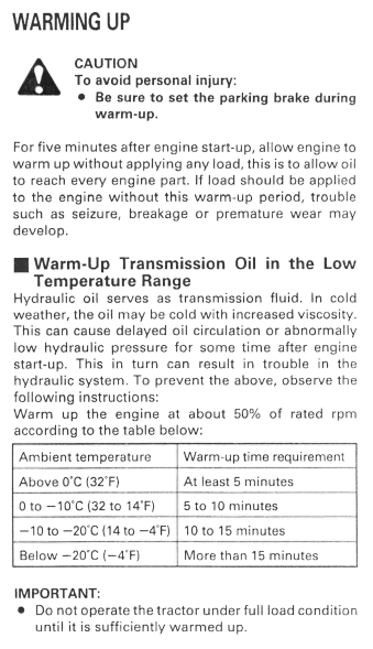

So, this brings up another question, which I think I knew about, but really have not followed. Engine warm up...some of these times seem pretty excessive, but what do I know. I do know that diesel engines are pretty cold blooded. What do others do?
Due to the high compression in diesels, and the thermal expansion that happens as the engines warm up, yes most diesels do benefit from gentle treatment until they are thoroughly warm.
Can you use it before then? Sure.
Is it good for the longevity of the engine? Not in my opinion.
Might something else kill engine first? Yes.
It's your engine, but I would do what the manufacturer recommends unless I had a great reason.
Some engines are a lot better at cold starting than others in my experience.
