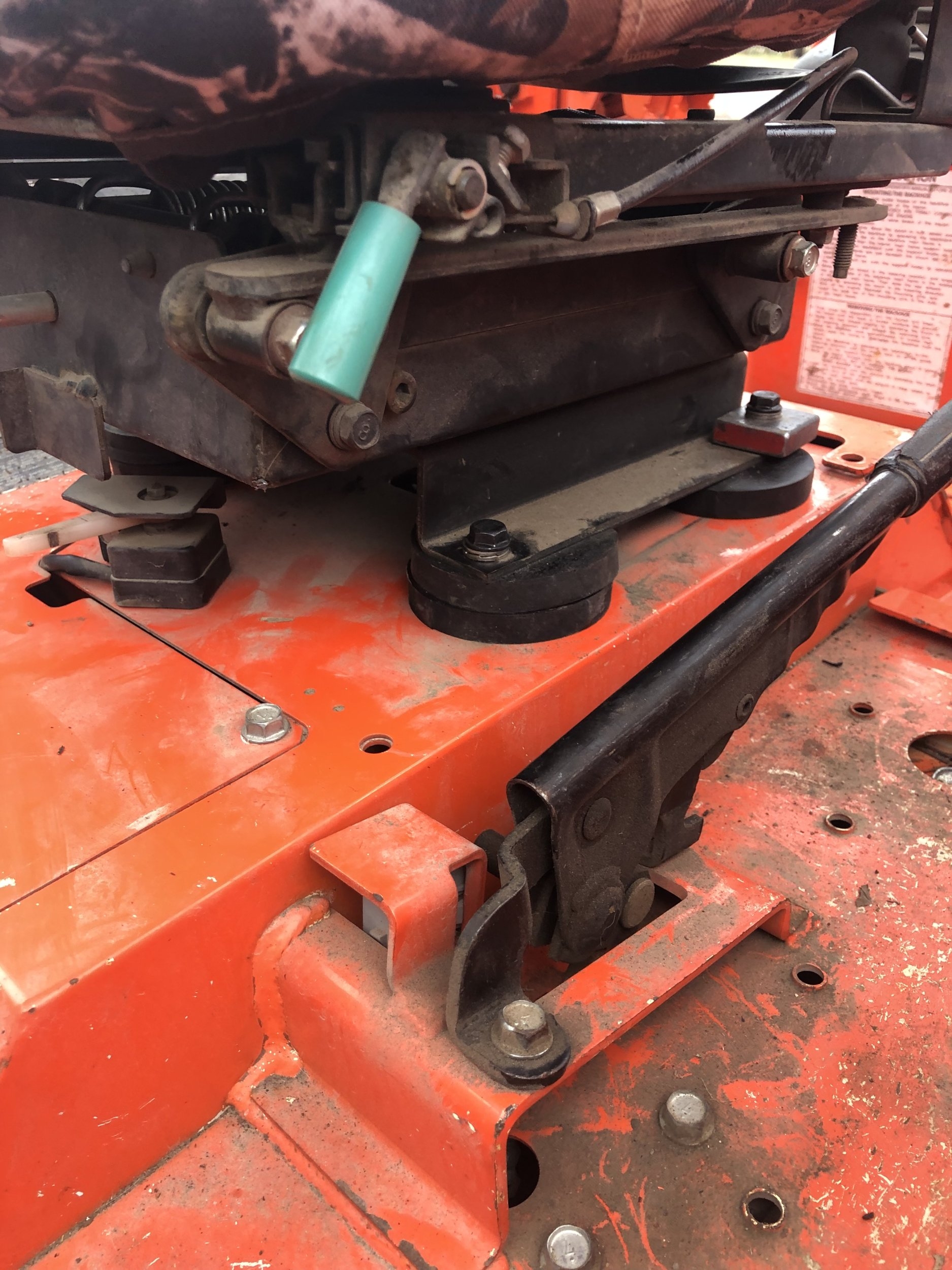

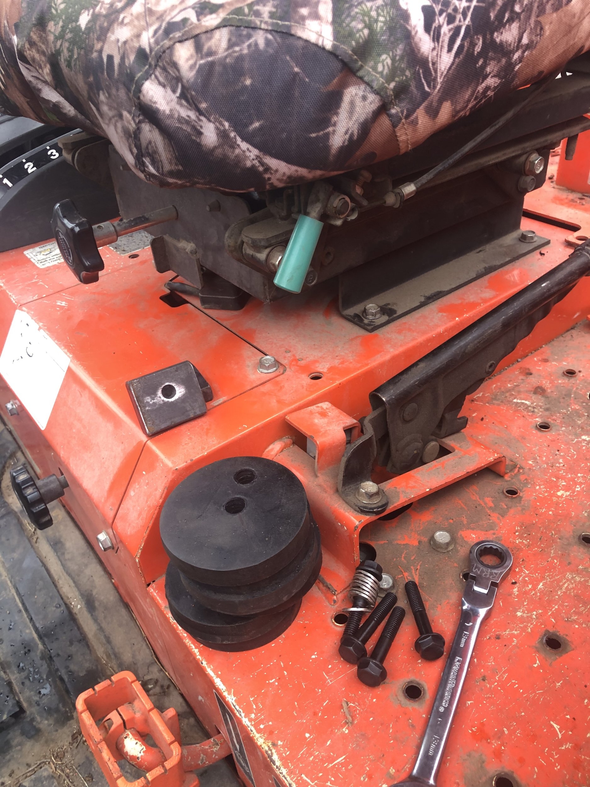

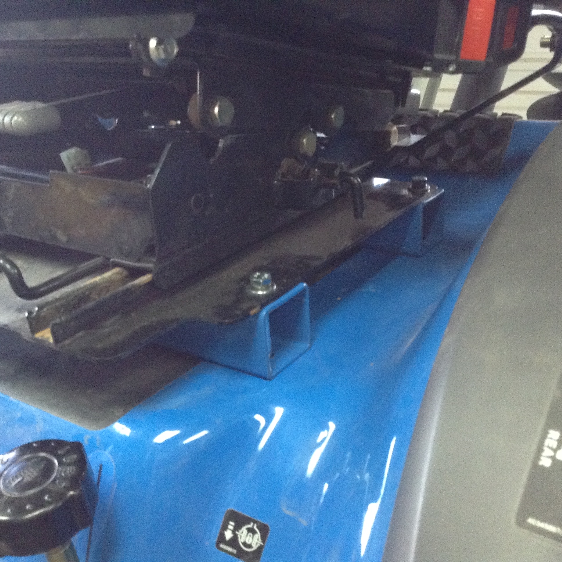

/ Block-up seat height #4
I raised the seat and improved the ride on my Kubota MX tractor using a suspension base. Be aware that raising the seat will make the steering wheel a longer reach. I'm 6ft tall and it feels like the tractor is designed for somebody shorter...
1-2 inches makes a big difference.

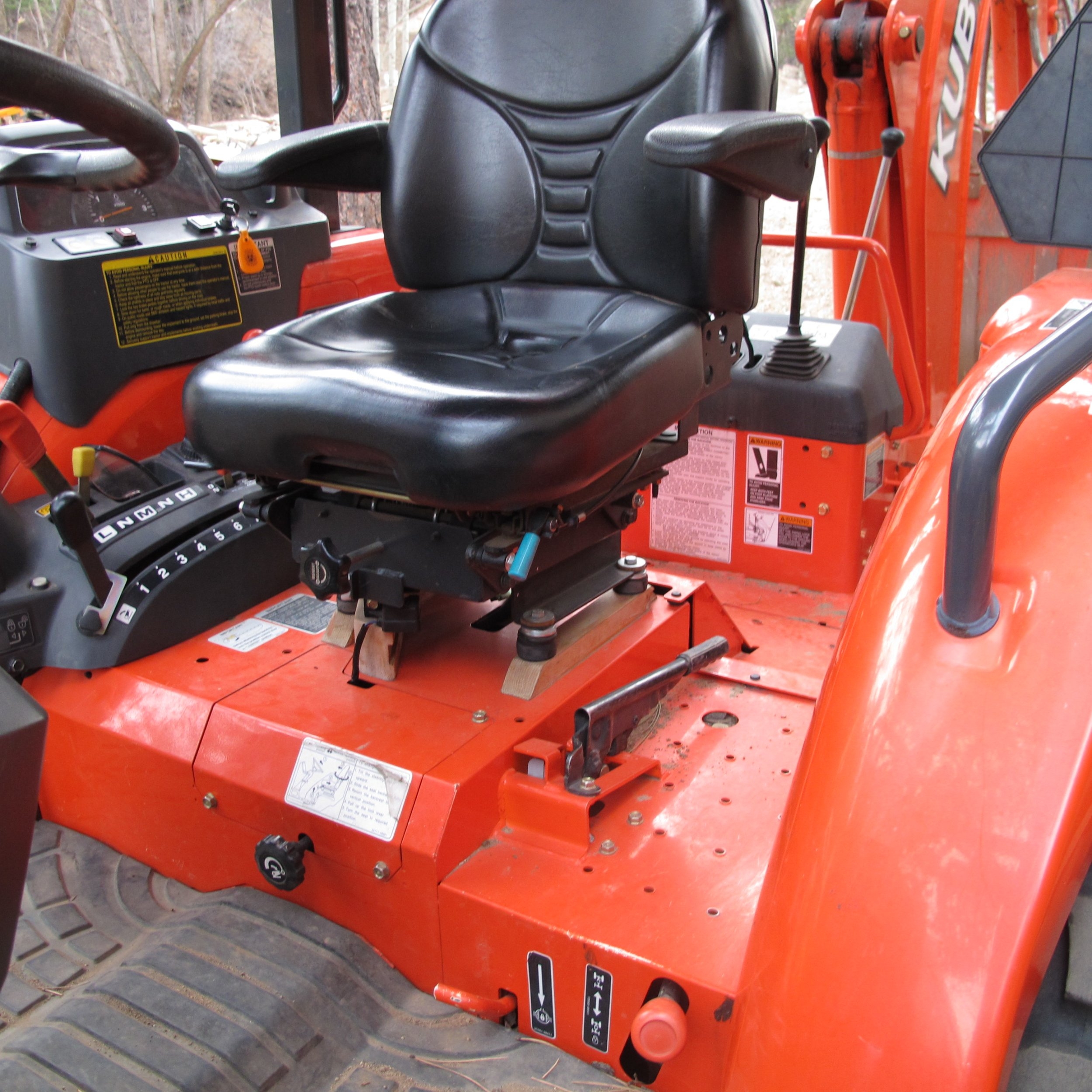

/ Block-up seat height #6
My dealer installed steel 2x4 hollow tubing under my seat rails as a courtesy when I bought the tractor. When I upgraded to a suspension seat, I didn't need the steel risers anymore, but I did add 2x6 PT plate to the steel floor under the seat to raise it another 1½" instead of the 3½" the dealer did. Previous poster is right. Couple of inches makes a big difference for us taller guys.

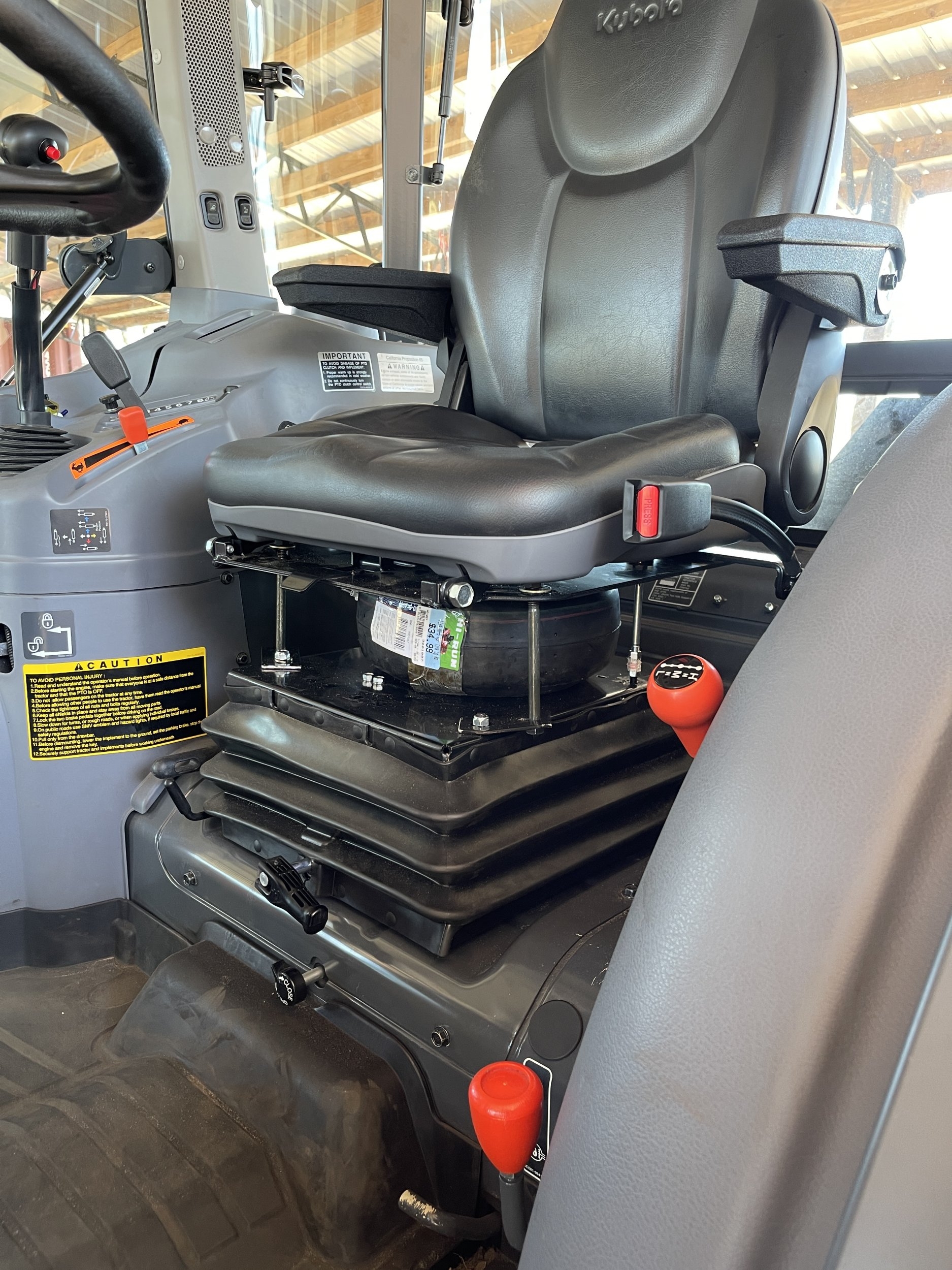

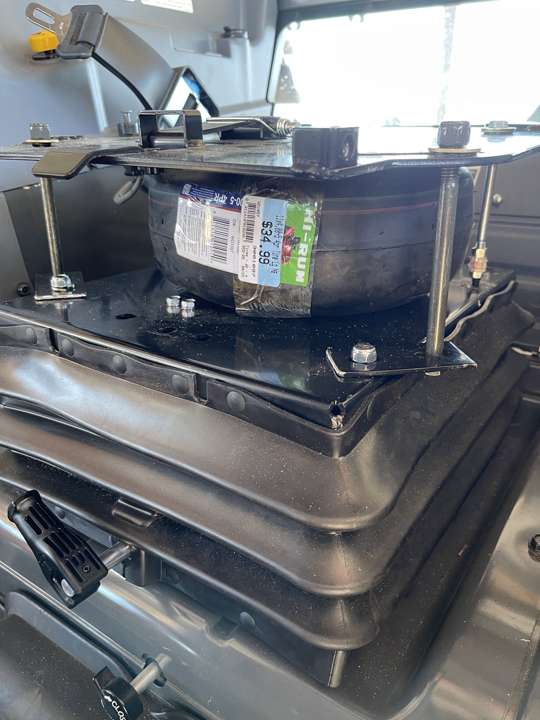

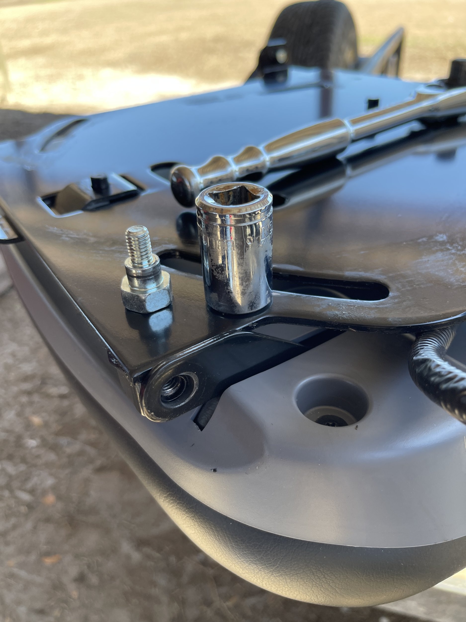

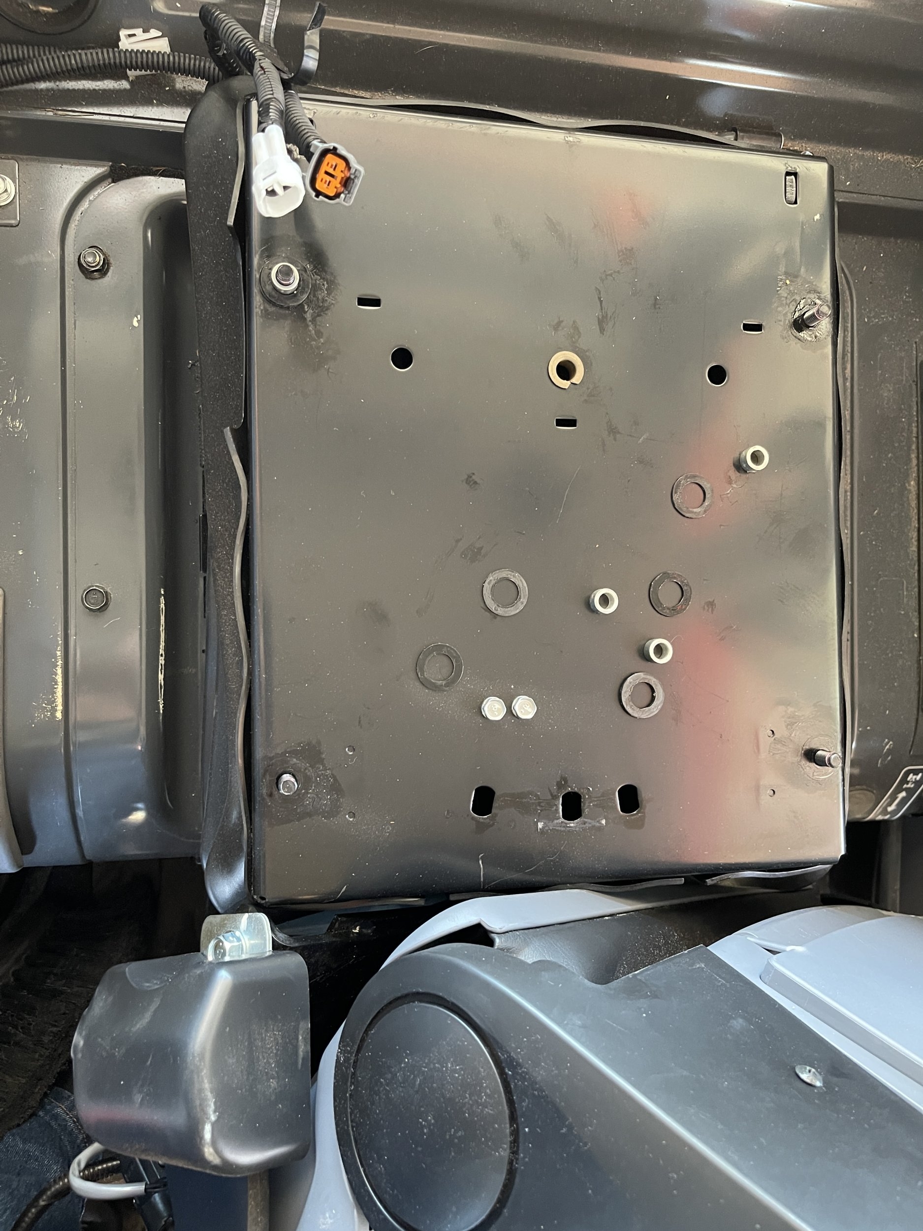

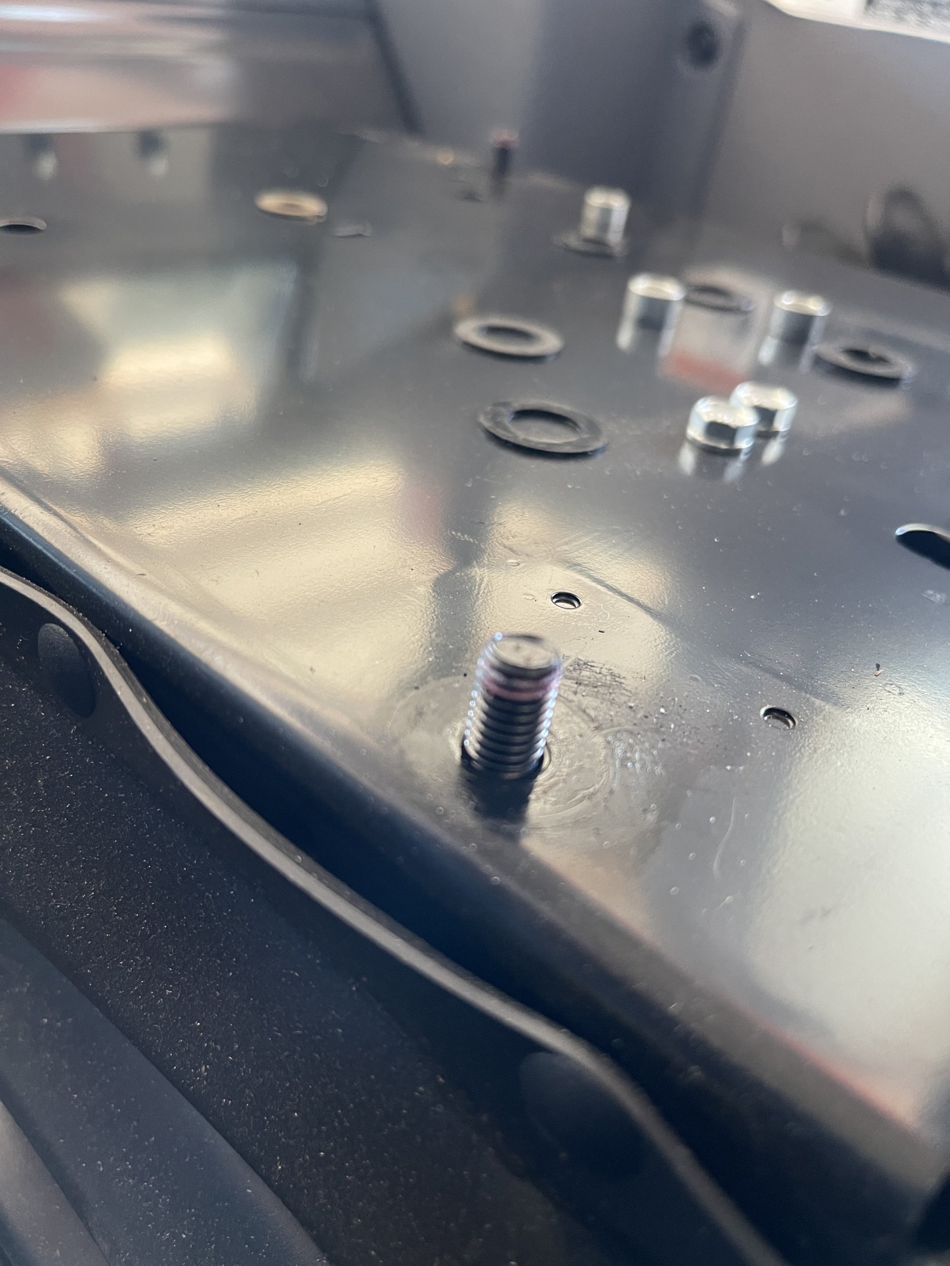

I’m happy with the results, I’m 6’1” and still have headroom. You can see the factory studs under the flip-up seat are only about 3/4”. On the rear two I used bolt extensions, on the front I made a short plate to add two heavier #8 bolts out to the side. I did add an inner tube and used about 24lbs air pressure
Coupling nuts is the correct term, when I said (nut extensions). I only found two at the correct size. Therefore I made two extension plates to add heavier bolts for the front

I would have utilized a friend who is an excellent fabricator, but he is in Tennessee and I moved to Florida. Therefore I developed this fix due to availability of parts in a small town, and my limited abilities

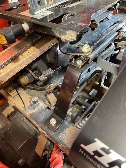

/ Block-up seat height #11
The seats on all three Kubota tractors I've had felt like they wanted to dump me into the steering wheel. On the current tractor, I did a very simple modification to eliminate that. The front two factory bolts were discarded and replaced with longer ones. These have extra nuts to make it adjustable and lock the position.
