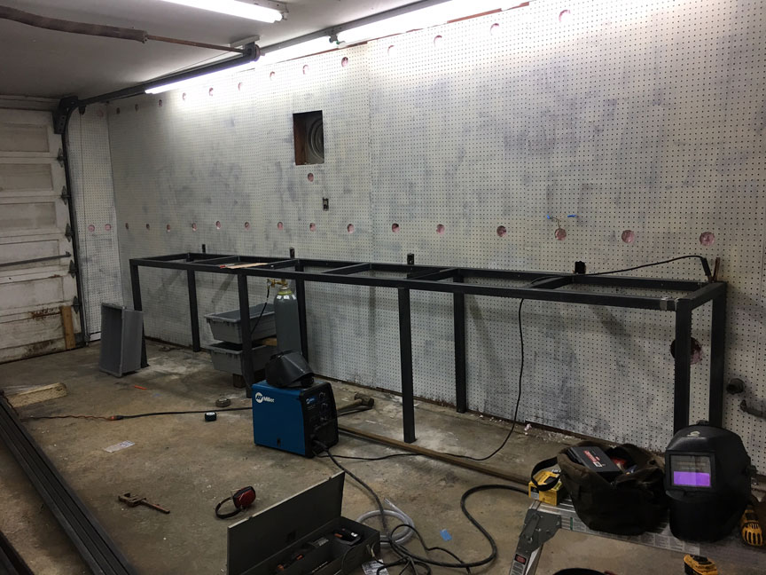

500996d1488772922-blow-insulation-behind-pegboard-workbench_steel_structure-jpg
Built the workbench structure today. That's all square tubing 2x2x.063.
Front legs bolted to the floor, rim and back legs screwed to the wall.
Dang outlets were at a crappy height so abandoned them. Will cover with a backsplash. Benchtop height is 40".
Yep dangit there's fireblock. I'll cover the blow-holes with a belly band, will put outlets in that. Belly band will be level - pegboard holes are NOT level. I'm not happy about that.
