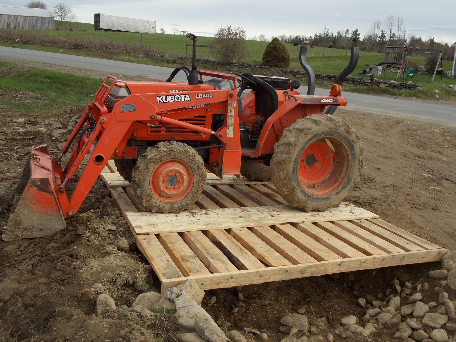

Have you ever thought about just building a wooden bridge?
I built this 8 foot bridge (an 8 foot span, 12 feet wide) that is plenty strong enough for my tractor for $16.50. I could have used a culvert, but it would have been more expensive, and culverts are kind of ugly.
