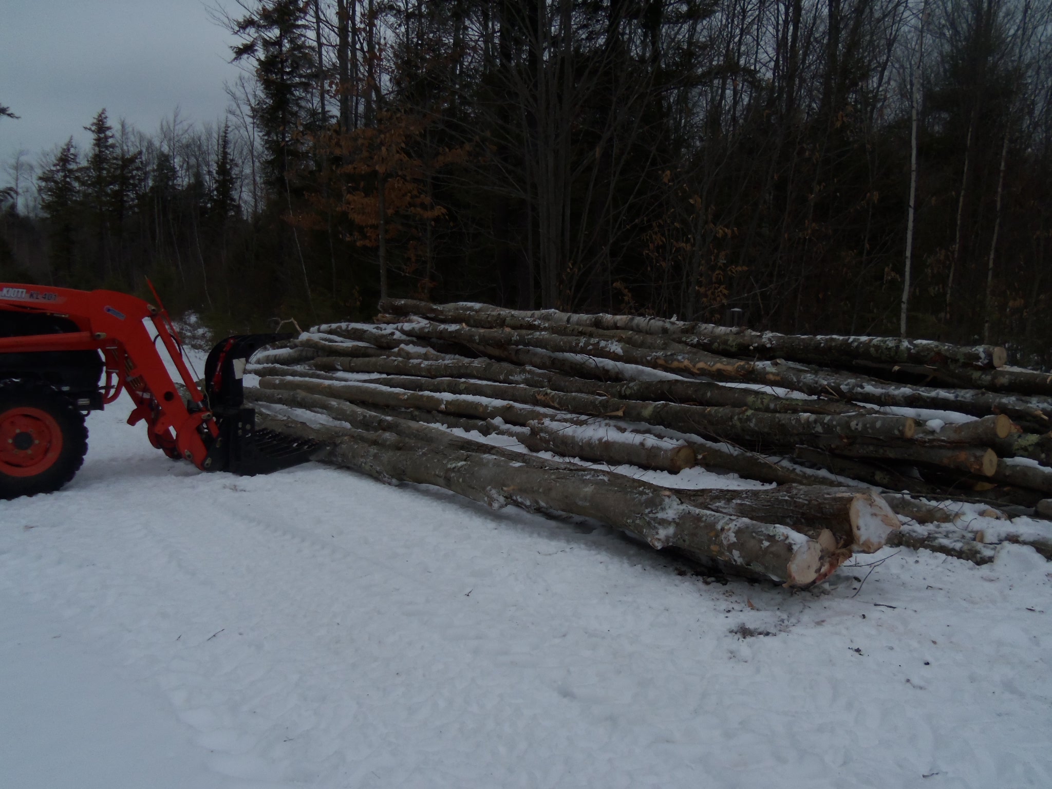

Here are some the logs I have been hauling out of the woods with my Tafjun 35.
