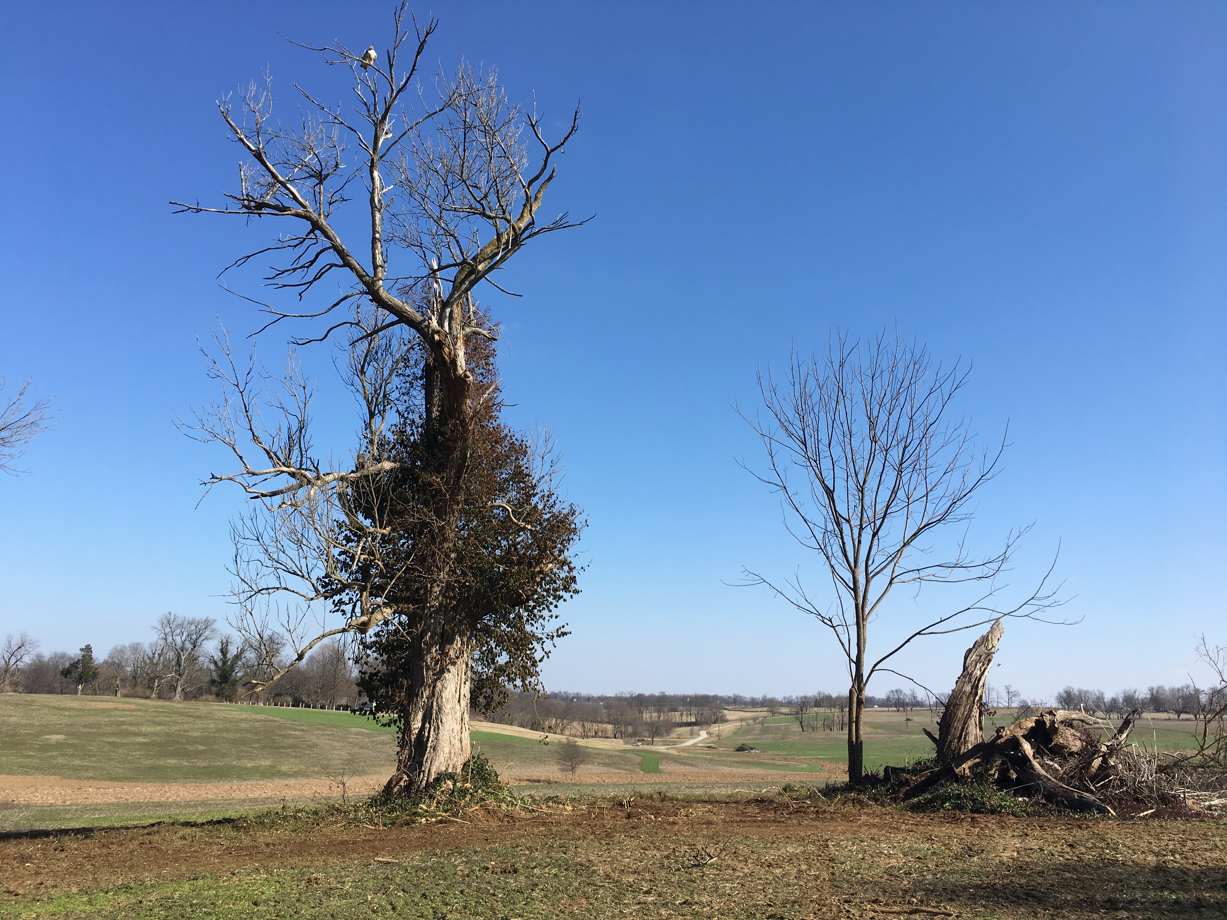

It's been a while since I updated this thread. We have been working, but I haven't been posting much.
I've had this week off, so we were clearing old fence and around our 400-500 yo Blue Ash trees.
I cannot give enough praise to the Danuser Intimidator. It pulls posts and fence easily. But even more impressively, it pulls brush and trees incredibly well.
These are before and after pics of a small section I cleared today. Hackberry, locust, and honeysuckle. Between 1"- 8". It pulls big honeysuckle bunches whole and allows you to carry them to your pile. It pushes over large trees then pulls them roots and all. It will also pull 1/4" sprigs 12" from the ground. I can pick 20yo 4" ivy vines from the trunk of the tree and can pick up 1000lb dead falls. In short, it is awesome.
There is only one thing that should be changed in the design and while it is minor, it would be an easy fix. They just need a clear channel to clear out the dirt from the connector between the front of the blades.

Yep, tree pullers are very handy.
Surprised that you didn't comment on the hawk in the second picture:
Cropped for closeup:

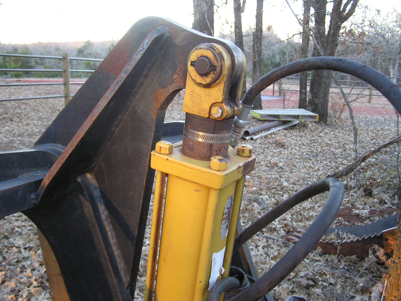

This 5100e 100hp MFWD pulls this 6.5cu yd dirtpan just fine. As long as I don't jam the blade deep in the ground too quickly, which is unfortunately easy to do. I purchased 2 different types of hydraulic cylinder clip on stops, neither of which worked for me.
The pan pulls easily and dumps/spreads extremely well.
Are you still using the dirtpan?

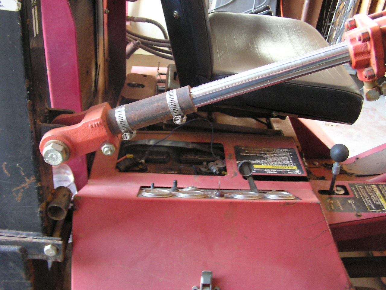

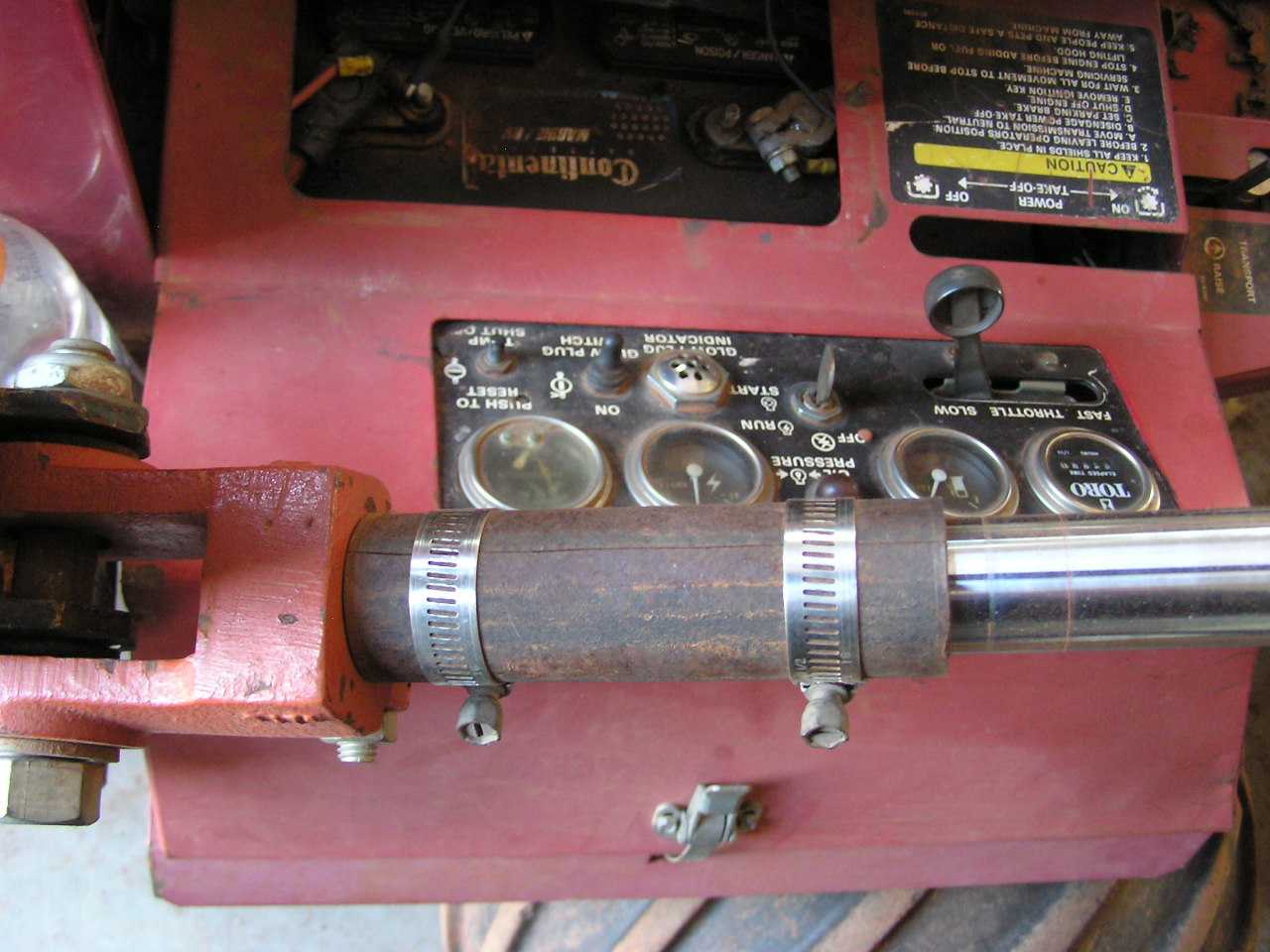

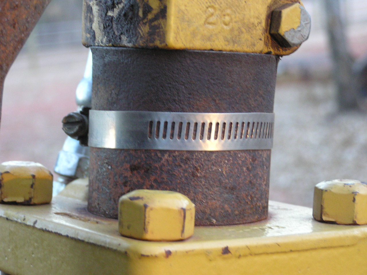

I made stroke stoppers by splitting tubing long ways and clamping to the rod:
This one has been in use for 12 years. :thumbsup:

Xfaxman
THAT is exactly what I need. And about what I had thought about doing. Did you split only one side open it, and bend it back ? Or did you split both sides and use the clamp to hold it in place?
I'm going to have to do that, as I know that it takes too much time to feather it each and every time I fill.
