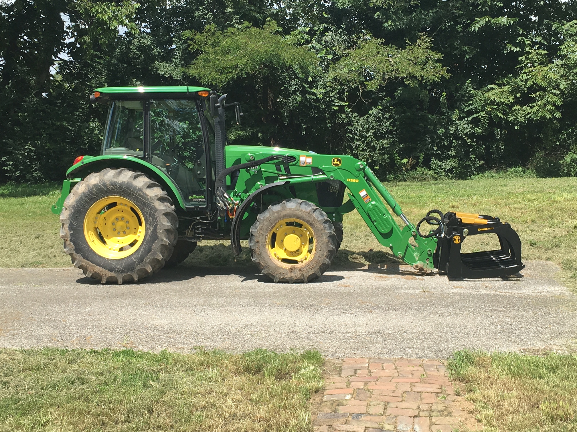

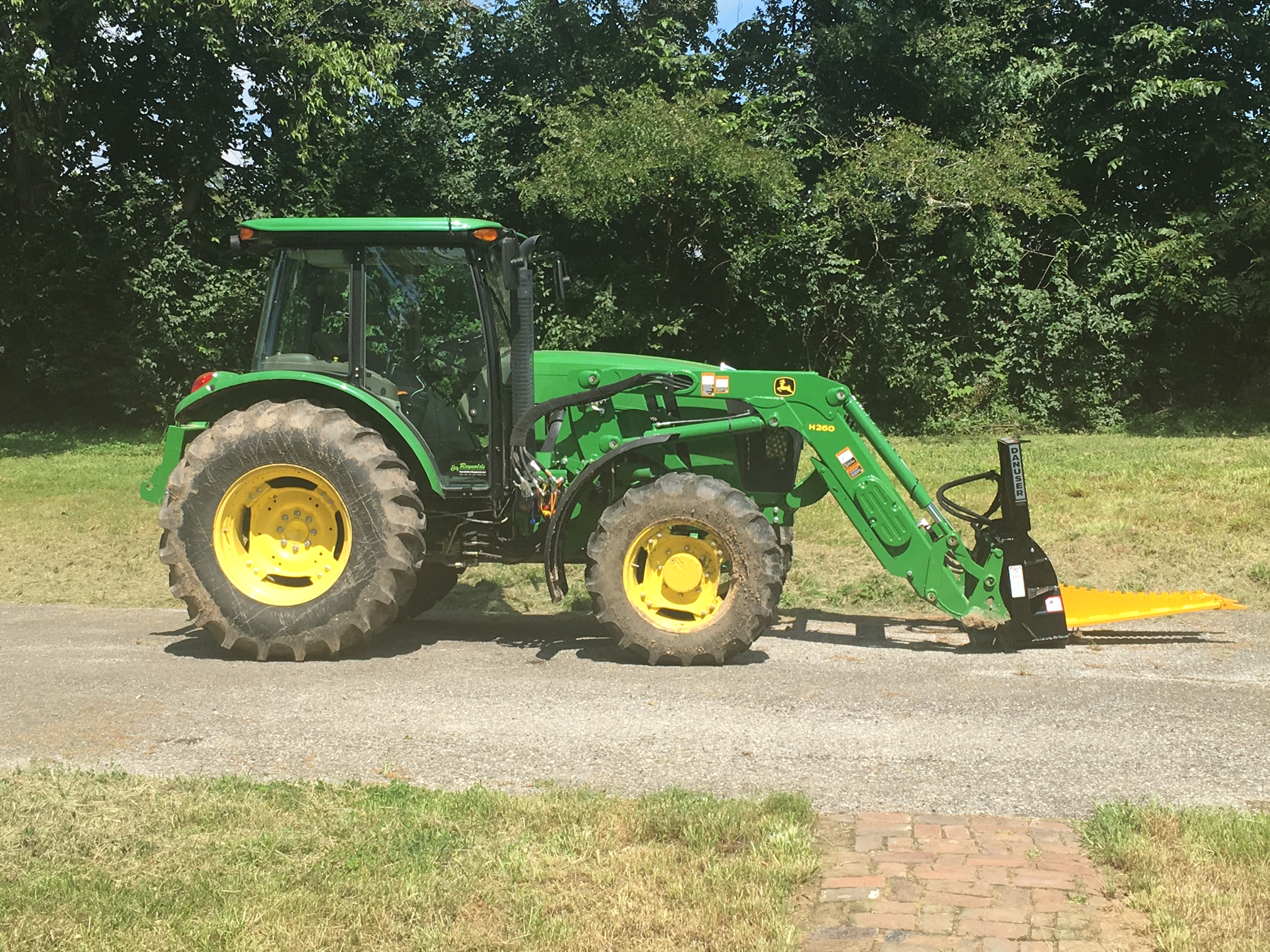

Its been a while since I've posted here. Lots of working on the farm.

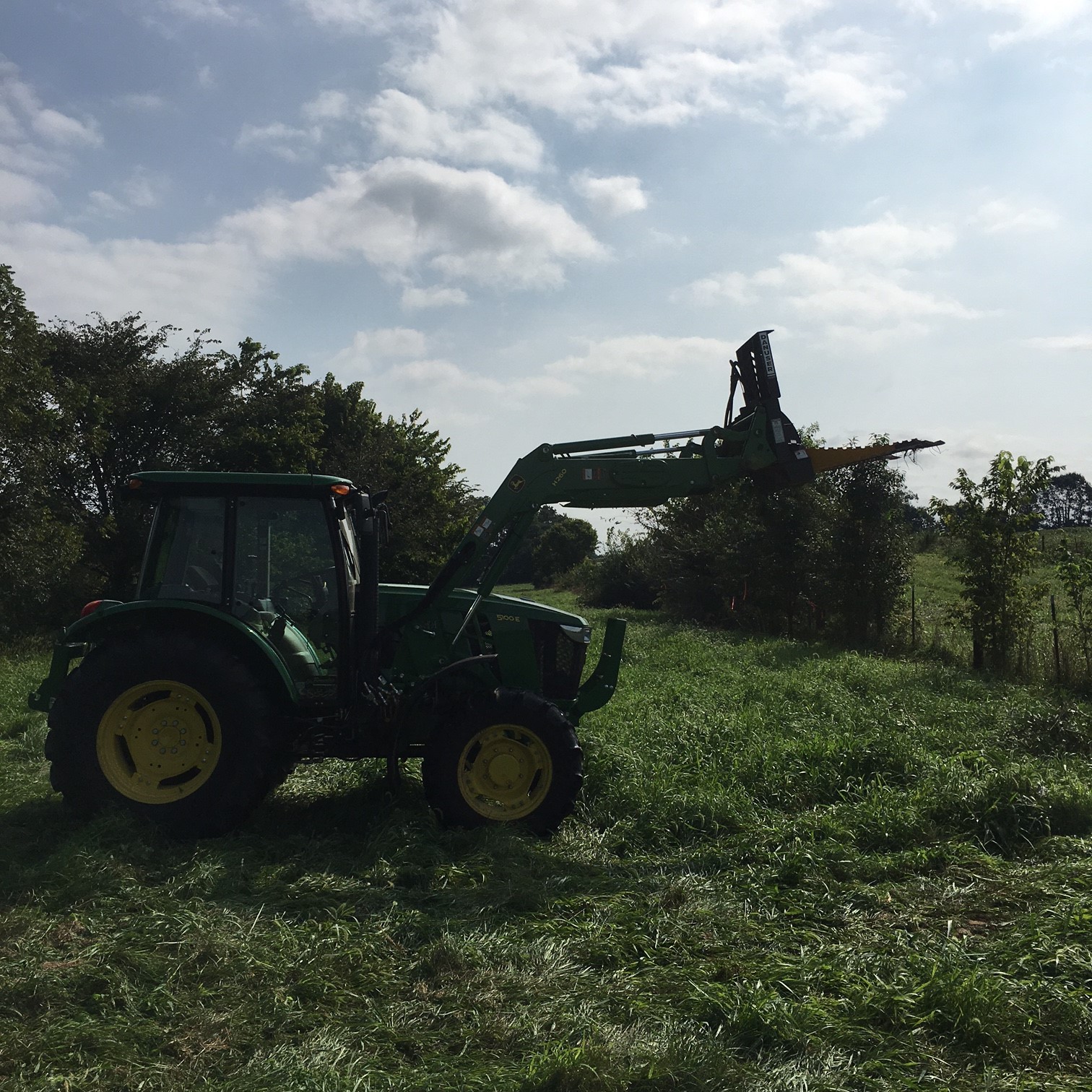

Mainly over the past month or so, I've worked on fence and fence row brush, removal. I have to say, one of the very best investments I have made is in the Danuser Intimidator. It has absolutely made fence, tree, and brush removal a breeze. Combined with my new MASSIVE root grapple, and I've been able to move about anything on my property I have set a mind to.
Pulling fence with the Intimidator is straight forward and easy. I or my wife, cuts wire about every 3 to 5 posts. All strands are cut. I will pull post 1, 2, 4, and 5 and drop them on the ground. I then to go post 3 and pull it, pulling it as I reverse. This pulls all other posts remaining attached, as well as all wire. This is key, because the wire is the hard thing to deal with for me. Leaving the wire attached to several posts keeps it manageable and together. The fence consists of a mix of woven wire with a barbed wire strand along the top. But there are also MANY patches consisting of heavy guage 'panels' of 4x8-10' welded wire, intermixed. Given that this will all be new pastures for horses, I have to insure that every piece of wire is picked up and removed. I've done my best, but intermittently, I'll find a piece laying about. Luckily, the wire is mostly old and fragile, and the barbed wire is about 3-shakes from total rusty dirt as it is. I had multiple internal fences within the property. They are all gone now. My peripheral fence is of the same 'model' ie 50yo woven/barbed/panel patched fence. It is about 2miles circumference. The internal fence was approximately a mile or so, broken up into sections.

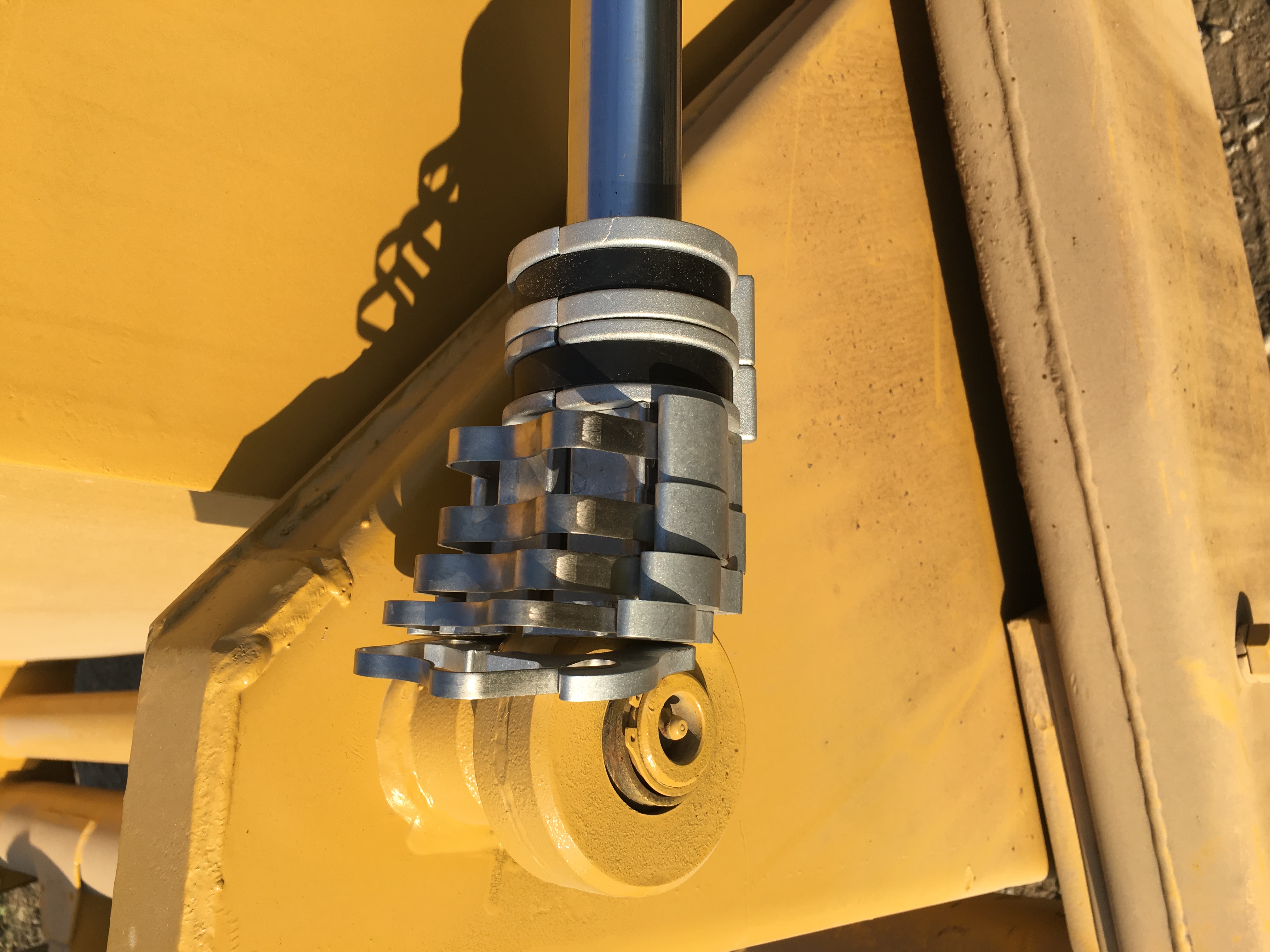

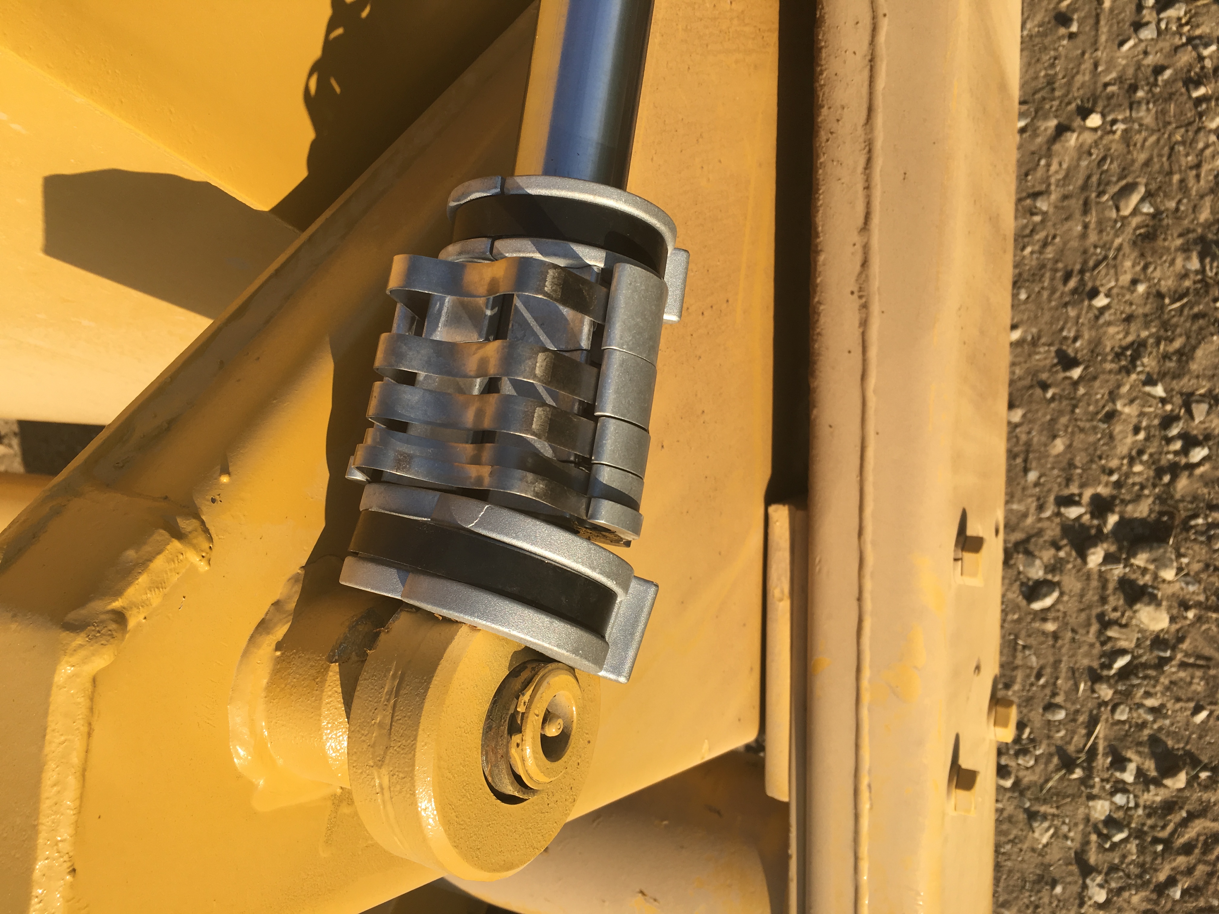

This 5100e 100hp MFWD pulls this 6.5cu yd dirtpan just fine. As long as I don't jam the blade deep in the ground too quickly, which is unfortunately easy to do. I purchased 2 different types of hydraulic cylinder clip on stops, neither of which worked for me.
The pan pulls easily and dumps/spreads extremely well.
