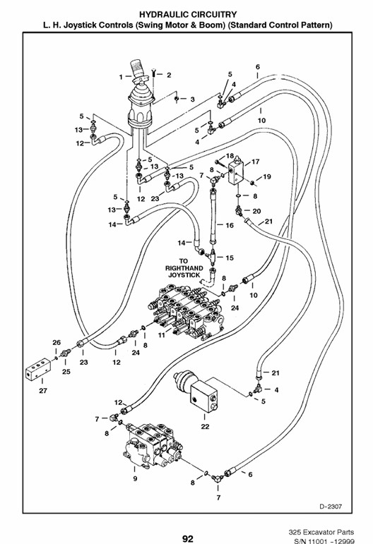

Looking at the schematic the pilot signal line is common for both joysticks. It also does not show any unloading valves for any of the three pumps.
Was this a sudden failure of all right hand functions or something that was intermittent and now is completely not working?
I would first start by confirming you have pilot pressure to the joystick then would check to see if getting pilot pressure to the valves. I am not sure if lock out safety valve has two separate supply ports one for each joystick of if there is a tee after the lockout. I believe pilot supply is approximately 360 PSI.

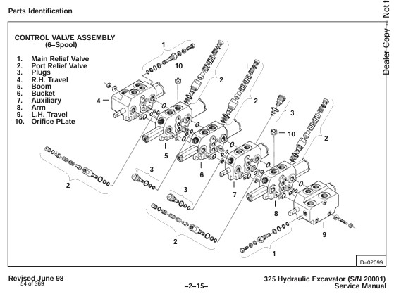

screen captures of the main 6 function valve bank and the left joystick showing pilot valve item 17. If I am looking at the schematic correctly the right travel would not be affected by the pilot valve operation.
thanks

You are correct the pilot pressure would have no effect on the travel function but item 1 the main relief being stuck open would unload the pump flow for all of the functions. Since sudden failure possible a spring broke, O-ring failed, if pilot operated relief could also have crud blocking pilot orifice.

We tested the pump pressure on pump 2 no pressure building, looks like a pump rebuild is in my future
   / Bobcat 325 Mini-ex hydraulic problem #20
Per the schematic pump 2 should have no effect on the right track but would affect the left track. Did both tracks stop working?
