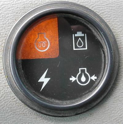

Hello everyone,
I have read through all of the BobCat postings and couldn't find a similar issue so I am hoping someone can shed some insight.
Basically, when the BobCat 328 starts it works fine. Has around 3100 hrs on it.
Usually I put the key in, turn it right and 3 lights come on (upper left (orange) and both right side ones (red)) along with a loud buzzing noise. Then it turns over and away I go.
Every once in awhile, when I go to start it, I turn the key right, I only get 2 red lights (bobcat-key-right.jpg), the upper left orange light does not come on, and then when I go to turn it over, it makes a rapid clicking noise, but the engine won't start.
To ensure the left upper light still works I turn the key left (bobcat-key-left.jpg) and it comes on.

You say voltage at terminals is fine. What was it? If not 12.5v or more it is low. Dropping to 3.5v is either a very extreme load or battery does not have any reserve amperage. First to check would be remove battery and have it load tested. Any auto parts/battery retailer will do this at no charge for you.
The orange light is the glow plug indicator. Key to left is manual engagement of glow plugs. Not sure if the your 328 has auto pre-heat, but if it does the glow plug light will not come on if the engine temp is already hot enough. This is usually around 90 degrees.

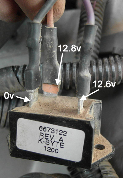

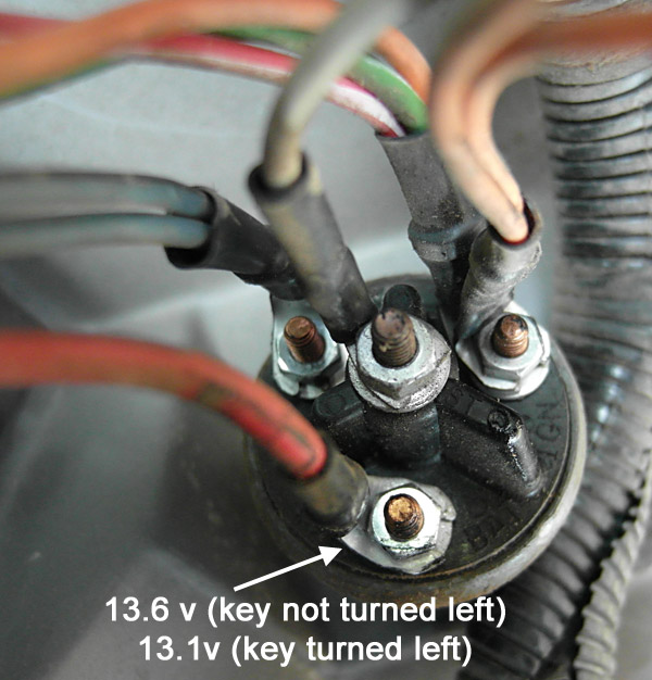

Note: I think the main battery is a little low so for all of the tests I am jumping my JD tractor battery to the main starter solenoid and the engine body. This will hopefully eliminate any issues with the battery or the battery cables.
I removed the cover to the starter console and tested the voltage to the ignition switch, it shows 13.6v when the key is in but not turned on. When the key is turned right, 1 position, it then reads 13.2v.
The other item I voltage tested is I think the starter/ignition relay(?). It is coming off of the ignition set of wires. The purple contact reads 12.6v, the orange reads 12.8v and the black reads 0v (see photos).
So, I am not sure where to go from here. I don't think the ignition switch is the issue and I am not sure about the relay, if that in fact is what it is.
The started solenoid seems to be engaging, but with the rapid clicking noise I am guessing it doesn't have enough power to start the starter?

   / BobCat 328 won't turn over #7
Check the voltage at the center (top) post on the switch, marked ST with switched turned completely to right for cranking. This is the power to the starter & glow plug relay.
That relay pictured is a timer, relay combination for the fuel solenoid and is activated when switch in normal run postion.
The glow plug and starter relays are part of the engine harness, will be in the engine or side compartment.
Ok, I have tested the voltage on the ignition switch (center post) turned completely to right, it reads 6.5-7v, not so good I would guess. This would indicate that the ignition switch is bad.

   / BobCat 328 won't turn over #9
Those ignition/starter interlock relays are known to go bad for no good reason. They are around $50 as I recall.
