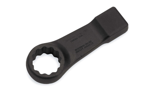

not sure a heat gun will do much, any way you look at it they nut and fitting needs to come off, its a possibility the nut was tightened so much it fractured the elbow, the issue with the way you used the impact its not fully acting on the nut as it needs to, can you get a hammer wrench in? they are heavy short wrenches designed to be hit with a hammer, with the pipe off the elbow you mag be able to use a ring wrench, the dealer has all the tools, we made lots over the years fixing the machines
if you have the electronic service manual it will list the wrenches used

I thought about the impact wrench last night and also thought it wasn't working properly, being that it was offset. If I could get the elbow off then I could get a socket on the jam nut and use the impact properly but I can't get the elbow to break free. I'm going to see if I can get a box wrench over the elbow and onto the nut. If so, then I might be able to get a second open end wrench on the elbow and try turning both at the same time, with a little help from my SIL. Thanks for the tip. I'll also see if I can find the wrenches you mention, in my expired service manual. I might be able to see it in the parts that aren't whited out.
   / Bobcat 763 Help #54

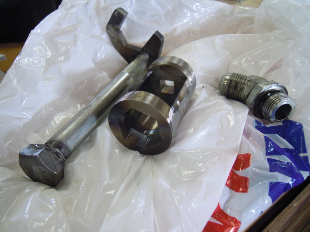

I just ordered the fitting and o rings from the Bobcat dealer. They didn't have them in stock and it's not cheap at $40 but at least it should be the right part and I will have it on hand when I get the old one off.
   / Bobcat 763 Help
#59
FINALLY!!!!.
The Bobcat dealer called back and suggested I get the part from a hydraulic supply place close to their location because they would have it in stock and for less money. They were right, the fitting was only $7. In the end I had to make another special tool to get the fitting off. Even with this it was darn near impossible to get the special socket over the end of the fitting and onto the jam nut. There were too many things in the way, the fuel fill hose, the fuel tank vent hose and the mounting brackets for the hydraulic pump, to name a few. I eventually managed to get the socket onto the jam nut and then get the impact wrench onto the end of the socket but it was still hard to get the jam nut to break. At first I thought the impact wasn't going to do the job either but after about 5 seconds it started to move. What a major PITA this was but my stubbornness paid off.
Here is a pic of the special tools I made and the fitting after removal. Turns out the O ring was damaged and the jam nut was jammed so tight that it wouldn't turn by itself. The jam nut and fitting turned together.

Nice job making that socket. Did you cut the hex with a torch? I've done that a few times. Glad you got it out.
