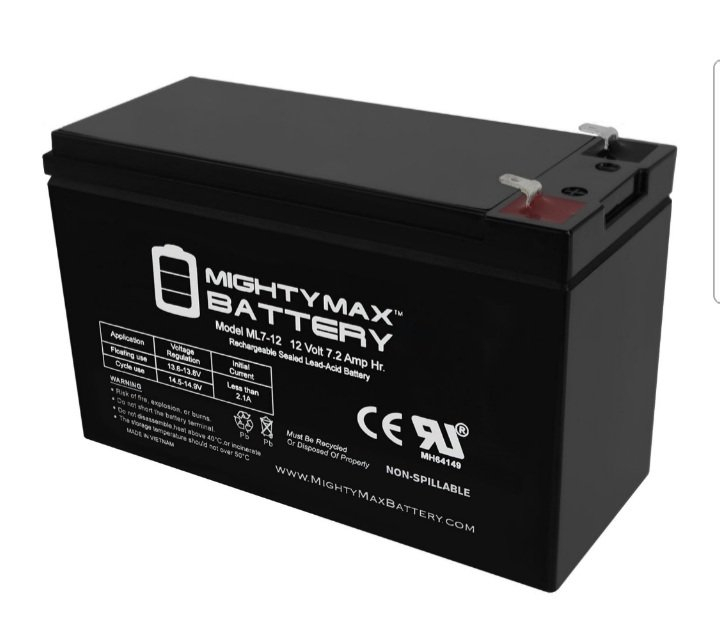

There's another easy way to do it. The GPS could have it's own separate battery. You could either charge it from Bobcat power through an isolation diode (1N5408 or equivalent) to a rechargeable 12v battery (this 7AH would work), or that battery could be trickle charged by small solar panel or ac charger.
That would eliminate parasitic Bobcat drain while supplying GPS with power..
Parts would be about $25.
