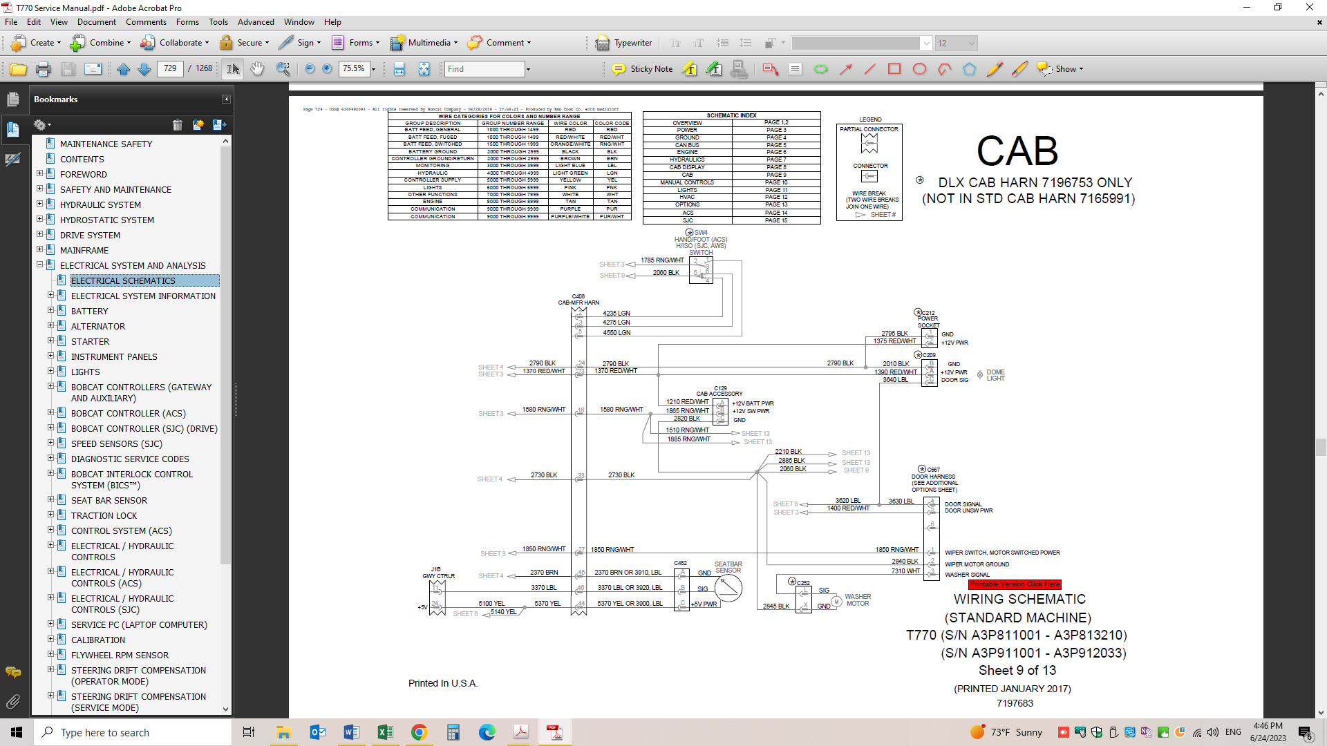

I don't have the schematic for the forestry door but this shows the standard door wiring. So at least you know where to start.
