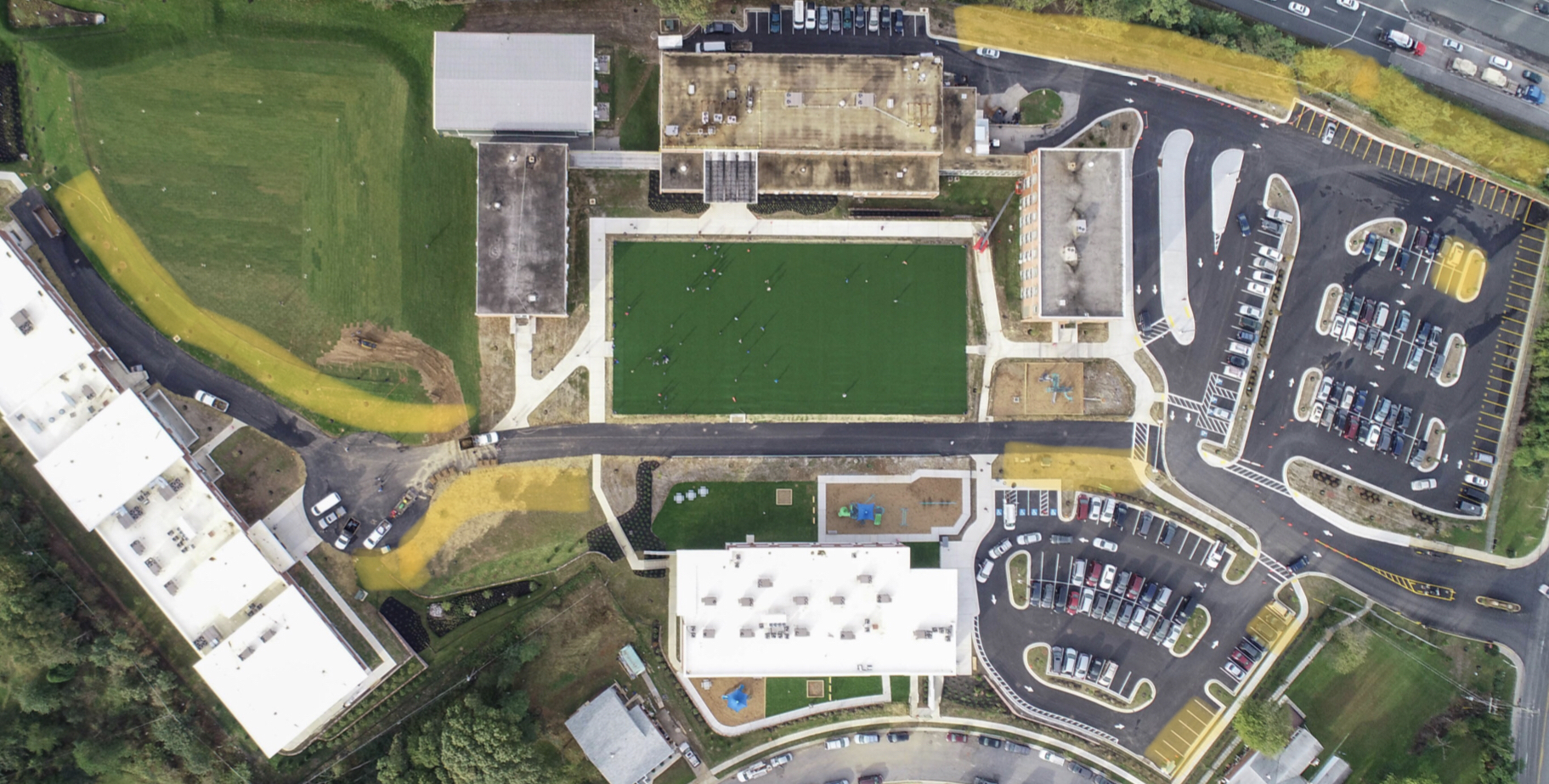

The SS has brute strength in its favor. The skid steer has forward visibility in its favor. The tractor has 360 visibility in its favor. How far are you traveling with the snow? A SS isn稚 a good tool for traveling any distances.
I知 attaching a picture of the lot again. I marked areas I can stack snow in yellow.
