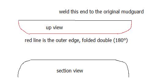

Anyways, the rear fenders are not just shells but full wings, they are made of a vertical shell piece, which is basically intact (the pieces that have rust bellies are flat, so there is no special technique involved in welding straight flat patches into it) and an arched piece that covers the wheel.
On the rear edge it is rusted. You can think of it as a motorcycle mudguard with a flat piece in the middle, and radii on the sides. Next to that, the very outer tips are bent 180 degrees so there is no sharp edge.
The main thing is, how do i keep the preformed strip of metal in shape, when i hammer the folded edge onto it ? or should i make the folded edge first, and then bend the entire piece into the transverse direction of the mudguard ?

/ bodywork sheetmetal work ? #7
if the folds are flat, I would make that first then form the fender.
if you can clamp the form between two pieces of steel say at least 3/8' and bevel the inside piece of steel you could start hammering it over the beveled edge

/ bodywork sheetmetal work ? #9
Their exists a tool calles a shrinker that does what you want.
It is like two hardened steel jaws that grab and pull the metal thereby creating a rounded corner in a folded piece of flat sheet.
You'd basically make the major fold over and then using the shrinker pull the metal to create the rounded corners in the folded metal.
I had one and the learning curve was easy.
Worked best on aluminum and brass but OK on steel.

with a shrinker you should leave extra metal to trim off the jaw marks
