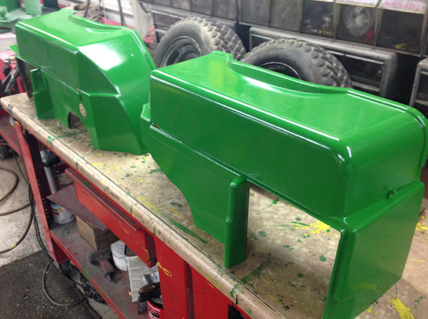

Todays progress shows the rear frame section looking much better. It was rusted in half in one spot. I cut out most of the old steel and welded in new. But there is still some deep pits in spots . 80% of the wiring is missing so i will have to rewire everything too. It had no battery. Even the battery strap was all rust. Also you can see the rear engine hood now cut in half as I will redesign it to fit the new wider wheelbase. I will also build it up and trim the front for clearance when the frame turns not to rub on the back of the seat. Today I am working on the left side panel and left side pair of new lights. I'm guessing one more week until the first test drive with the front blade attached. :dance1: aaarearframe.jpg

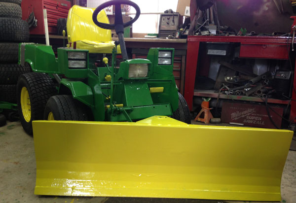

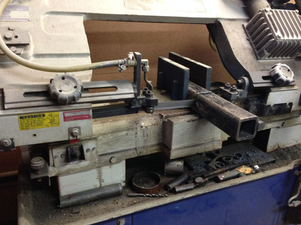

Todays first photo shows me cutting some 2 in. square tubing to extend the frame 5 in. because of the larger tires. Also the first picture showing the 54in. blade . I decided to build new mounts for this blade I had on the walk behind snowplow last winter. That plow originally started out on one of my jd 455 tractors. aaablade1.jpg

Holy crap dude, you work fast! And it looks great too, so that is even more annoying! ;)

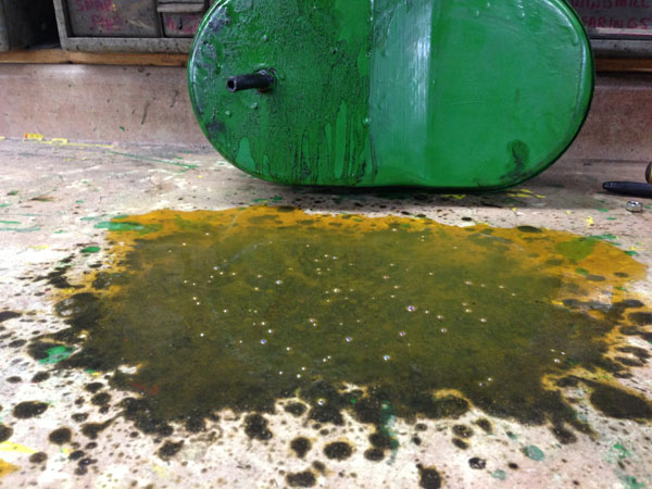

Today the picture shows the muddy , gritty crap still coming out of the gas tank. After five years of moisture inside it wasn't pretty. But each time I shake it with the 30 or so nuts inside with the gas/diesel solution it gets better. The first time it was thick, black goo so I am pleased it is looking much better. :thumbsup:aaagastankmud.jpg

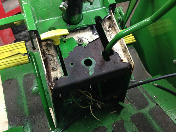

Today I decided to move to the dash area . The fellows grandson had ripped the switches out and the throttle control was rusted tight . My new design I decided to put in a amp guage. :thumbsup:aaadash2.jpg

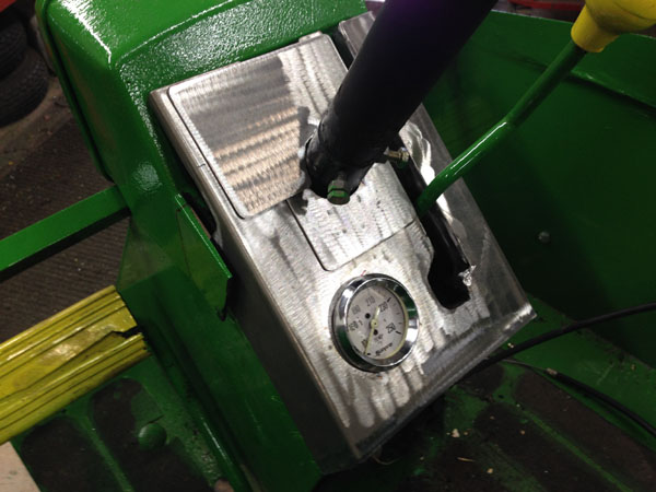

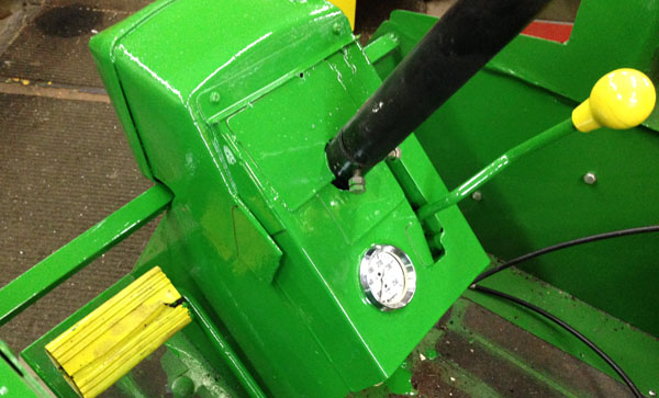

aaapainteddash.jpgI got the new dash painted and it looks much better.:thumbsup:
