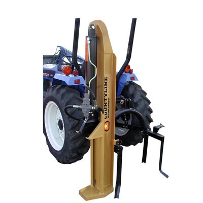

Thanks for the advise. That does actually make very good sense. I was looking at PTO pumps that produce around 21gpm, however I m not sure if you have to use a separate hydraulics reservoir, or if you can connect directly to the splitter, from the pto pump.The other side issue I have, is I am so unsure about weather or not I want to even tamper with the existing hydraulic set up that I have. I is a closed system, and I worry about opening up this system that has been running flawlessly for years, and introduce foreign matter. Having that said, It would also be really nice to save about $350+ on the prie or PTO pump, and use my existing hydraulics. I have been looking at the country line 3 point splitter at TSC, and it appears to be a beast. I also looked at one I liked at northern tool, and their splitter cannot handle over 6.6 gpm, so that would be out of the question if I use a pto with a higher flow rate. I know that most of the rates that they provide are at 550rmp, but will they operate safely at higher pto speeds? I have a three speed pto, that was US compliant, and 550 is the slowest. I didn't know if I ran one of these PTO pumps at say, 1000rpm, will I have faster returns on the splitter, and greater ram force, or could it damage the unit?

The manual for the County Line version shows a 28.3 second cycle time, at 5 GPM. That would work out to a 47.2 second cycle at 3 GPM. The tractor only outputs 3 GPM at full throttle, so at reduced throttle settings it will go even slower than that.
I think this is why the standalone units use 2 stage pumps. Prince shows their PTO pumps being specified to run at 110% rated speed. I imagine they would run fine at higher RPM, but the trouble would be your tractor can't supply the power to run that volume of flow at high pressures. Prince shows their 7.1 GPM pump takes 11.9 hp to run at 2000 PSI, probably all the tractor could do. That would get cycle times down to 20-ish seconds.
Even the largest 2 stage pump sold at surplus center puts out under 3 GPM at your 1185 PTO RPM on the high pressure side. Being able to run it at the rated 3600 RPM would give 7/28 GPM high/low.
For my money, I would probably just buy a gas powered version if looking at new units. The convenience of speed would be worth it to me, but that may not be a deciding factor for you. By the time you source the $520 pump and torque arm, you have equalled the cost of a more powerful, faster splitter.

Thanks so much for the photo! That block would work perfectly, I just have to find one now. Thank you everyone else for the great information, and all of the help. My wife is pretty dead set on getting a 3 point splitter, probably her idea of justifying the tractor. The other question I had, is if I cannot find a block, and I hope that I can *fingers crossed*, I will try to buy a pto hydraulic pump, but how does that work with a splitter, do I have to buy a separate reservoir? If so, that seems pretty expensive, the look like they run about $180 and up for the reservoir alone, and the pump is about $325 plus shipping. I may jest be better off doing what I don't want to, and cutting into the high pressure line. I think that due to the tractor only operating at 15HP, and at 1185 RPM at the rear PTO, I will probably go with the 13 ton splitter from Northern Tool. I want the wood splitter from Tractor Supply, but it may be too large for the tractor. 284 International had very good information about the capabilities. The splitter from Northern tool has very good ratings, and is $100 less. Anyways, thanks again for all the help!

Using tractor hydraulics will be slow. I've hooked up several splitters for people that way. If you use a pto pump you will need a reservoir. You could us e the tractor rearend as your reservoir. I would only do that if you were using a universal /hydraulic transmission fluid in the tractor.
