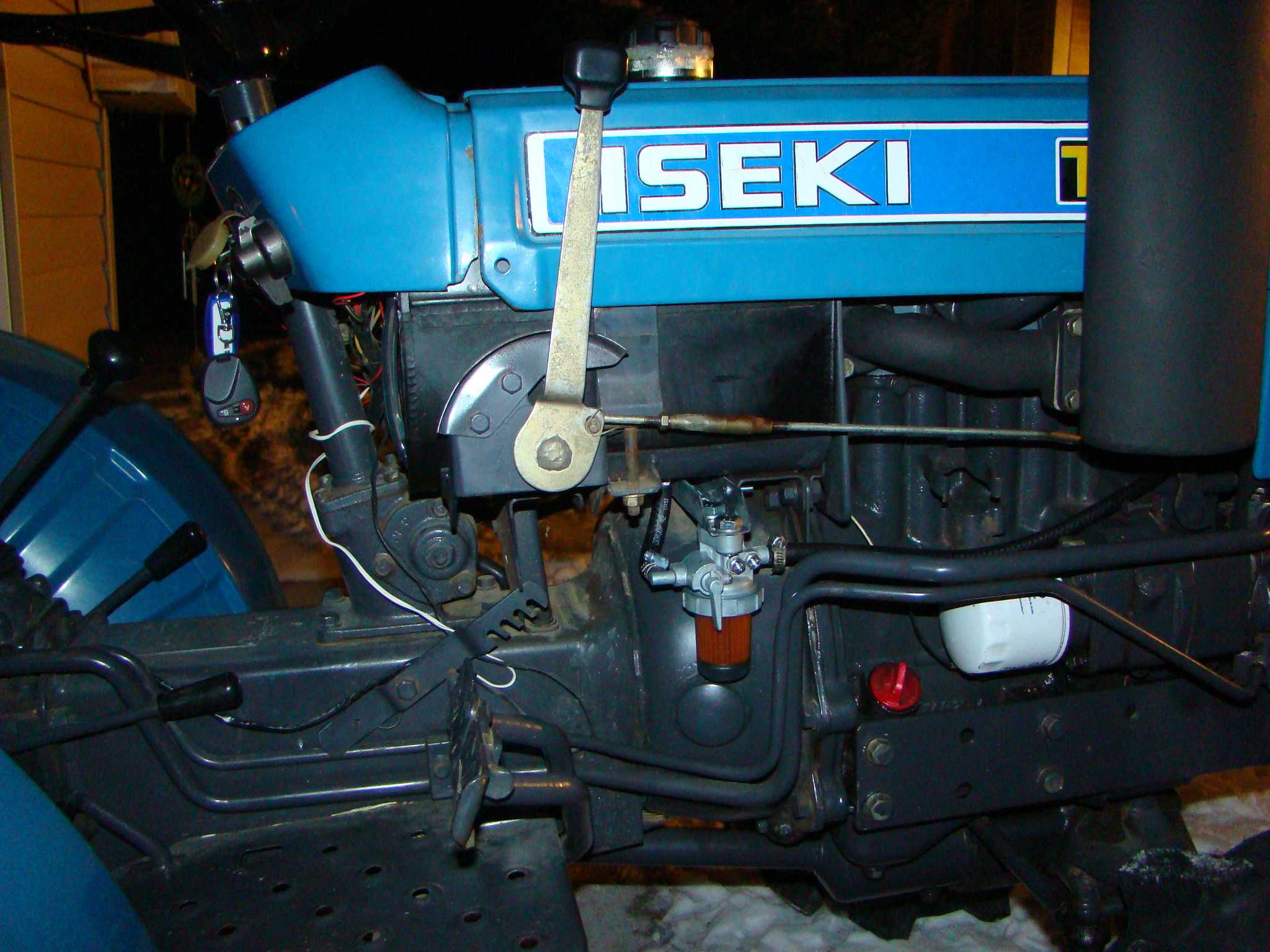

The fuel filter you have looks great, but sometime down the road though you may want to install the replaceable element kind (it looks like the one you have is not element-replaceable) like in the attached picture although price-wise you can't beat what you have. This kind allows easier replacement, a shutoff, and bleeder screws. I've been getting them from Leonard Scheaffer for about $50/ea. The replacement filter elements can be had from Napa for about $10 (Napa P/N 3264). I can't find another source for the housings though but you should only need to buy this once. Be careful of the type of filter you install also as I've been told final filter elements for diesels have a finer filtering element than those for gasoline.

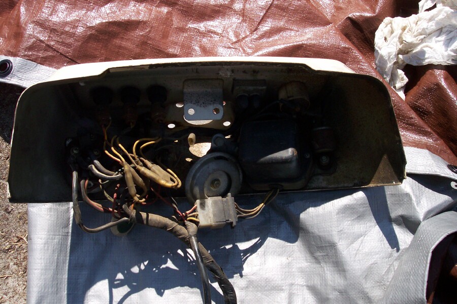

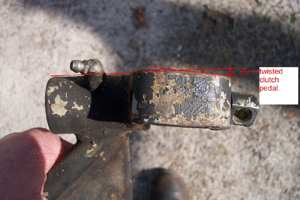

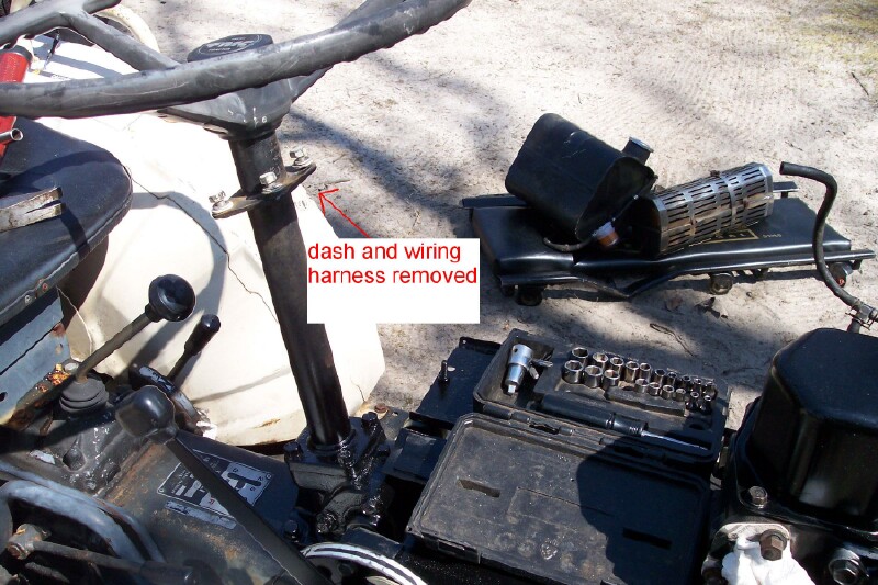

Thanks, It was a big thrill to start her up for the first time.
On the video you can see that first try ended with a low
and under powered battery. I hooked up the charger to the battery
and 2nd try was a success. Today I removed the muffler because

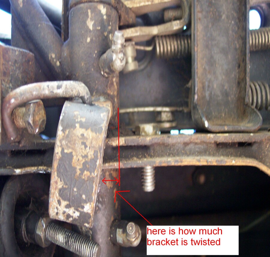

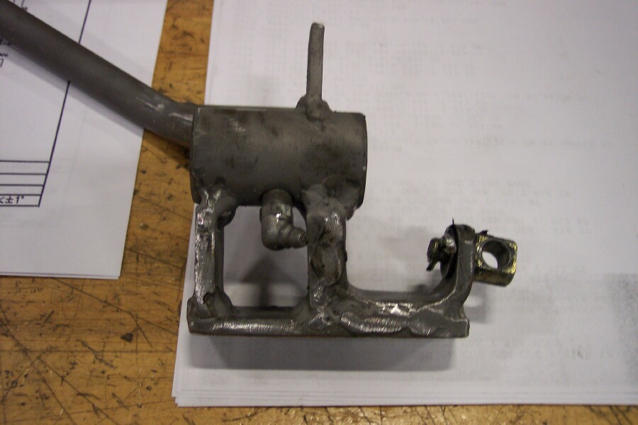

one of the flanges is broke and leaking. Tractor has a clutch
problem also. I found that the clutch pedal has a twist in the
bracket that attaches to the rod leading to the throw out bearing.
I removed the clutch pedal today to fix it. What a job
that is. I'm also not happy with the wiring harness so I removed
harness and dash to do some reworking.

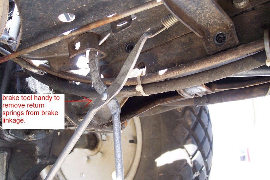

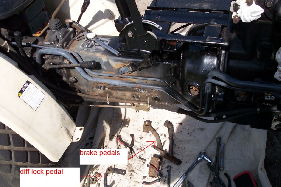

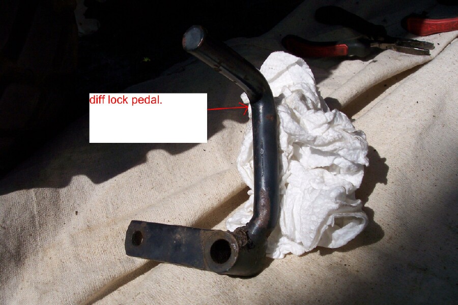

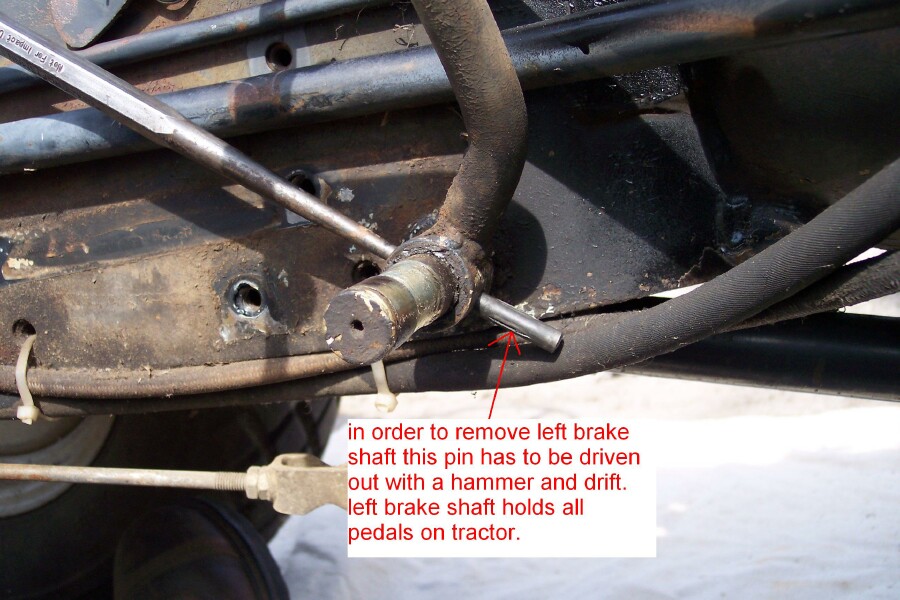

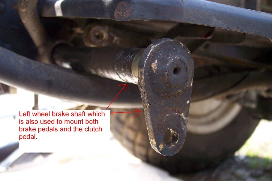

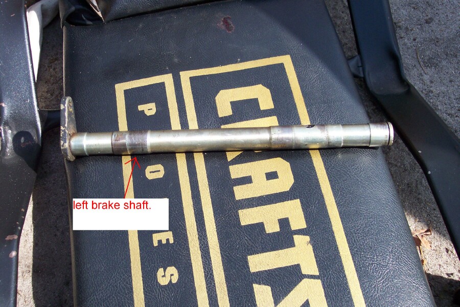

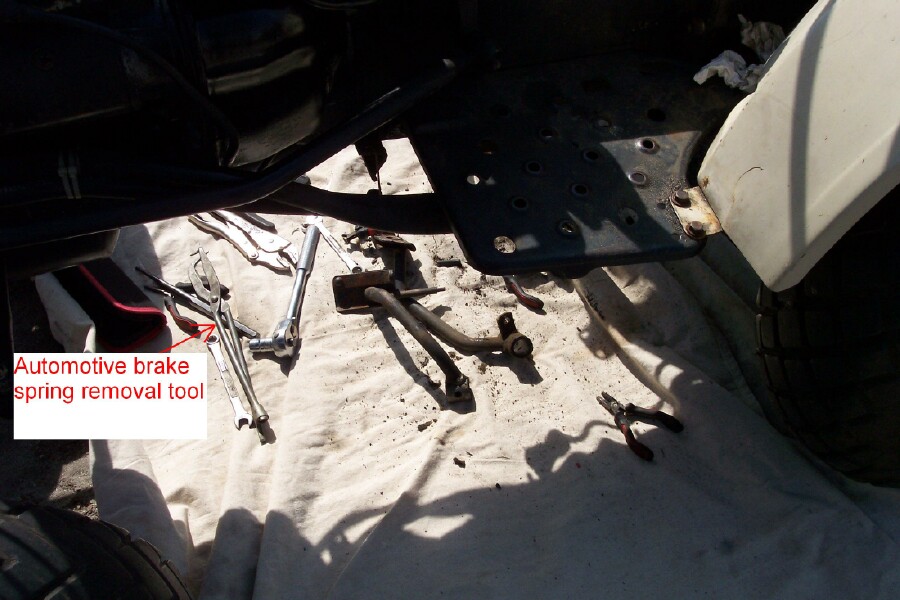

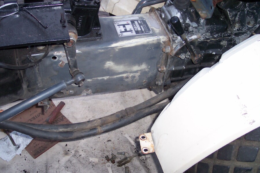

Here are a few pictures of the clutch pedal removal.
The right brake pedal is held onto the shaft with a snap ring.
The right pedal uses the shaft as a pivot point. The left
brake pedal is held onto the shaft with a 6mm pin which has to be driven out with a drift punch and hammer. ( what a pain in the @##$#) In order to remove the clutch pedal you have to pull the left brake shaft out the left side of the tractor. You have to remove the right foot board to drive the pin out of the left brake pedal. I removed the left foot board because I am also going to do some painting to tractor
frame while I have these parts off. There is also a few pictures of the modifications I made to the clutch pedal to reinforce the area
that twisted. there are several return springs attached
to all three pedals that could cause some pain if they were
to slip while you remove them. I found that an automotive
brake spring tool worked great in removing springs from tractor pedals.
You have to also remove the diff lock pedal to remove right foot board.

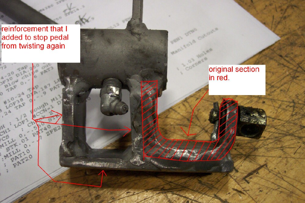

I just realized I didn't post the pictures of the clutch pedal
modifications I made to stop it from twisting
again. Here are also a few pictures of the frame
I've been sanding so I can do a repaint.
