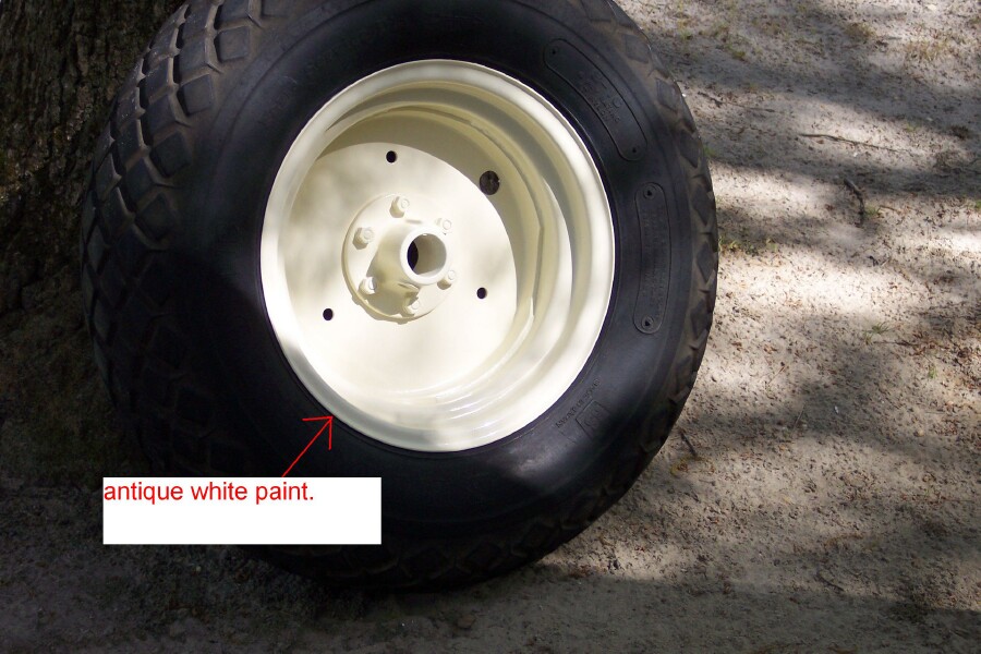

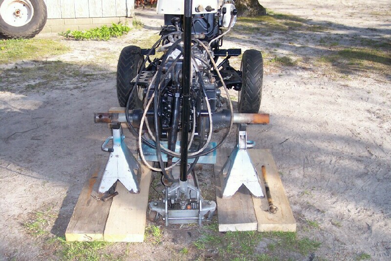

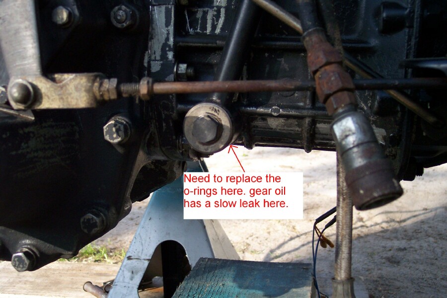

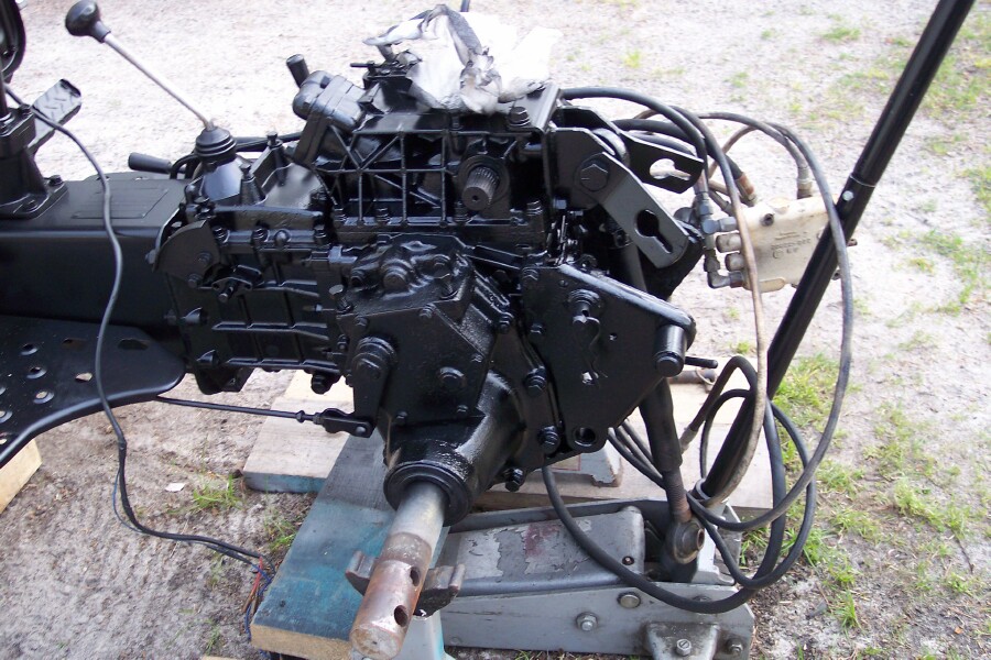

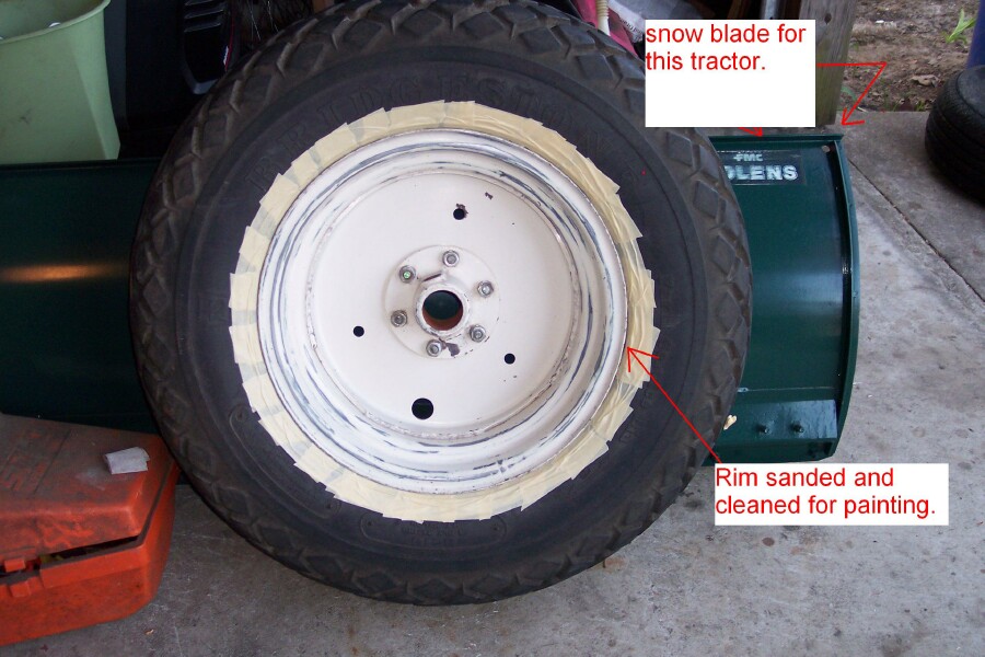

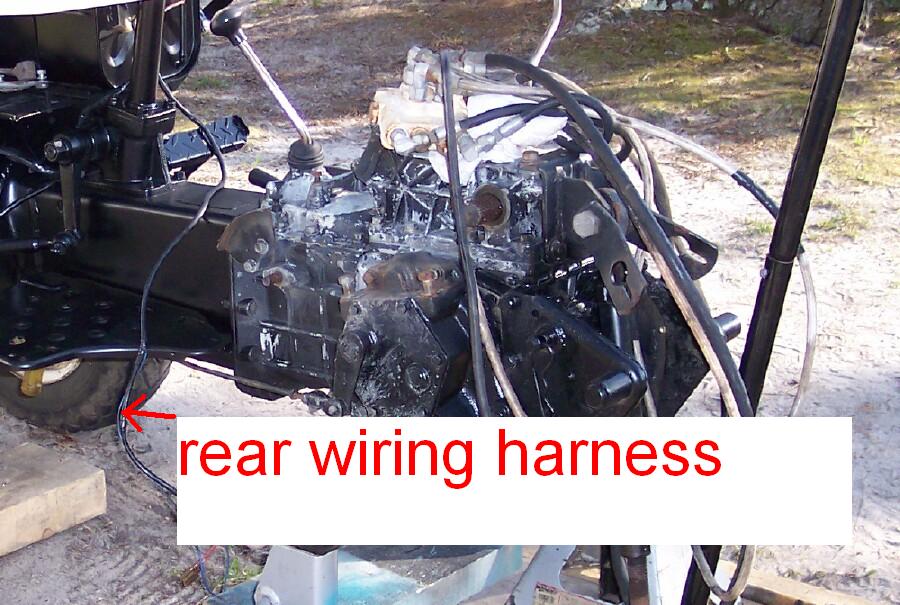

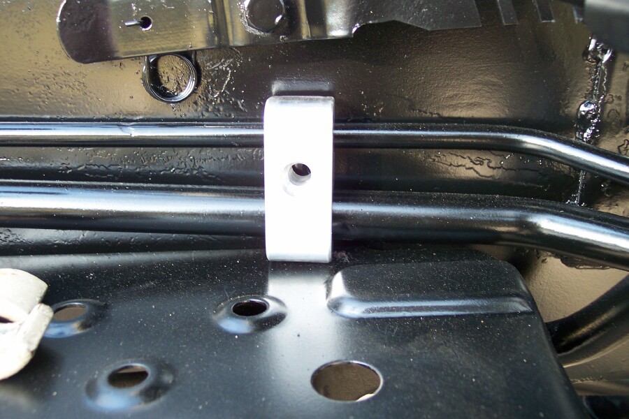

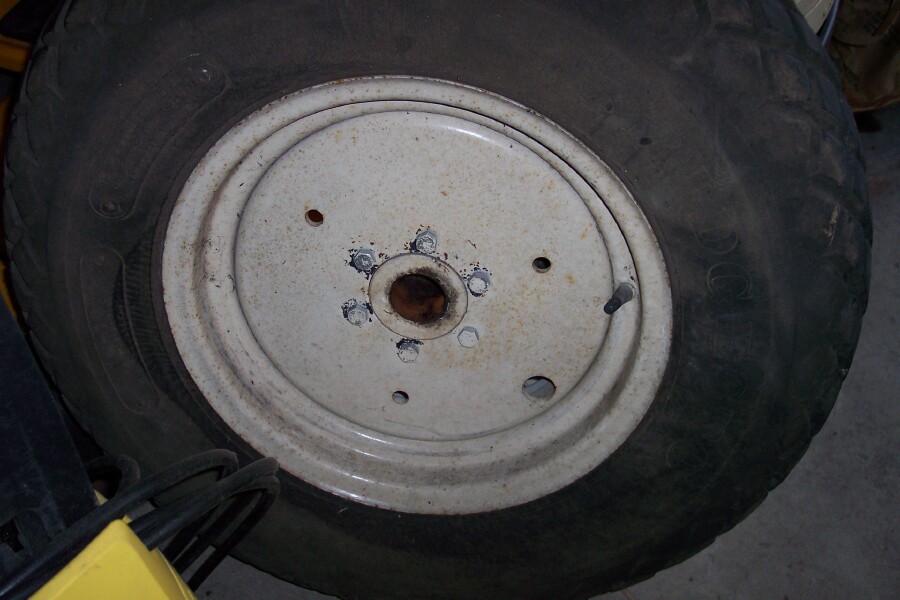

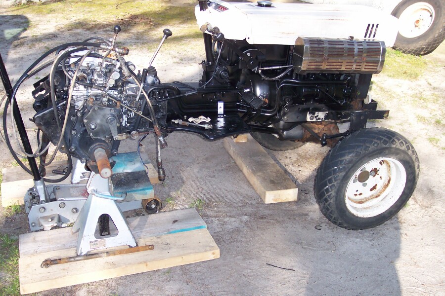

I had time on Saturday so I removed the fenders
and the wheels. I am going to take the fenders
to work so I can weld the cracks in both fenders.
The wheels I removed so I can paint the transmission
and differential sections of the tractor. I am also
going to repaint the wheels while I have them off.
I'm also going to change the transmission oil
at this time.

   / Bolens G154 / Iseki tx1300f #65
Looking good. One thing I've learned on the rims is they are highly susceptible to corrosion on the inside. If possible, pull the tires, clean, prime, and paint the insides of the rims also. They can be difficult to find in good shape. Avoid tubes if you can (ideally replace with new tubeless tires - might want to switch to ags if you do this but realize budgets come into play on these tractors). You may find the rims leak but a little welding can fix that or, if it's along the bead, some bead sealer. Good luck.

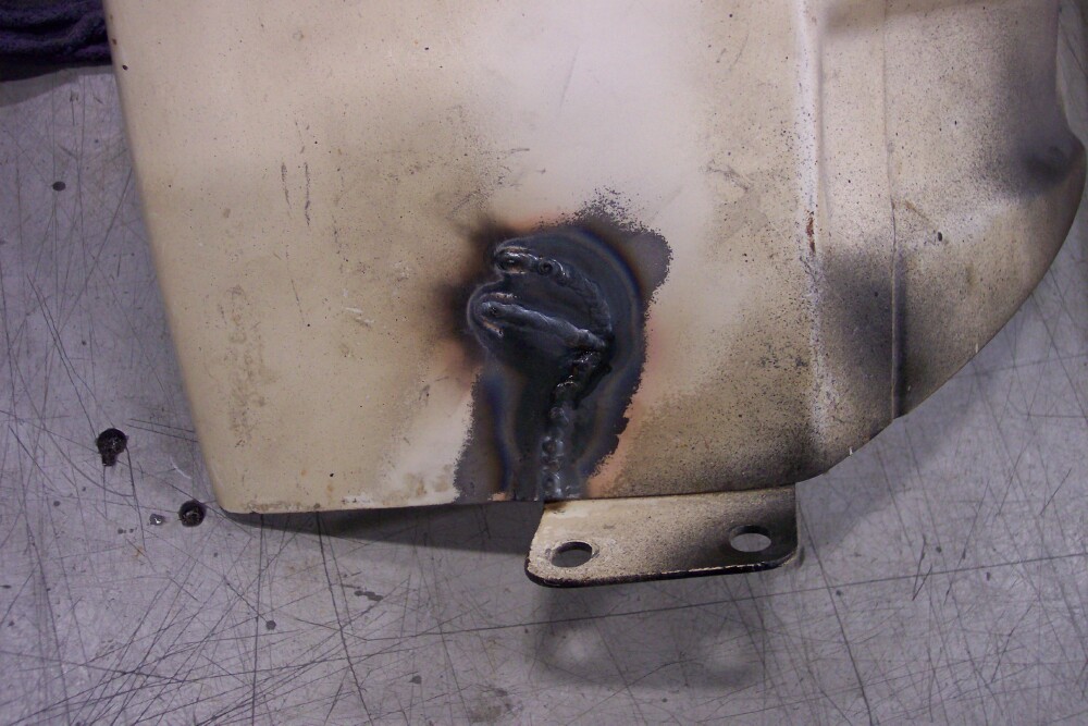

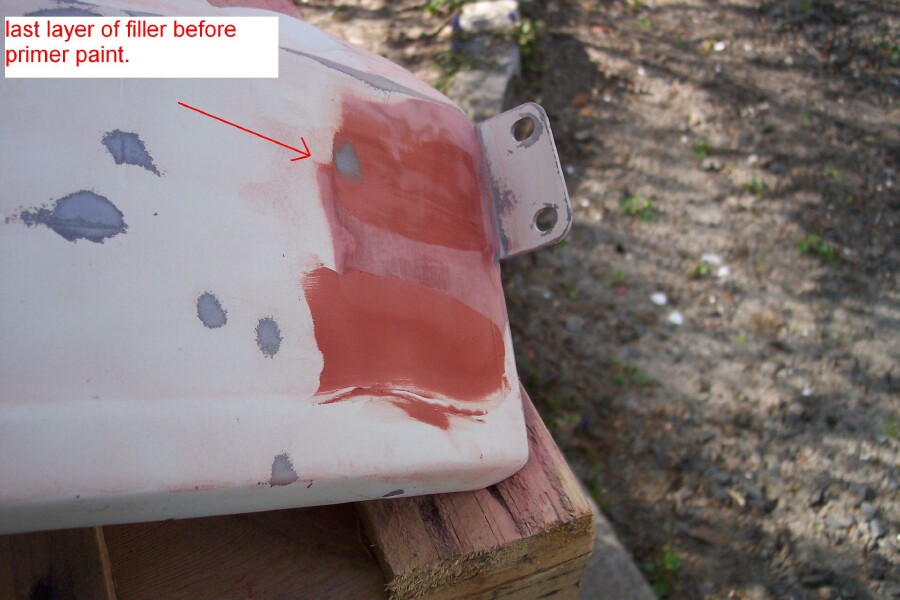

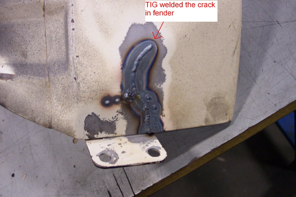

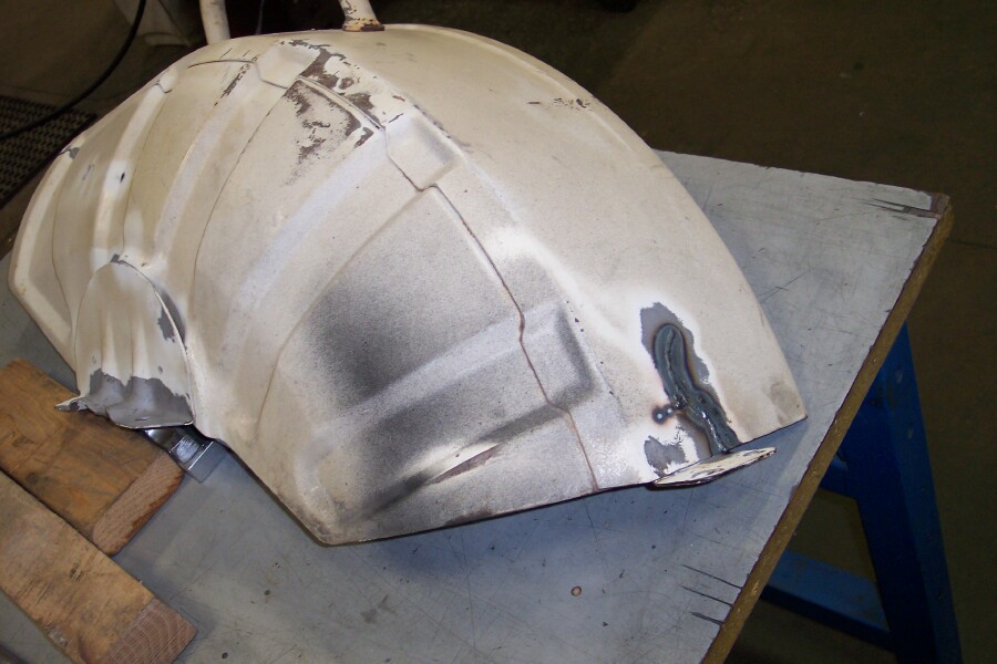

Here are a few pictures of the fenders. I welded the cracks in both fenders
and used some body filler to smooth them out. I put the blade back together
while I was waiting for the body filler to harden. I also finished painting the rear
of tractor.

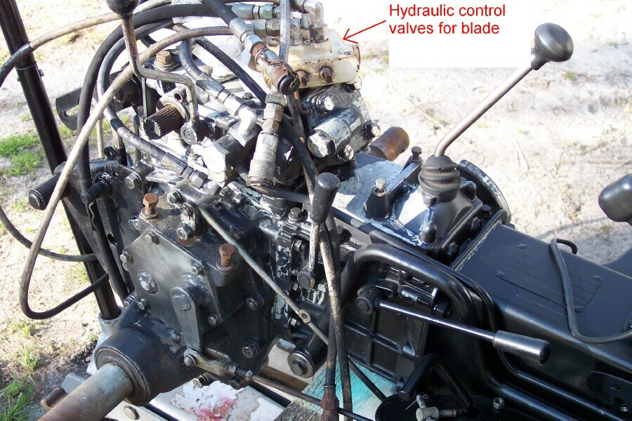

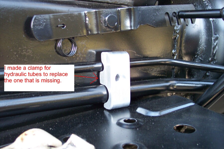

Here is a picture of the hydraulic hoses that are getting tired.
I will eventually have to replace them. I would like to
find more of the plugs / dust caps for the ends of the hoses.

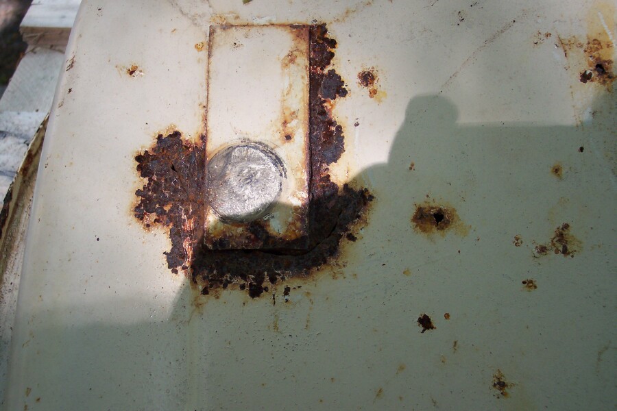

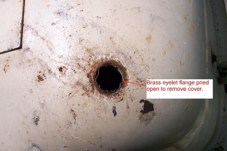

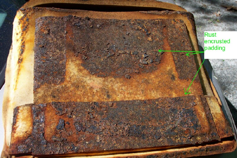

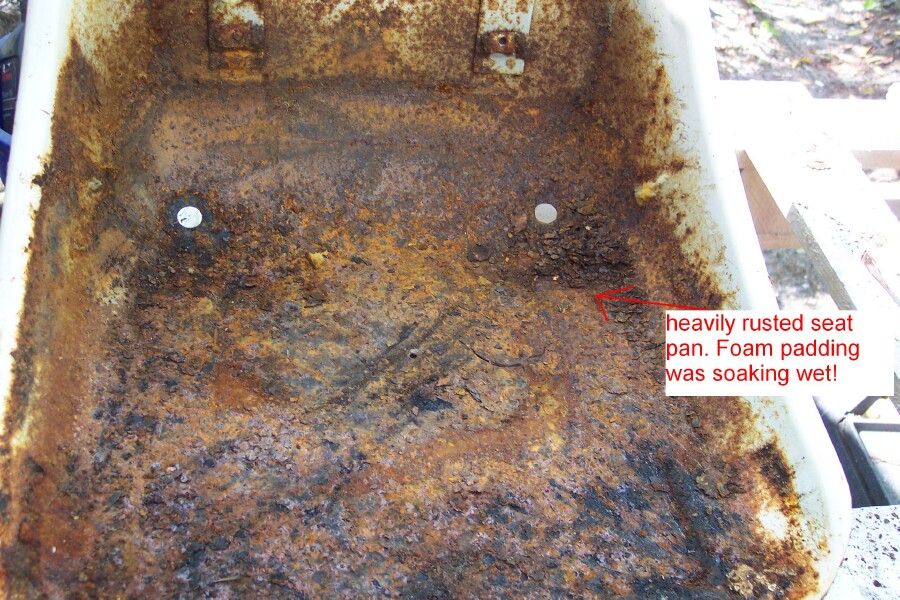

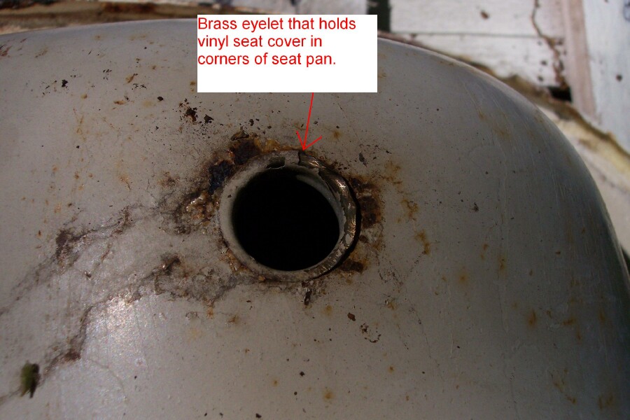

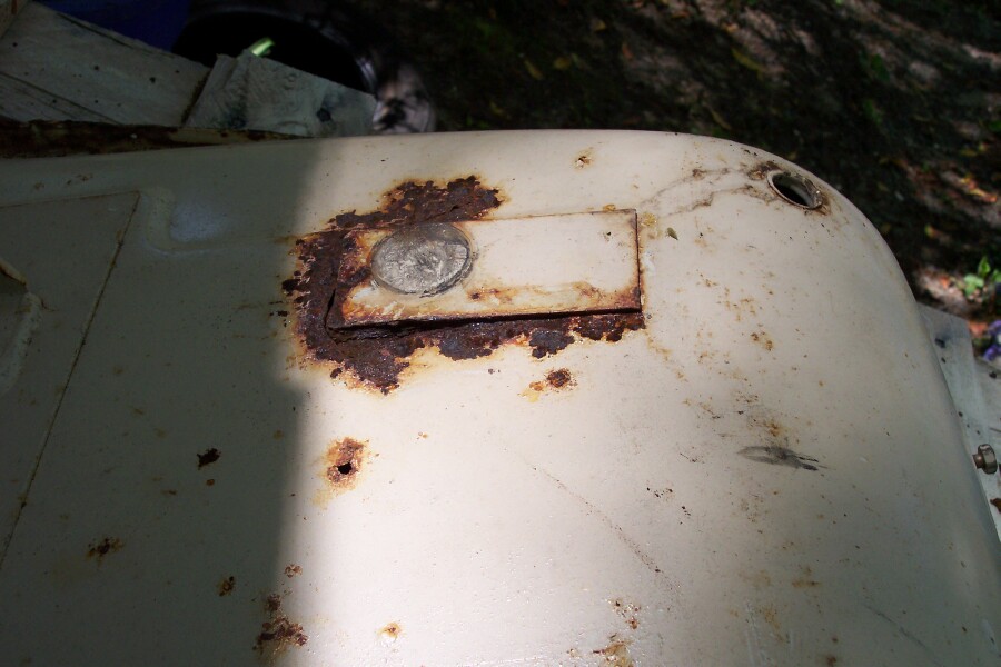

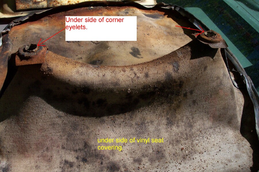

Started to work on the very rusty seat.
I removed the vinyl seat cover and found that the
foam padding under the cover was soaked with water.
I have kept the tractor covered with a large tarp
when I'm not working on it so that water has been
in the foam for years. I am sand blasting the pan
at work and after that I'm going to weld plates
on pan to cover the cracks and rust through. I need
to repair a tear in the vinyl also. Need to look
into that process. Here are a few pictures.
