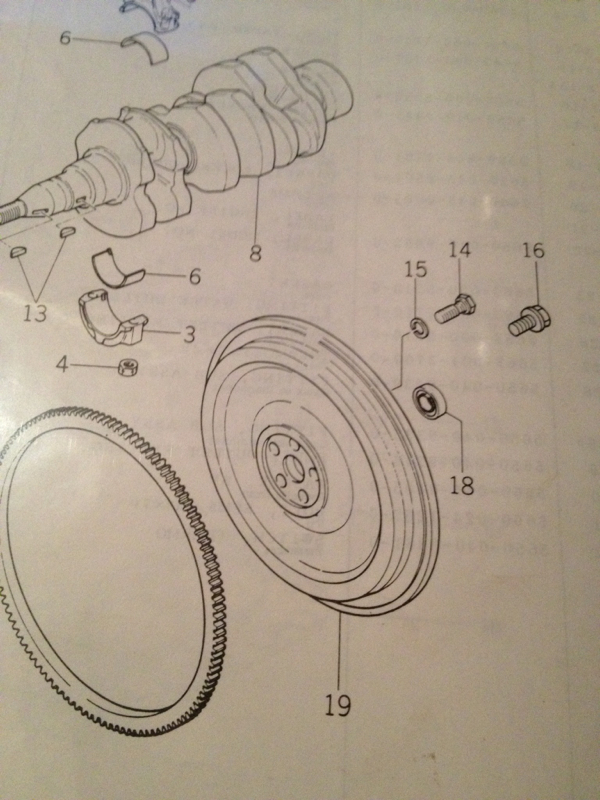

Thank you guys for all of the info, and the photos! It seems like all of our tractors are around the same age, and they all need clutchs. It must be a common issue when they get to be 20+ years old. I am looking to buy the clutch parts for my G154, do I need all of these parts? I wasn't sure if the throw out bearing was the same as the pilot bearing, or do I need both? Thanks!
   / Bolens Iseki diesel clutch woes #18

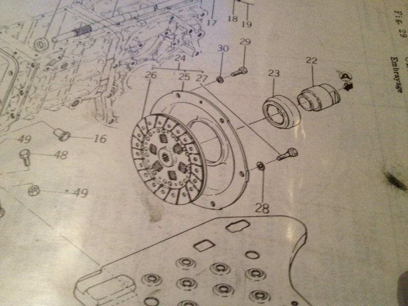

Hi
As i understand it, they are different. The pilot bearing is behind the flywheel, and the throwout bearing is larger. I bought them both, just incase. I want all parts close to me when i first open it up. Throwout is no. 23 on the drawing

Pilot is no.18 on the second pic, i think :)

   / Bolens Iseki diesel clutch woes #20
Second picture
