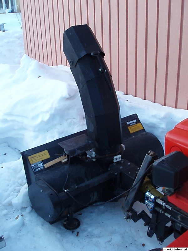

I also have 2 snowblowers for my little baby. One for front and one back. They are the same type, swedish monsters of 120 kg. Named Nymek sb1200.
