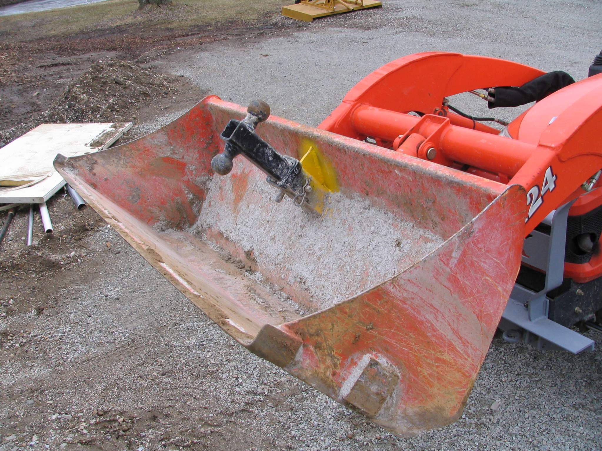

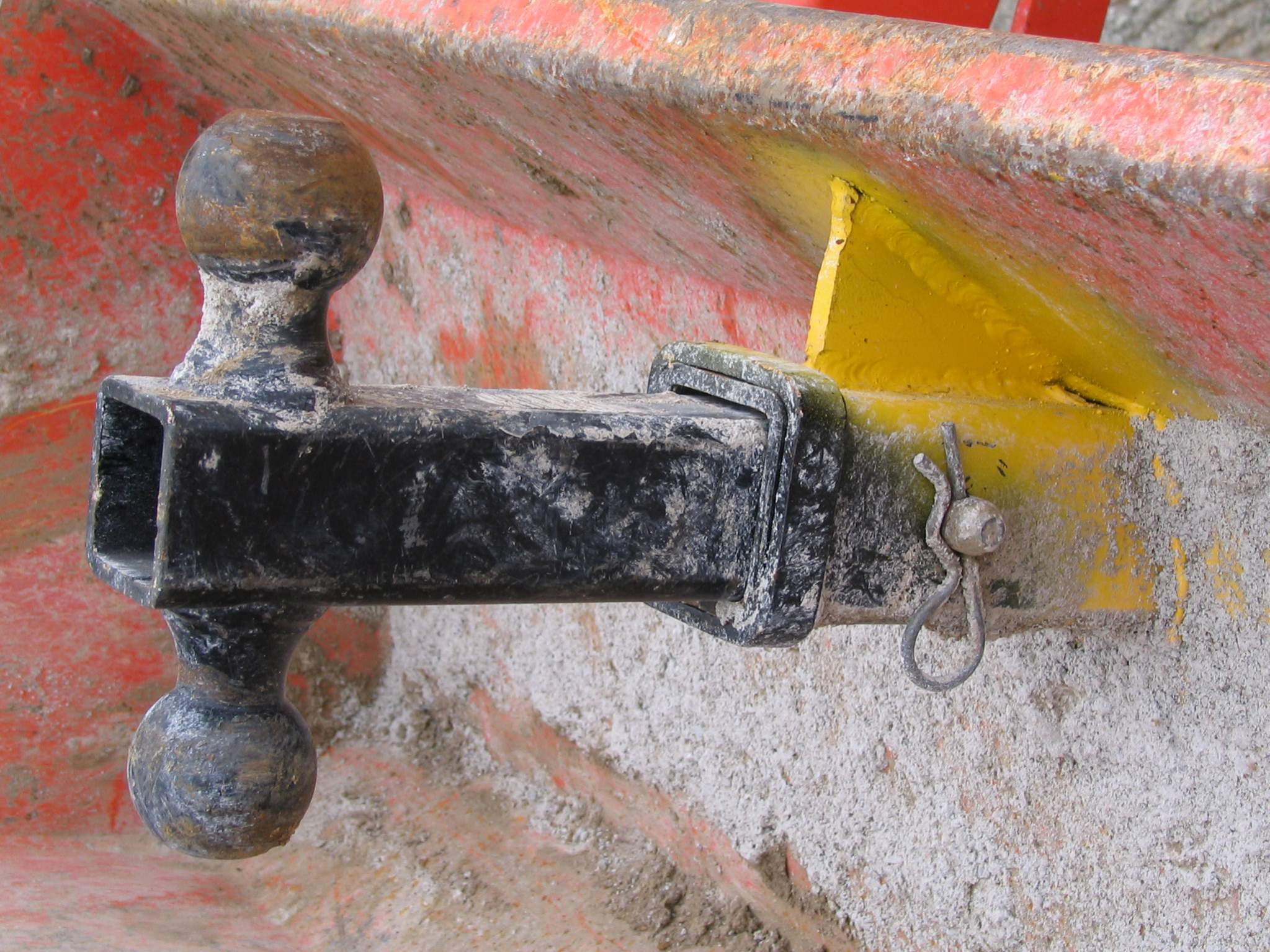

Bill- What's the top 'bar' made from? I'm guessing 1-1/2x3"x1/4 rect? And where did you get your weld-on hooks? Thanks! ~Scotty
   / Bolt on Bucket Hook and Receiver mount for JD2520 #12
Once I welded a hitch receiver on my FEL bucket, I never used the 3 pt. hitch to ever move a trailer. I'm sure you'll find your setup very useful. Great job!
If I bought I new tractor tomorrow, this is the first thing I would "add". If you move trailers around, this concept is a must have. I don't even bother flipping the double ball anymore ... I simply pick up every trailer with the 1 7/8 ball (unless I expect to have negative tongue weight)
Simply concept but VERY useful ....

Hi Scotty,
The steel tubing is 1.5" x 3" x 3/16 wall. This gives me a very stiff bucket support and good welding base.
I got the 5/16" weld on hooks off ebay but they are also usually at tractor dealers. Google "weld on chain hook" and they should pop up.
As BX mentions this is a very handy add on... I am using a drop insert in mine to move trailers around and plan to build a boom lift for another project.
Bill

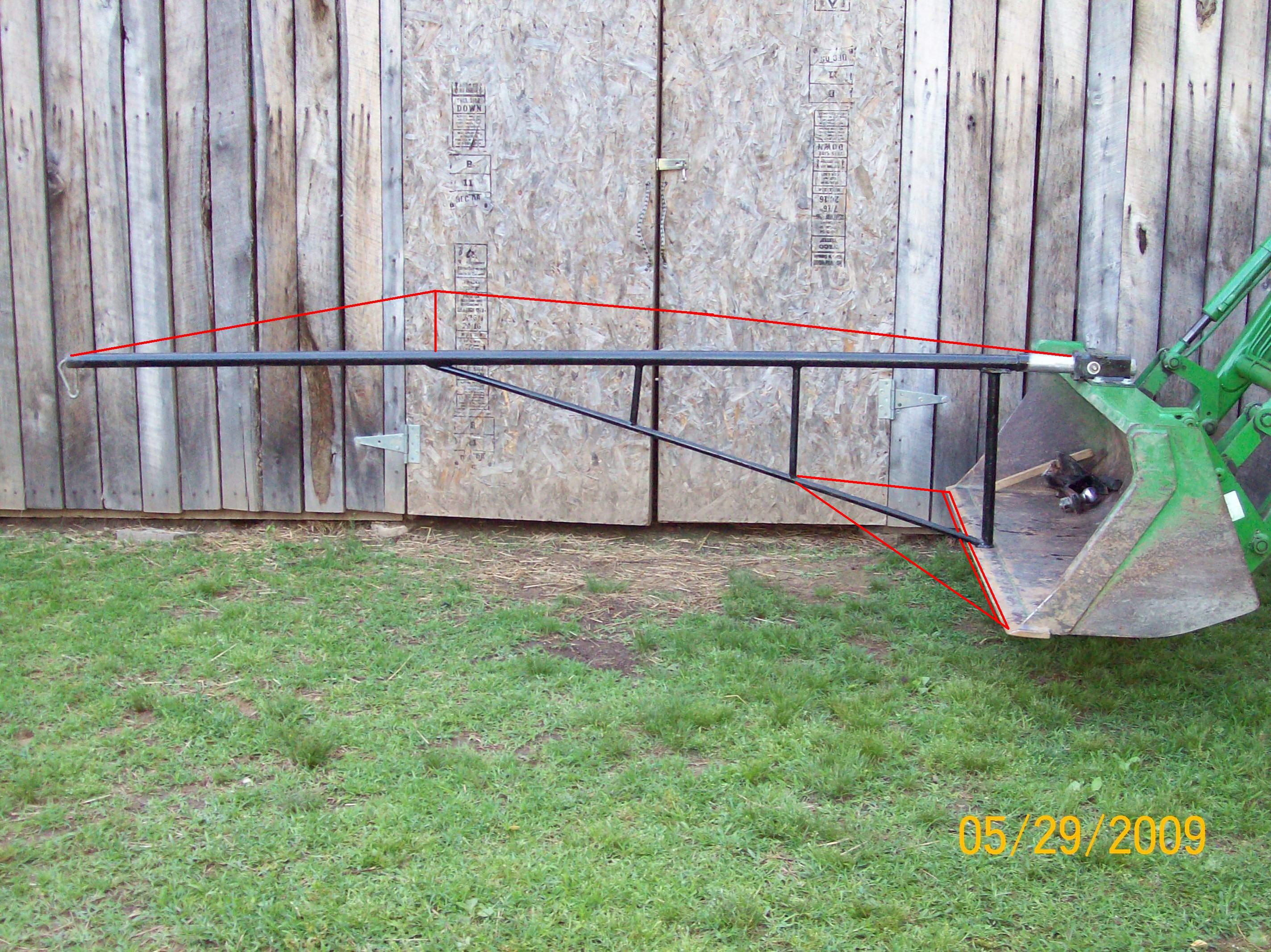

I also built this boom-pole to use when I put up rafters and it's very handy for that.... Mine is 10ft. long and the reason I built it that long was for rafters.... I have used it for other jobs also.
Mine is made out of pipe, and I put a smaller pipe inside the full length of the larger pipe to make it stronger... I also put a short piece of exhaust pipe on the end to make it fit tighter in the hitch, and I used a hammer on the exhaust pipe to make it square.

I like the pole. The only problem I have had with using pipe in this manor is how easily it bends. Add some pieces (in red in the image) to keep it from bending and from swaying from side to side. I am sure yours works great, but when ever I build something like this, I always push it harder than I probably should. Nice job on your project!
Yea that would make it a lot stronger.... I'll do that when I get time.
I also work something harder that I build... It did have a plate on the bottom that set on the bucket, but I already tore that off.
When I first made it I only had one piece of pipe.. I used it and it would bend some so I put another piece of pipe inside... I had to use a sledge hammer to get it in.. It weighs about 70lbs. :rolleyes:
It likes about a 1/2-inch being a solid piece.... But it will still bend some, and when I use it I put ratchet straps on the pipe & go behind the bucket.
Thanks for the suggestion!
   / Bolt on Bucket Hook and Receiver mount for JD2520 #18
Ditto to BX24! 1/2" rebar would do, I believe. But I'd use a couple 1/4" plate triangles, at the top, welded on either side of the pipe, and canted toward the center for the tension 'peak'. Definately need something on the bottom as he said, to keep it from 'kickin' out either side. I like it!

Won't that shiny paint get all scuffed when you slide a receiver into it?
