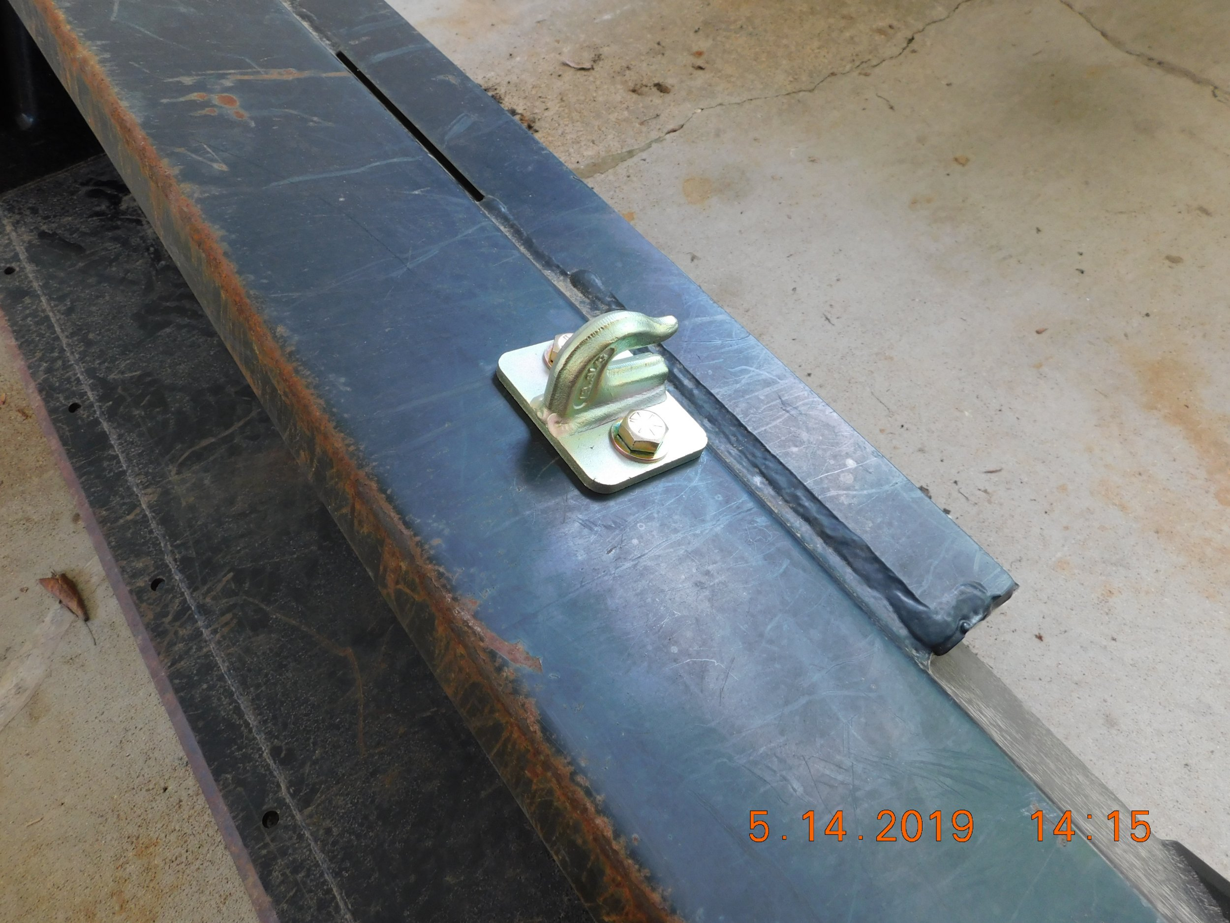

So I bought the hooks from KennyD in 2014, but the Kioti bucket has a square tube along the front for added strength. Some LS buckets have this too. Which means I need 3 1/2 inch bolts instead of the 1 1/2 inch bolts provided. And I finally remembered I needed them WHILE I WAS AT THE STORE! (hey, are you laughing?) 😆
Here are all the parts for 1 hook, including the new longer bolts:

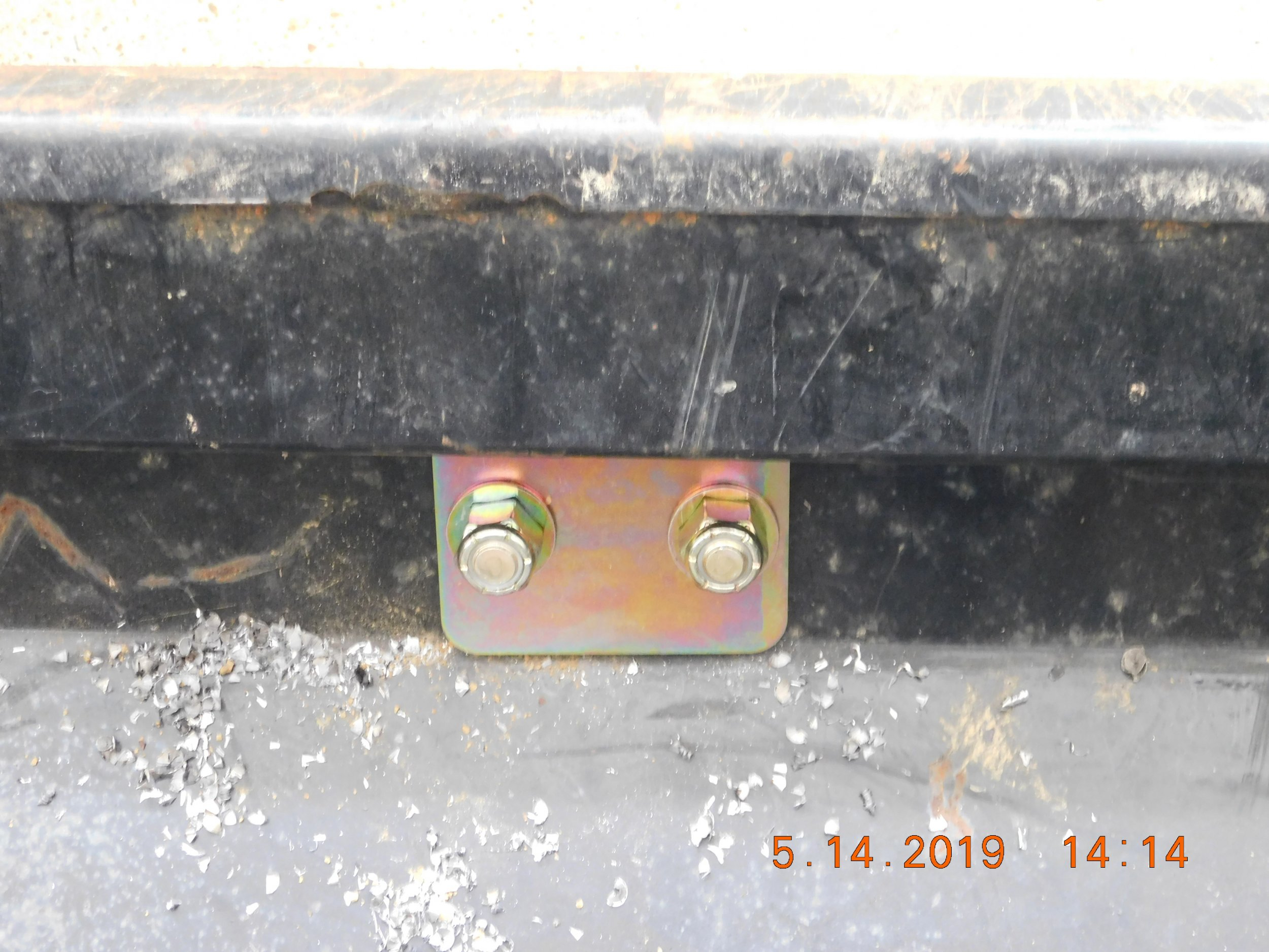

Being as it is mounting through a tube, there could be some concern over deformation when torqueing the bolts. But check that wall thickness in the drilled hole... two layers on top of the bucket, though only 1 layer on the bottom.
After drilling the holes all the way through the tube I used a bigger bit to remove burrs:
Then checking for correct fit (nothing tightened yet):
In the above pic you can see how the bucket wraps around the tube, below you can see that the wraparound is only about a half inch on the underside. I set my hooks back from the bucket edge to avoid any uneven surfaces for the washers.
Front of bucket is at top of photo, bolts go through just the tube itself, set back from the overlap:
Now I just need to find something to chain down!
Last, some gratuitous advertising 'cause I'm pleased with the results:

My Kioti RX-7320 has a square tube reinforcement integrally welded to the top of the bucket. If I was to add the hoods I would need to place the bolt-ons approx. 3.5" back from the front lip - as I'm trying to show on the attached images. Not sure how the chain would work having to go over that leading 3.5" inch bucket edge. May be just fine other than sliding back-and-forth over the front lip as well as keeping the bucket curled horizontal the the lifted object.
