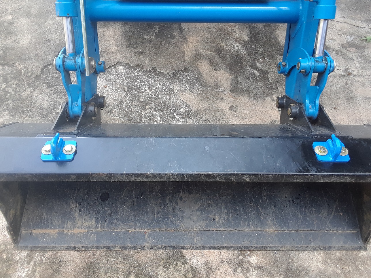

I bought two blem hooks from Ken's Bolt On Hooks. Ordered on line Sunday. Delivered early this morning in the mail. Fast shipping! They were only barely blemished. I painted them this morning to match my tractor, and put them on this afternoon. Picture. 20180718_151716.jpg

If I was to put a D-Ring in the center, between the hooks, so I can use rope also, how much should I limit the lifts to? Would 300 pounds be too much? There is a 1.5 inch square tube welded into the top front edge of the 50.5" bucket.

Don’t know, I have a construction attachment 60inch medium duty bucket and have lifted 650 lbs with the chain across both hooks many times with no issues, you’re bucket looks very similar to mine.

40,000 pound D rings are like $7 on amazon. Why screw around with a 300 pound d ring that isn’t big enough to fit a chain hook through? I make max loader capacity lifts in the center of my bucket all the time, but it’s a heavier duty bucket. I think I would throw some angle iron across that bucket first.

He's asking about LIFTING 300lbs, not using a 300lb capacity D-Ring.

I weigh 300 lbs. I wouldn’t hesitate to stand (or jump up an down) on the center of that bucket. At long as the ring is properly attached, it will be fine.

Which is why I put a hook in the center.

I have a receiver in the middle of my bucket and two bolt on hooks inline with the loader arms. I put a 1/4" x 4" backing plate all the way across inside the bucket. All six bolts go thru this plate to reinforce the top of the bucket. My little tractor only has an 1100 pound lift capacity but better safe than sorry.
