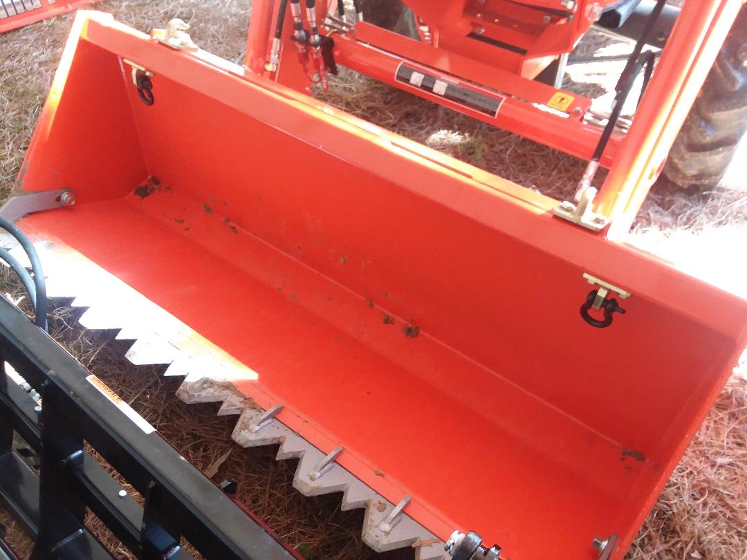

Bolt on hooks
/ Bolt on hooks #41
A good quality battery impact with a quality step bit does wonders..
/ Bolt on hooks #42
Ummm, love the smell of Tap Magic, takes me back to my precision sheetmetal days in my youth. That stuff is awesome, especially when drilling and machining aluminum.
But the advice about starting with a small pilot hole is absolutely spot on.
Also I used a cheap HF step drill in the sides of my loader when Installed my Piranha tooth bar..took at most 2 minutes per side.
/ Bolt on hooks #43
Pilot holes and good quality bits.
With Dormer drill bits you can't go wrong and a decent lubricant AKA, cutting oil.
Also slow speed and never let the drill bit get hot.
On the other hand I have purchased some 'el cheepo' bits that have really surprise me as to their capability.
Often their downfall is that they are simply too brittle but they do cut well.
When it comes to metal drilling SLOW speed is your friend. (and cutting oil)
Also I know how to sharpen my bits and that helps.

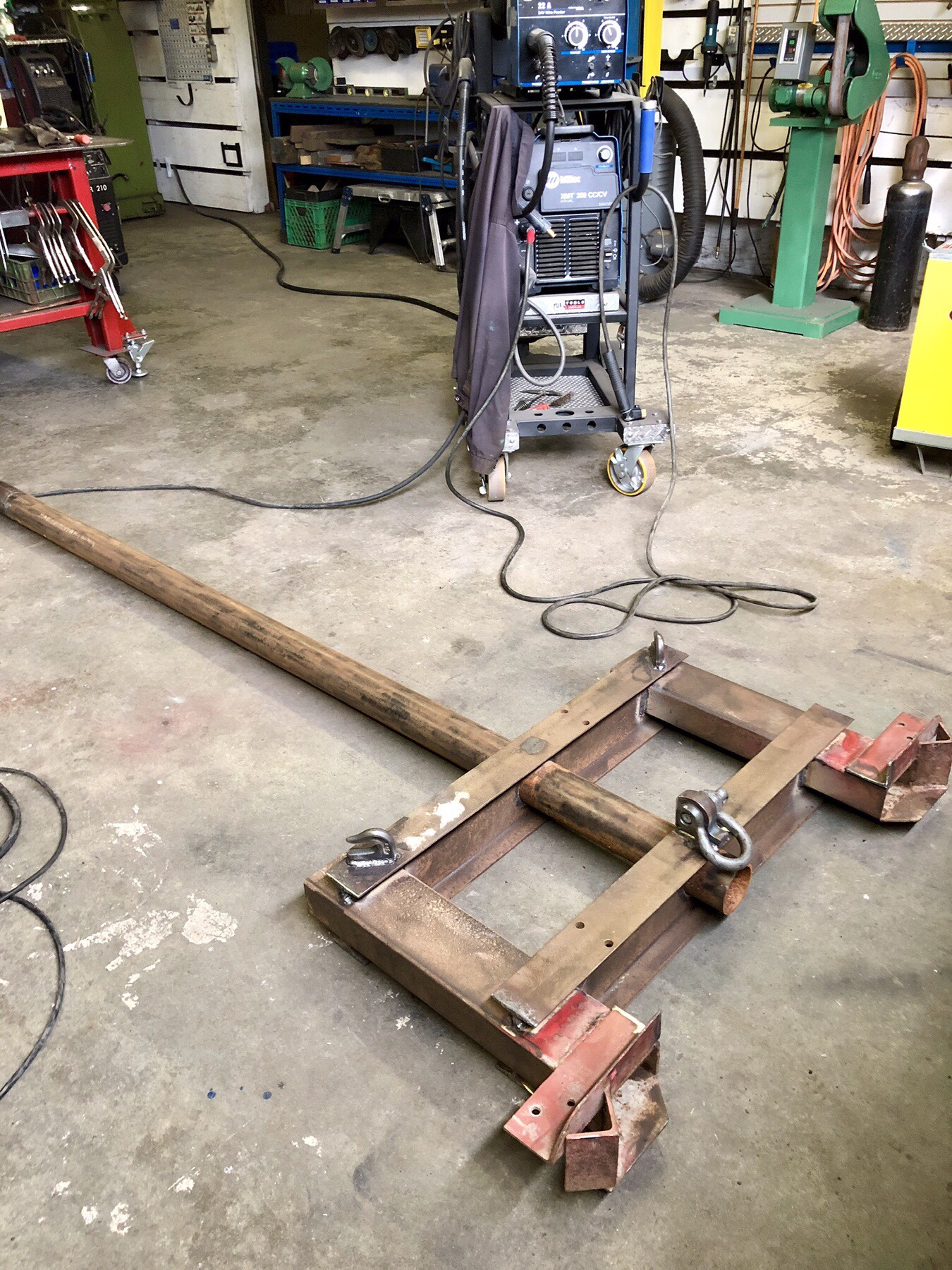

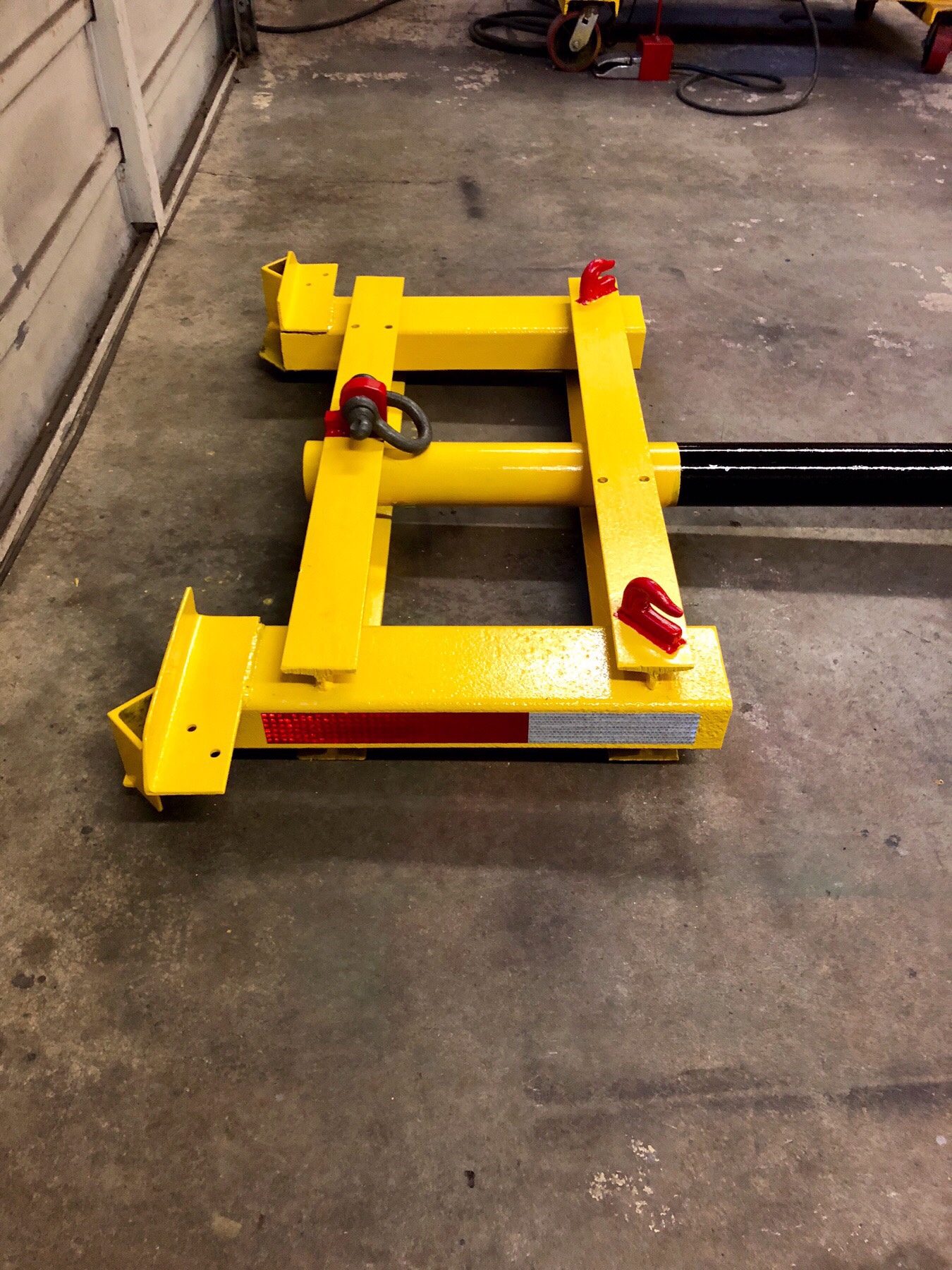

I would agree with having hooks AND a provision for a shackle if possible. I usually weld on mine.

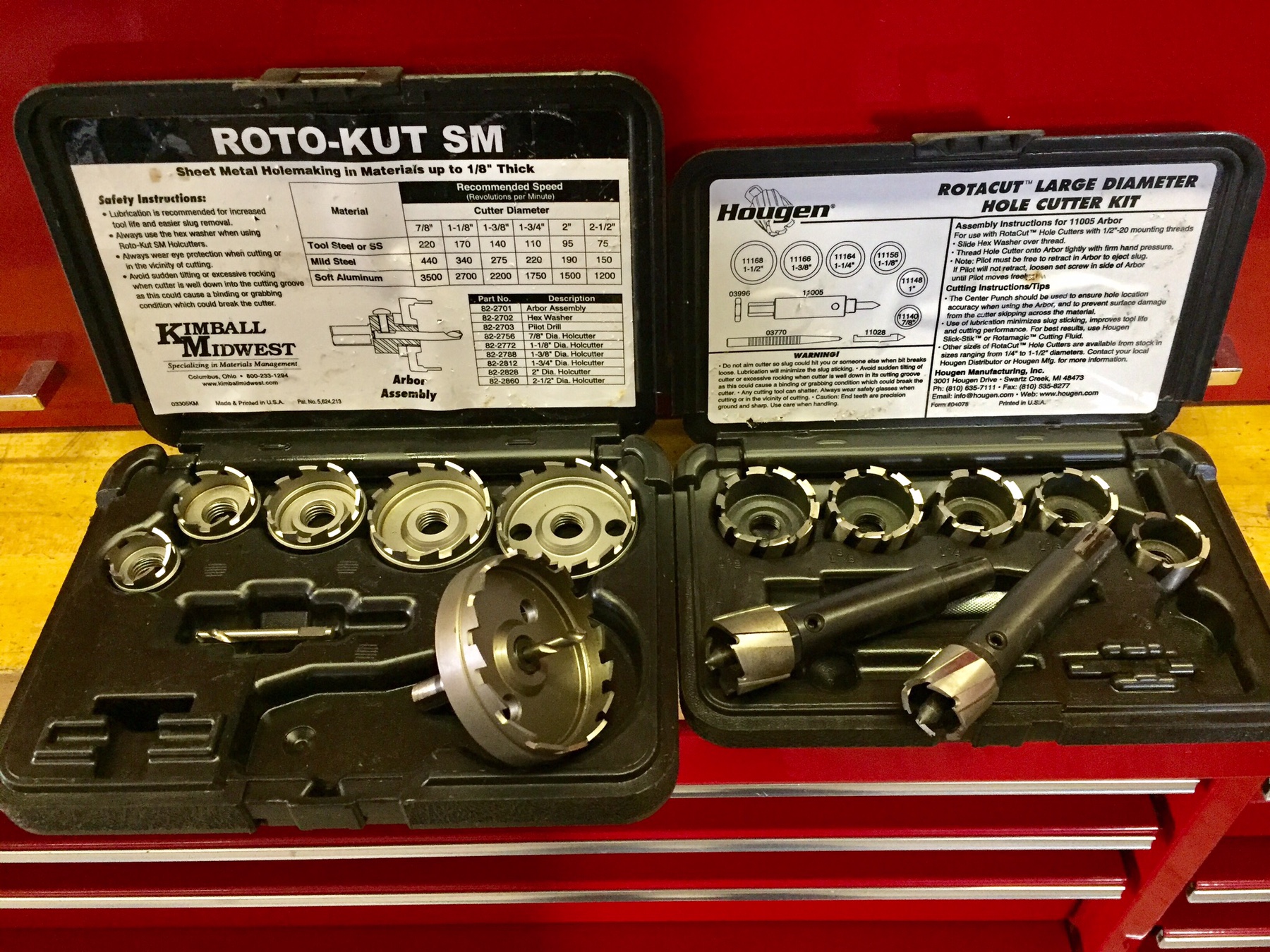

If drilling holes for 3pt pins simply use a hole saw, they are made down to 9/16" and work wonders, when I lowered the pins on my brush hog I used a hole saw and was done in a couple minutes...
All this talk makes me want to rework my bucket...
/ Bolt on hooks #48
Yup hole saws work great as well..
/ Bolt on hooks #49
Or sheet metal cutters.
/ Bolt on hooks #54
But how much even in Canadian dollars...
Dale
It looks like the two sets I have pictured would be about $350usd
My set (not in photo)that goes up to 1”d is only $80 usd on Amazon. For that set I recommend buying extra arbors so that you have one for each cutter without having to change.
