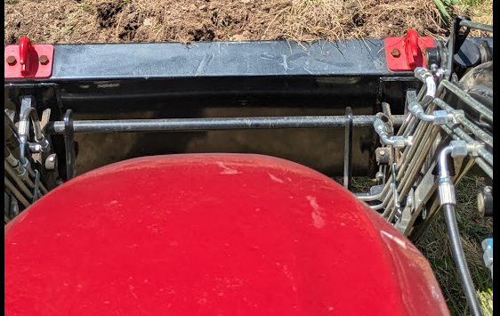

I put mine over where the bucket attaches because it was reinforced there on the backside of the bucket, you can see in this pic. I love having them on. I believe it is much safer using the hooks when using a chain to move heavy implements etc. because of reduced chance of the chain slipping.
I have another set I need to get on my other tractor. I'll probably get some stainless bolts and replace them as they are rusting.

I think grade 8 bolts have greater strength than stainless and grade 8 won’t rust either.
/ Bucket hooks #71
Grade 8 is significantly stronger than stainless. It will rust, but it would have to rust for a very long time, like decades or longer, to get down to the strength of an equivalent sized stainless bolt.
Yes. Even 18-8 stainless is only 70 ksi tensile strength, and something like 30 ksi yield strength. Most other stainless alloys are even worse than that. Totally fine, if sufficiently sized, do your fastener math accordingly.
I'd suspect grade 5 probably hits the sweet spot, for mounting bucket hooks. It has some yield, where grade 8 can just snap under shock loading. And I'd also bet grade 5 will exceed the strength of all the materials around it, namely your bucket lip, meaning anything with higher tensile strength is unnecessary overkill.
