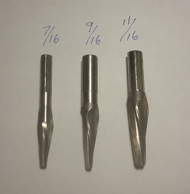

A company I worked for years ago was having a real problem with employees going through large drill bits from improper use and also injures (wrenched wrists) from large diameter drill bits grabbing materials and stop spinning while drill motor wanted to keep going.....They went to this type of tapered reamer shown below, they are pass through reamers, if not abused cut wonderfully and do not have tenancy to grab material and bind up.... Real requirement is you drill large enough pilot hole to accept reamer tip... IF you can find them and get them you will never want to use large diameter twist drill again...
Also for really big work (3PH hitch pins and such), look towards a "bridge" or "car" reamer, yes expensive but worth it if you have lots of large holes to drill........

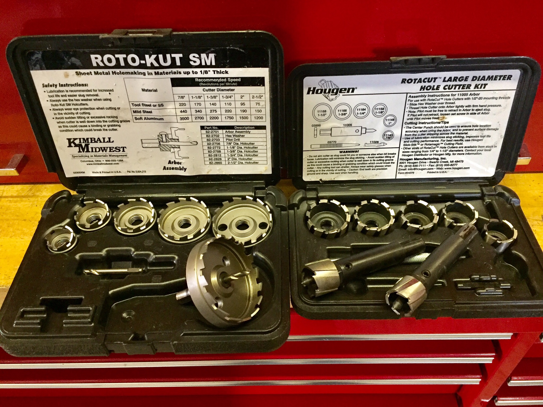

If drilling holes for 3pt pins simply use a hole saw, they are made down to 9/16" and work wonders, when I lowered the pins on my brush hog I used a hole saw and was done in a couple minutes...
All this talk makes me want to rework my bucket...
   / Bolt on hooks #48
Yup hole saws work great as well..
   / Bolt on hooks #49
Or sheet metal cutters.
