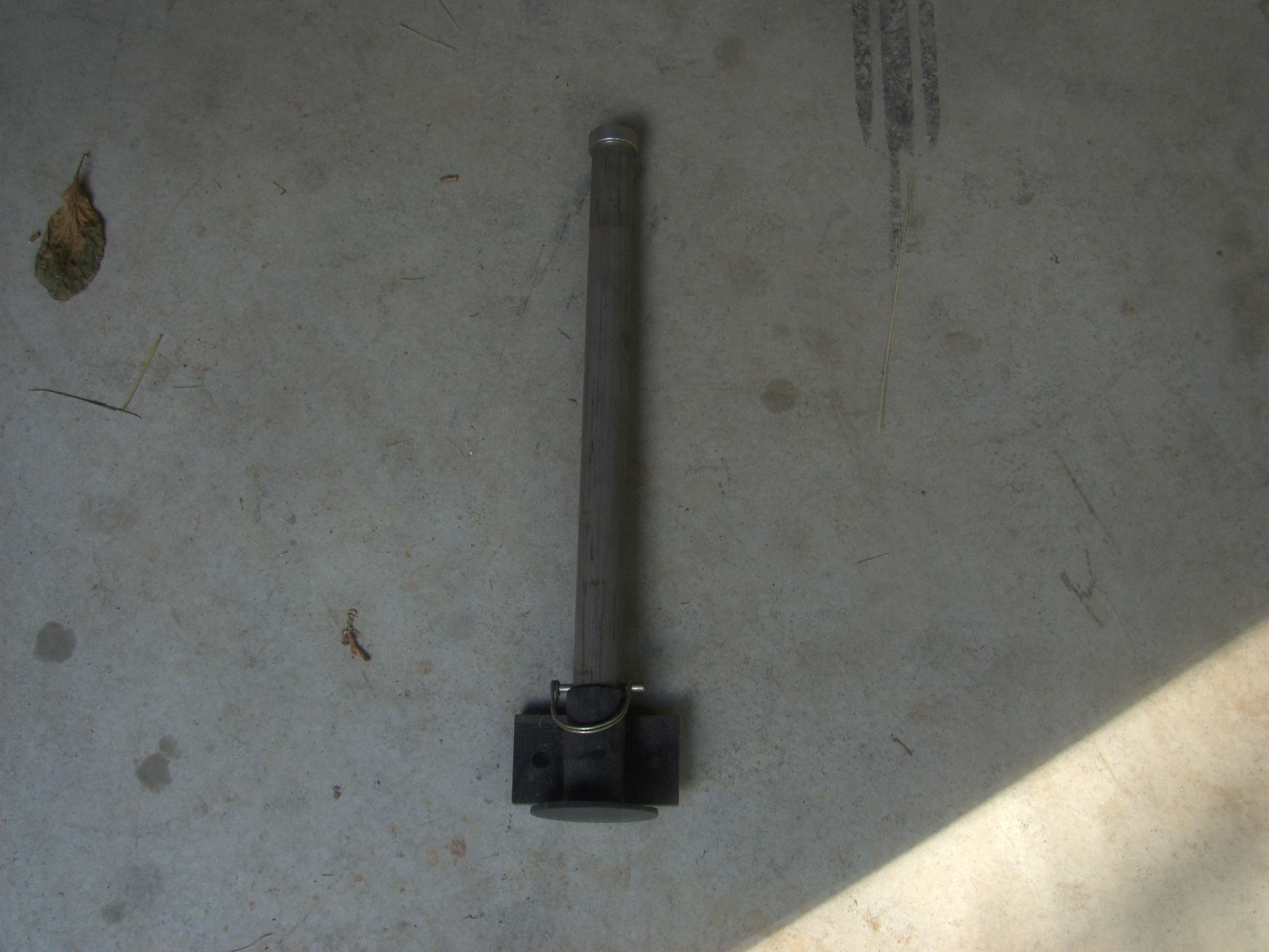

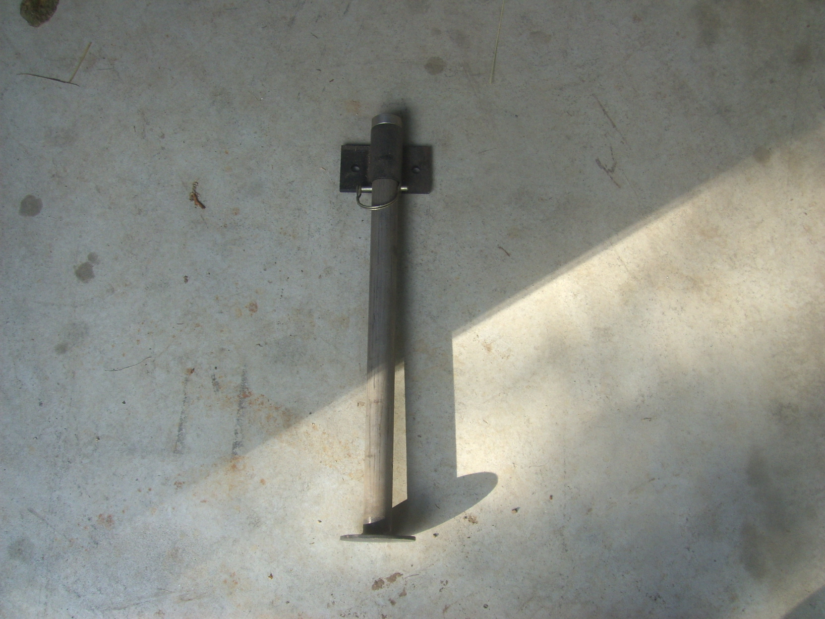

Kennyd, There might just be a market for bolt on stands. Pictures are some I made. Pipe has a ring welded on the top so it can't escape. Pipe has two holes drilled in it, (none in the mount bracket, less holes to line up) one below the bracket to hold the implement up, and another when raised above the bracket to hold the pipe up. Only thing to lose is the locking pin and it could be tethered.
Thanks for the idea Z, but with all the variables like lengths and hole spacing I'm just not sure it would worth the effort. Add to the I can barley keep up with the Bolt-On-Grab-Hook sales as it is now! Whooda thunk it eh?

If hole spacing is a problem just make a wing-nut. Weld the nut to the outer pipe after you drill the hole, weld a bolt to a piece of 1/4" round rod and bam...... infinitely adjustable
